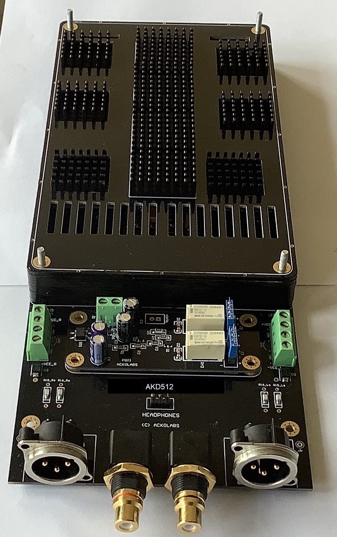

It has been a long while but here is the final build of this DSD DAC 🙂
More information here:AckoDAC - AKD512 DSD DAC
Just responding to some queries:
There is USB bridge and LAN integrated already, so pretty much ready to connect and play. Also these interfaces are not based on RPi or SBC modules like what others do but built ground up from dedicated real-time embedded processors - and all linear power for top quality audio. So, no Linux boxes, drivers or OS updates required, no storage disks or memory cards to corrupt!
Also LAN interface has fibre options for absolute isolation
USB goes up to DSD512, LAN up to DSD256 (native), hoping to push it up to DSD512 and yes, includes isolation and reclocking to femto clock timings 🙂

Yes, it has been quite difficult to get noise below acceptable levels but that is a success now. Someone has asked to provide fft noise plots but AP machines are quite an investment and impressive figures does not necessarily compare with what we really hear. So I went for Audeze LCDx headphones for all listening tests. Now, I can’t believe my ears 🙂
Cheers Ray, nice to hear from you again.
Any measurement result?
I saw -120dB THD+N specification from your site.google, but no detail informations.
