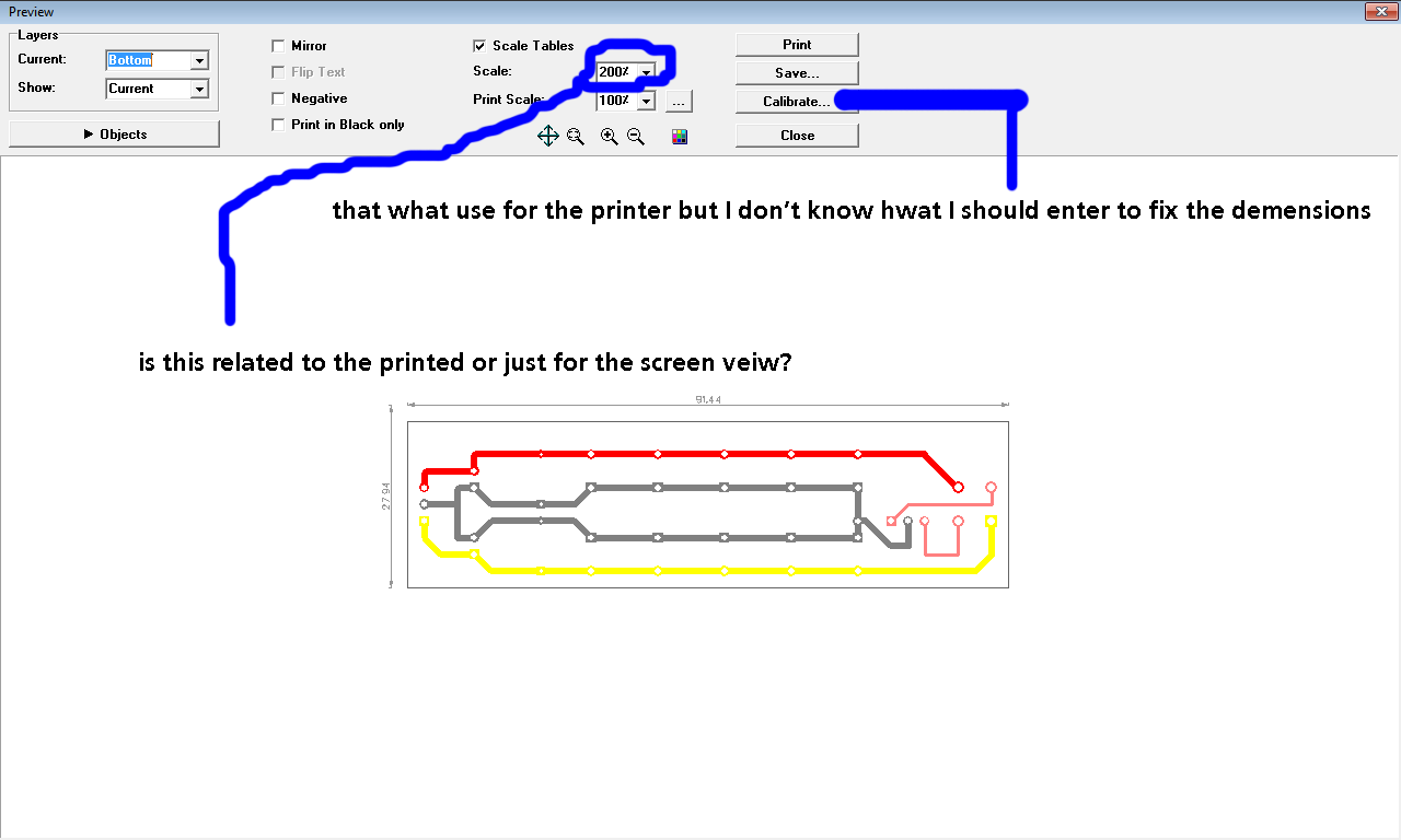

I try diptrace as free version to design PCB for power supply schematic its very good and simple but I have problem when I try to print the PCB with it the program doesn't give the same dimension for the PCB how could I solve this one please?
Like this,

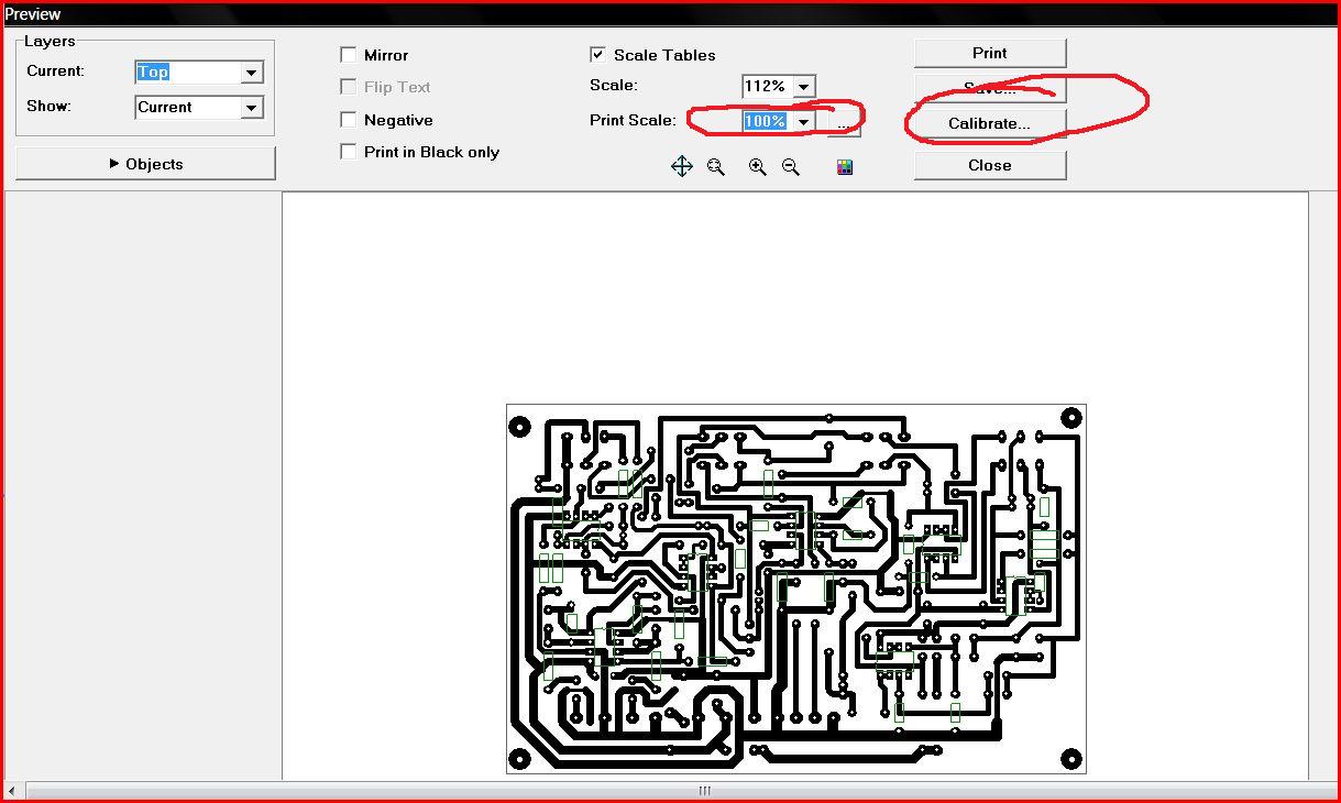

I use it as you explain as I hope exactly anyway this is the picture that for the board without components inside it, when I try to print it the printer give me wrong dimensions do you suggest me to ask supported forum for the software or the problem with sitting I do as the picture?🙁

Top one (scale) is just for the on screen view as far as I know. You want to alter the "print scale" from the drop down menu. You'll have to try it. Just print them as drafts so as not to waste ink.
Best way to set it all is create a PCB using DIP IC's and print it out. That's a critical test.
Are you making the boards using an inkjet printer and UV light box ? You can achieve excellent results that way if you set the print options (on the printer) to give an intense image on a transparancy.

the dimensions should be 91.44mm 27.94mm, but after I measure it on paper its 92mm 26mm
do you think I should use the Calibration option to make the printed paper with same dimension?
Note: the printer I use is Laser Canon 2900LPB and I don't use the driver option for anything I just use the default size from the program itself.

I would double check whether windows is doing any scaling. Looking at your drawing the endpoints for the 27.94 dimension are not the same width as the PCB, in fact the top end point looks 1.94mm wider than the board. So I would say the print out is pretty much spot on.
I would also avoid using 2 decimal places with PCB's for dimensions, one will suffice, and better still use maximum of 0.5mm steps. Standard PCB manufacturing tolerance is +/- 0.4mm
