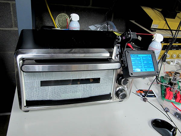

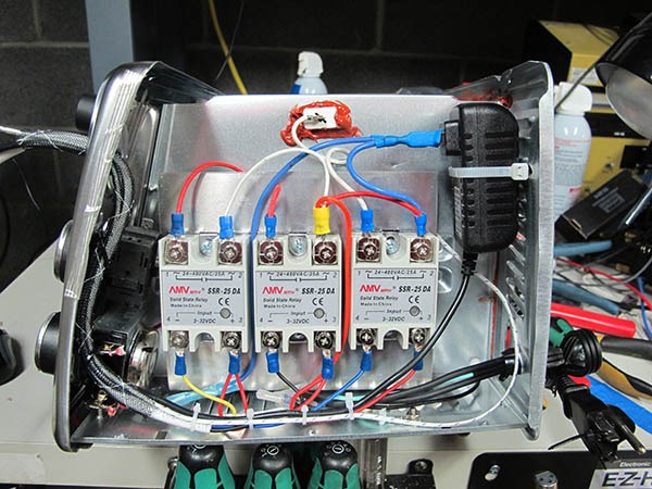

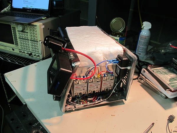

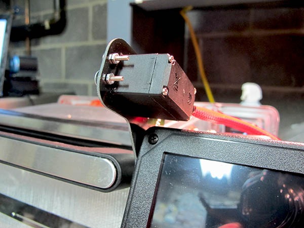

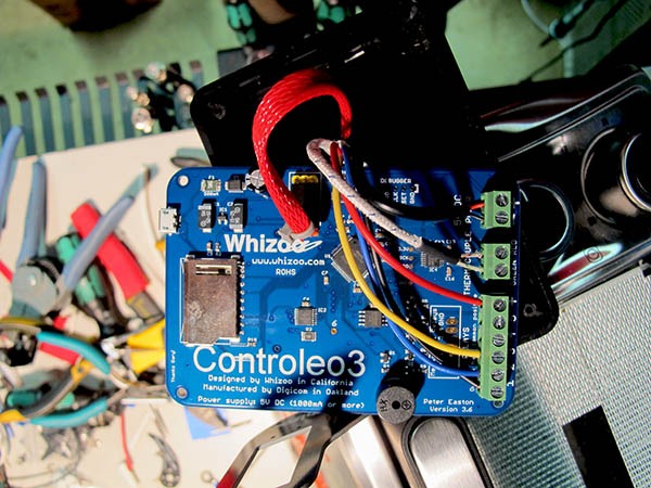

Here is my Black and Decker toaster oven with the Controleo MCU. It has a learning mode which is really neat:
