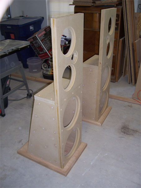

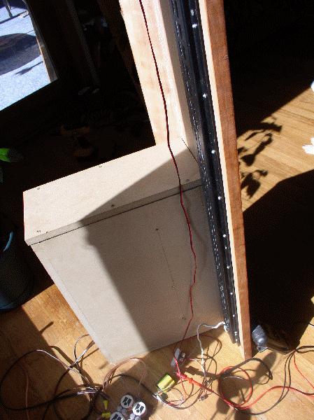

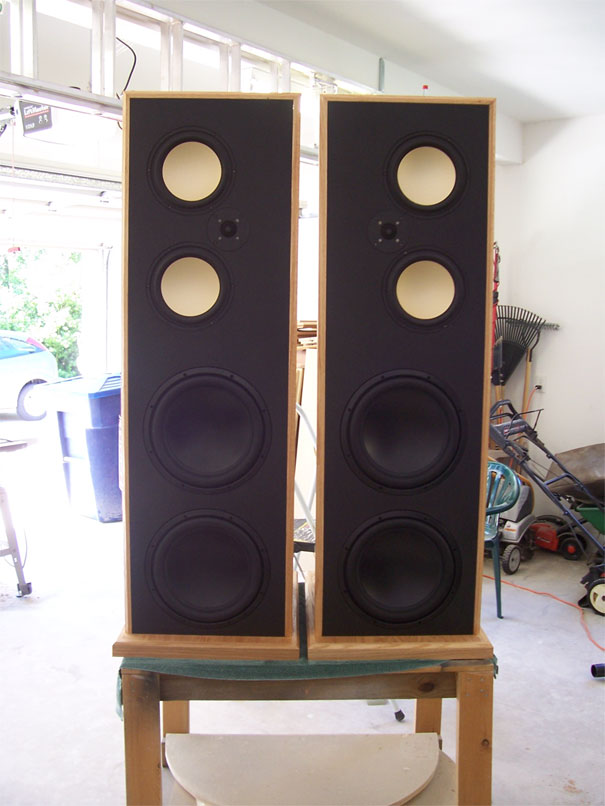

Hi Nigel...
As you can see, I left plenty of baffle space next to the RD 75's, as I was considering a tweeter line rather than the psuedo-point source setup. After setting up with the peerless domes, which were initially both firing froward, I noticed alot of combing especially within 3-4 feet of the systems. By reversing the top tweeter and running inverted phase, much of the vertical combing dissapeared.
The peerless tweeters have a higher sensitivity than the BG's so I was able to pad them down from overwhelmingly bright to pretty much integrated into the overall sound, especially at the 15' listening location. There is some side/horizontal lobing/combing between them and the BG's, but it blends quickly as you move away from the source.
Overall, they simply fill the ~18,000 sq. ft. space with prodigious high quality sound. I haven't ruled out a line array tweeter setup, but they sound so good now, I kinda hate treating them like mules and chopping / hacking the cherry baffles for diminishing returns, but then, it's the endless pursuit of perfection that's my downfall.. 😉

Hi Nigel...
The combing problem only occurred with the two dome tweeters firing forward... If I were running more than one fwd. firing, I'd space them much closer together and maybe cross them higher as well. The technics planar doesn't seem to lobe much with the single fwd. tweeter, perhaps because of its limited vertical dispersion.
I would think 6-8 feet would be an adequate listening distance...with mine, you can stand right next to one speaker and here the other quite clearly, unlike my experience with standard boxes.
here's the mid-woofer I used (4 of them)... had about the smoothest listed response over the range I wanted I could find for the price...
http://www.bmm-electronics.com/Product.asp?Product_ID=3347
They actually sound fine with the BG's... the speakers pretty much dissapears with high quality recordings... has alot of what I call jump factor, as in someone is singing/playing in the room near you... not a stereo... can be startling with female singers like Diane Krall or
Dianne Shuur, etc...
I may add two more mid woofers per side to increase the power handling, as the BG's line source behavior does take hold in a room this large... the lower bass sometimes could use alittle more oomph! volume wise, but not speed wise... these mid woofs seem quite tight...
I'm trying to further improve the low bass reesponse in this room as it has a large mode @ ~30 hz that's been hard to tame (not a dipole problem, but part of the overall install.)
Sub-woofer placement has helped... I may add another one to further tame the major room modes...
hope this helps...
