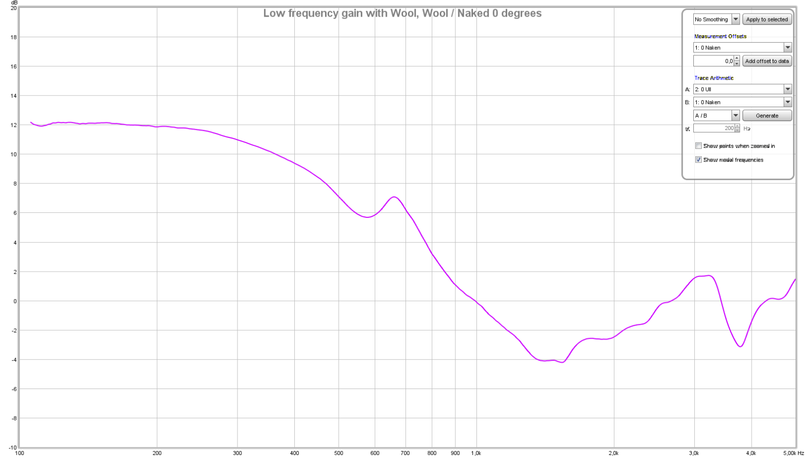

Here we have Naked 0 measurement / Wool 0 measurement which if I'm not mistaken shows the low frequency gain, for science! 😉
It does seem to correlate with the invisible dipole peak at about 233 hz since there is no significant additional gain below that.
Kinda cool to trade low frequency gain for dipole peak gain. After I've got some food in my stomach I'll probably start building that hard baffle.

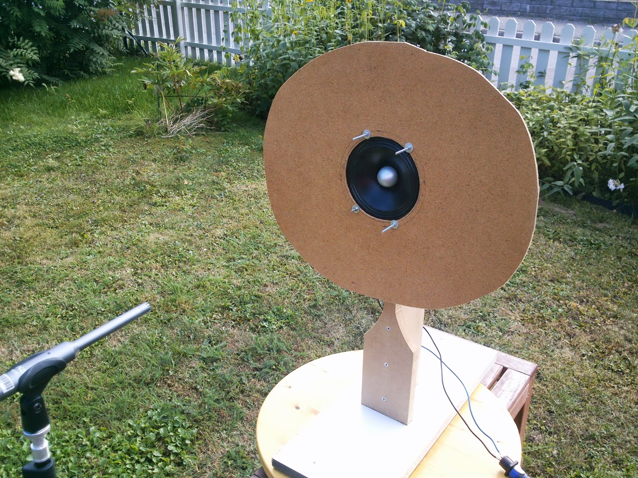

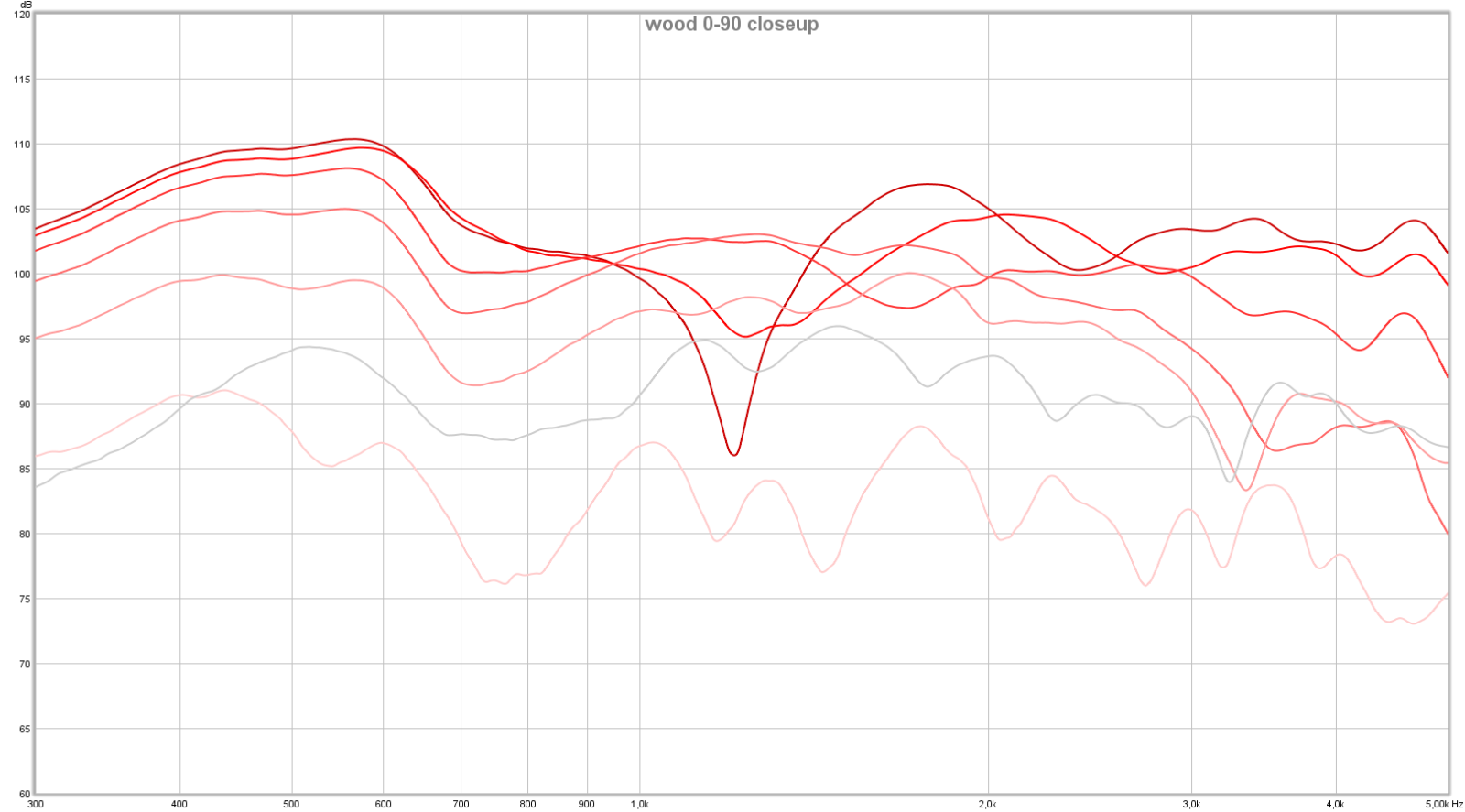

You asked and so here it is!
And brace yourselves, it is ugly! 😉

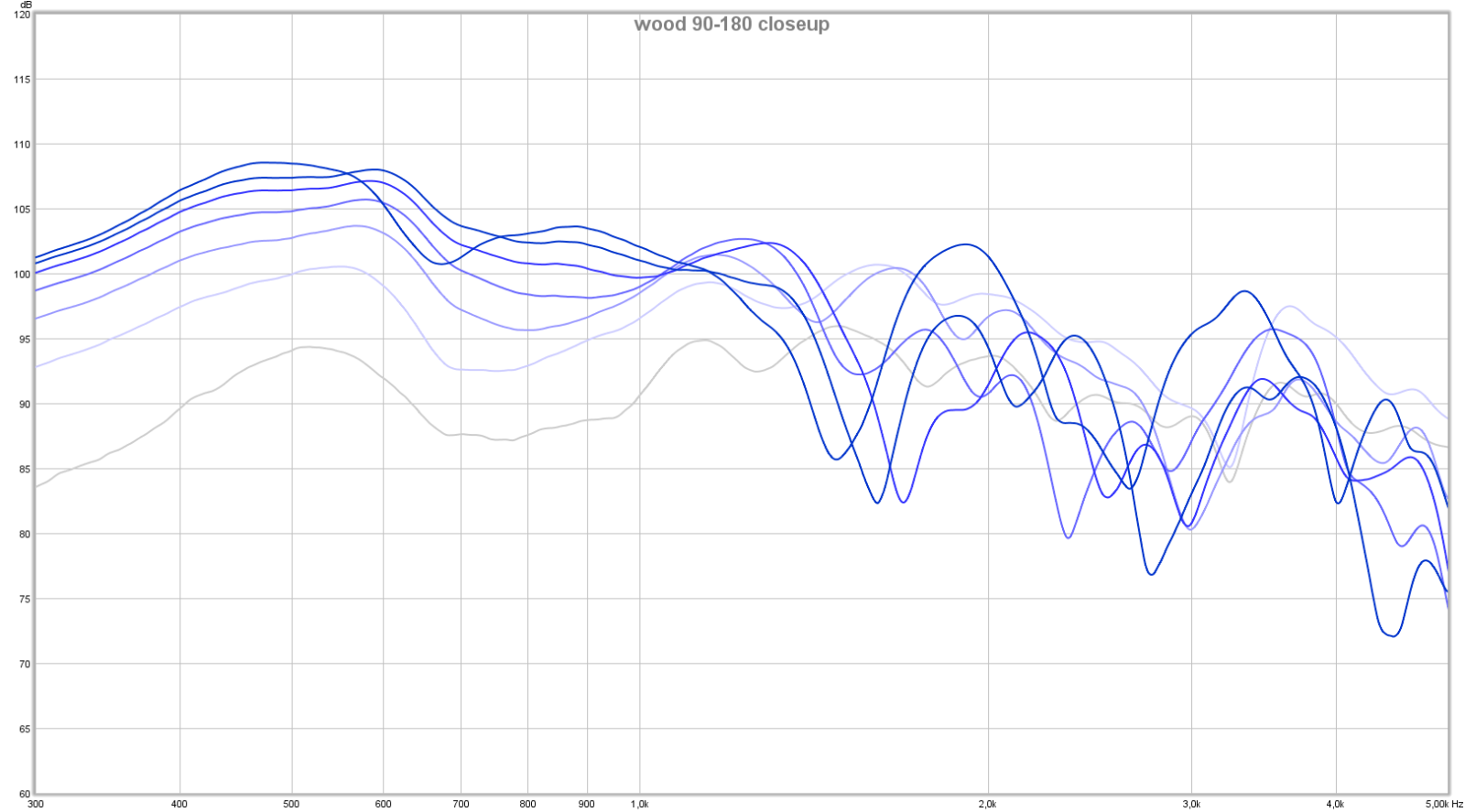

Measures as expected, kinda nice up until about 700 hz and then it falls apart, a far cry from the smoothness of the wool baffle. The rear dispersion even falls apart before that in the on axis.
I think I measured from the same distance and if so it seems that pure wood is a bit more efficient down low, which isn't that unexpected. Would be interesting to know if having a thicker wool baffle would lessen this advantage too =)
All in all I'd say it is likely that wool is a very good material to make dipole baffles out of.
I think wool baffle is primarily an advantage of 300 and upwards since the lower frequencies low through damping too easily. It does simplify and reduce excursion needs on the the drivers at ~ 300 and upwards massively though. An interesting idea I want to test is to make a H-frame for the 100-300 woofer out of wool, if I guess correctly I could make it bigger than I could out of wood to compensate for the efficiency loss and say I use twice the layers of wool... if it worked then I could probably simplify my crossovers and stick with 12 dB / oct instead of 24 dB which would be nice.
Lastly, a minor but also interesting detail is that baffle vibrations become a moot point with a wool baffle =)

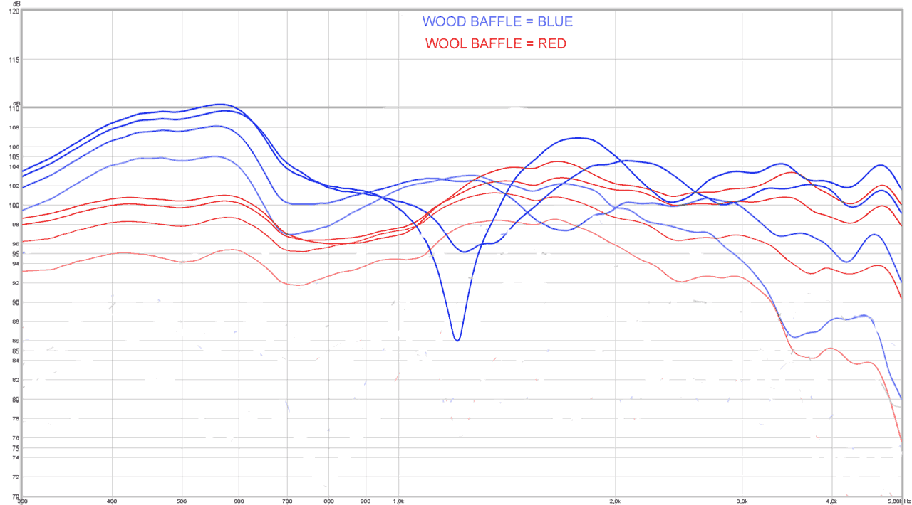

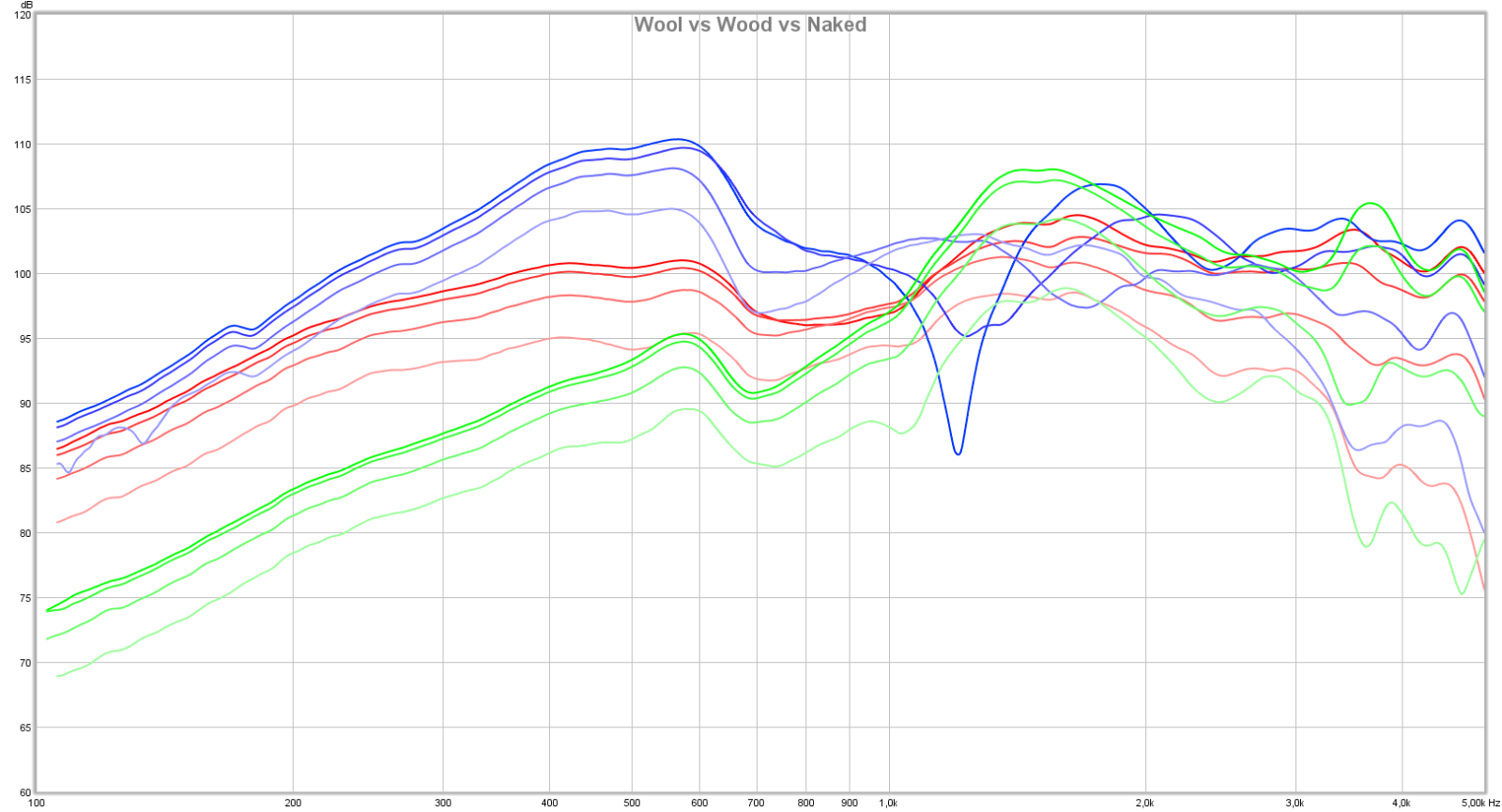

I've done an overlay of wood vs wool with just 4 traces each for clarity. The graphs have been resized to match on the X and Y axis. It seems that the wool does not have the low end gain that wood has, but wool has a much flatter response.
What do you think?
What do you think?
Great work, thanks!
What do you think?
( blue is wood, red is wool, green is naked )
Seems about right, an interesting thing though is that it is only over 300 that there is a significant gain difference, if we watch from 100 it is almost the same with wool and wood. Especially when you put the naked baffle into perspective.

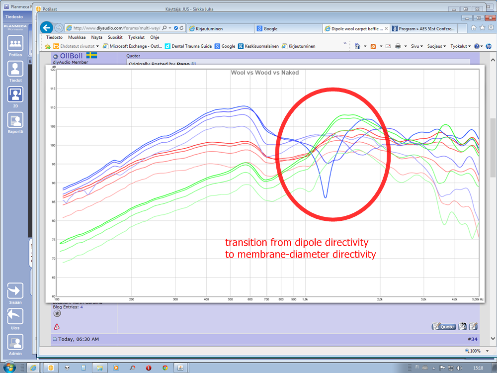

To me these measurements prove that with open baffles we can't overcome the transition zone. In the range below dipole null, dipole function determins directivity. At even higher frequencies driver-membrane diameter determines dipectivity. Between these we have the uncomfrortable transition zone where both response and directivity wobble and wiggle.
