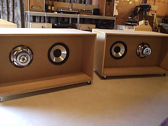

- and the enclosed dipoles are 3db down from 200 at 40 cycles (EVM15B, front driver tuned to 40 Hz, EVM15L rear with 2 variovents) with no eq. To "fine tune" the system to my room I simply use a pair of Paradigm X30's and adjust the phase relationship between the front and back drivers.
[/URL]
(JPK) Well, that's just not a dipole. I do something similar with my CRAW design which uses two woofers in separate chambers. When set up as a cardioid, the level of the rear driver can be adjusted so that the null behind the system occurs at a specific distance. However, this has a significant effect on the on axis response as well, and isn't a true cardioid. See http://www.musicanddesign.com/craw.html about 1/2 way down the page. As soon as the front and rear responses have different amplitude and the phase difference is other than 180 degrees you have something other than a dipole and it may well perform better than a dipole in a given room. A dipole, for example, has no room gain. A true cardioid on the other hand has room gain similar to a sealed box system. So it is quite understandable why your system would perform differently than a OB dipole, or any configuration of a dipole, H, W, two identical sealed box system separated by d and 180 out of phase; it's not a dipole. And if you find your setup to perform better than a dipole in your room that is an equally legitimate evaluation.
This is just your opinion - and my experiance with linkwitz OB bass tells me it can be bettered in several ways - 1) a well designed/integrated horn sytem, 2) a well designed/implemented Karlson Koupler, 3) this current apparatus ( I believe I have been corrected above - it's a "quasi-dipole/ quasi-cardiod") integrated properly. Try M&k, Meyers, Legacy, Wisdom Audio, ect........
Have you built a good bass horn? Have you built a good Karlson Koupler? Have you built a quasi/dipole/cardiod? I have loaded linkwitz boxes with superior drivers (15" JBL 2235's) and they did not 'work' for me. If it does not work to my satisfaction it is wrong.
Energy released through the box? One bass cabinet is almost 5" thick and braced, the other operates with another driver in push pull and is sand filled.
20 Hz or deep bass? Well I use three horns (and three channels!) for that as seen in these pictures - the linkwitz boxes are toys in the bottom octaves compared to this - LOL

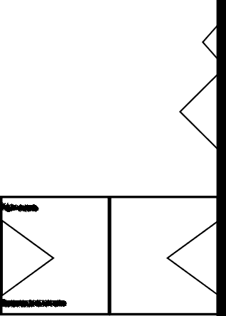

Nuuk said:I've read and re-read this thread but am still not sure what Magnetar is actually describing.
Is the following correct?
I am confused too? How can we go build one and report back if we do not know what exactly to build? Or build something and report back with inaccurate results because we have built something totally different.. rather than what he has in mind?
May be his tune boxes are bass reflect boxes and the front facing box is a sealed box?
If you want I'll take a picture - do you have place for me to upload it?
Please send me a PM with it as attachments. It should not take too long for me to download it. Thanks...
Butcher? Those look sweet!
My daughter has the digital camera and is out of town for the weekend - I'll snap the speakers when she returns.

- Dipole with 2 10" drivers
