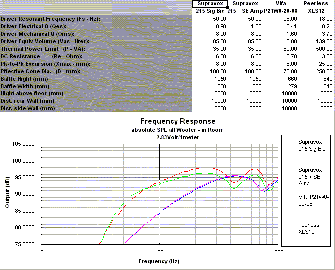

Spreadsheet done
Konnichiwa,
I have sat down and entered the "numbers" into one of my spreadsheets. This seems to be pretty close first to the numbers from the German report which COMPARED cone dipoles to DML.
Also, when simulating the Phoenix main panel with Vifa P21-W0-20-08 (a woofer unsiuted for use in dipoles, UNLESS heavily equalised) I come within 2 - 3db of the Figures measured by SL via MLSSA, I think both my throth and peaks are slightly out, maybe a result from not accounting for the stubby wings.
Anyway, I'll consider the simulation as "good enough ballpark" for a basic "feasibility study" thing, which is all any of my Q&D Spreadsheets ever where intended for.
Here attached the simulation result for different baffles and drivers. The spreadsheet even zipped is still nearly 1MB, so I'll need a moderator to help upload it.
Sayonara

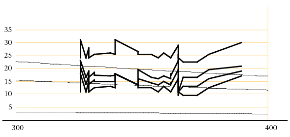

The fix for my charts is in the works, Throsten has mailed me his XL workshhet, but haven't posted it... but in the mean-time i have plotted the empiral results from one of the links above.
The best correlation with any of the curves is just the width of the baffle (no wings) which drops on top of Linkwitz's curve.
The curves are bottom to top: 1/width vrs cutoff 2/ width + 1 side vrs cutoff 3/ width + sides vrs cutoff 4/ average of width + height.
dave
