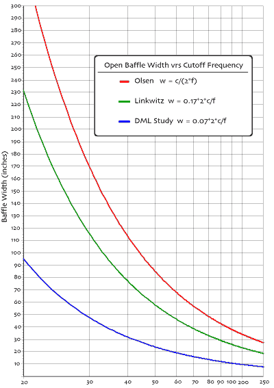

@Kuei Yang Wang
For the -6db point Linkwitz gives the equation
f=0.17*V/D
where V=345m/S and D=W/2.
Your equation looks suspiciously similar, except for 0.07 <> 0.17 (which makes for a huge difference). Could you lead us to the recent german study, you were talking of? I would like to test its credibility.

@Kuei Yang Wang
According to a recent german study the -6db point for a dipole is at 0.07 * Lambda/W, where W is the average width of the baffle, meaning take width plus hight, divide by 2 or more precesiely, measure from driver center to edge into all main (8) directions, add the measurements and divide by 4. Lambda is BTW 345m/S, but that is obvious.
f=0.17*V/D

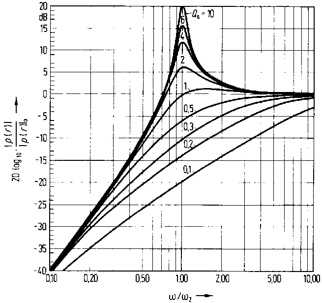

When talking about the implications of different values of Q, I always find this diagram very helpful. It shows graphically, what Kuei Yang Wang talked about in his last reply. I never saw it published on the net – so here we go.
It shows SPL against w/w1, where w/w1 is frequency divided by resonance frequency fs. x=1,00 means fs, x=2,00 is double fs and so on ... The author says, the diagram is valid for infinite baffle as well as for a closed box.
At fs (x=1) a loudspeaker with Q=0,7 may be -4 dB down compared to its midrange SPL. A loudspeaker with Q=0,2 will be -14 dB down at its fs.
If we take fs=50 Hz and look at the SPL at 200 Hz (x=4), the loudspeaker with Q=0,2 will still be down -4 dB compared to -1 dB of the other LS (Q=0,7).
In my view this diagram is a very strong statement in favor of high Q drivers for dipole implementations.

Re: Re: german study
Konnichiwa,
It came out of thge NXT "soundfield" and evaluated primarily the NXT type "diffuse field dipole" against conventional cone dipoles, but it had loads of data on cone dipoles for comparison. IIRC it was an AES preprint, or if not just some (well researched) marketing document.
Backmans stuff is AES preprint anyway and comes to more or less the same figures.
And yes, Siegfrieds numbers and reality leave some gap.
Sayonara

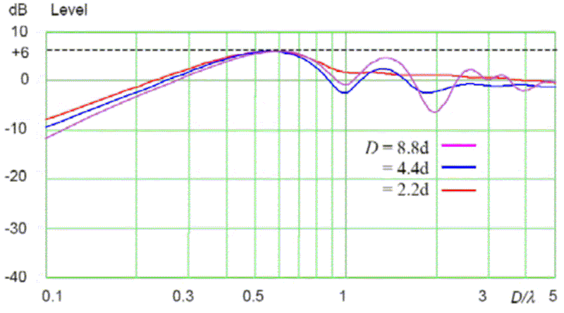

I did find the article I was refering to, at wvier.de:
Theoretical and Practical Aspects for the design of Dipole Speakers
The Article is in German BTW, but I'll abstract the key issues.... First however a little graph, namely the attached one.
What this graph shows is the relation between baffle width compared to the wavelength NORMALISED with curves for baffles with a "width" equal to 2.2, 4.4 and 8.8 times the width of the active radiating area. Note, these are PLAN baffles.
Now the Wavelegth (Lambda) is (IIRC) 345/F. Or expressed differently, 345m = Wavelength * Frequency.
If we go back to our example Golden Ratio 65cm X 105cm Baffle and a radiating diameter of around 18cm we find we have average baffle width (which is how this MUST be calculate) of (65 + 105)/2 cm or 0.85m.
From this we know that Lambda & average baffle width coincide at 405Hz, for simplicity we use 400Hz. So, on the graph we can label "1" as 400Hz and 0.1 as 40Hz. Our ratio between bafflewidth and radiating surface with is around 4.8, so we will use the D=4.4d graph.
From this we first find that for an absolutely flat response to DC driver our -9db point is around 40Hz, that output is around 0db at around 100Hz and that around +6db are reached at around 240Hz. At 400Hz a small dip is observable with a small peak at around 600Hz above which the response flattens out.
In reality the golden ratio spacing of the driver on the baffle will reduce the ripple effect and the peak at 240Hz will be reduced, as well as the degree of rolloff at 40Hz (slightly so).

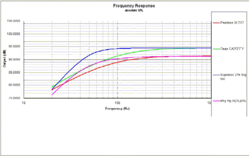

2) This rolloff curve must be overlaid and added to the frequency response exhibited at LF by the driver alone with "free air" loading, meaning a near infinite size sealed box.
Using a suitable driver we can get pretty good results, I'll post a graph comparing a few Drivers in the next post.
Using the Supravox 215 Signature Bicone the resulting system ANECHONICALLY suggests a frequency response pattern that will be 10db down (Driver & Baffle combined) at around 50Hz and a peak in the 300Hz region.
If we now drive the Supravox from a Zero Feedback Triode Amplifier (SE or PP) with around 3 Ohm output impedance the frequency response becomes flatter reaching "reference" level (95db/2.83V) at 70Hz and -10db @ 50Hz.
Taking into account the room effects (especially floor standing placement) we should have an LF rolloff reduced by around 4 - 6db (guestimate).

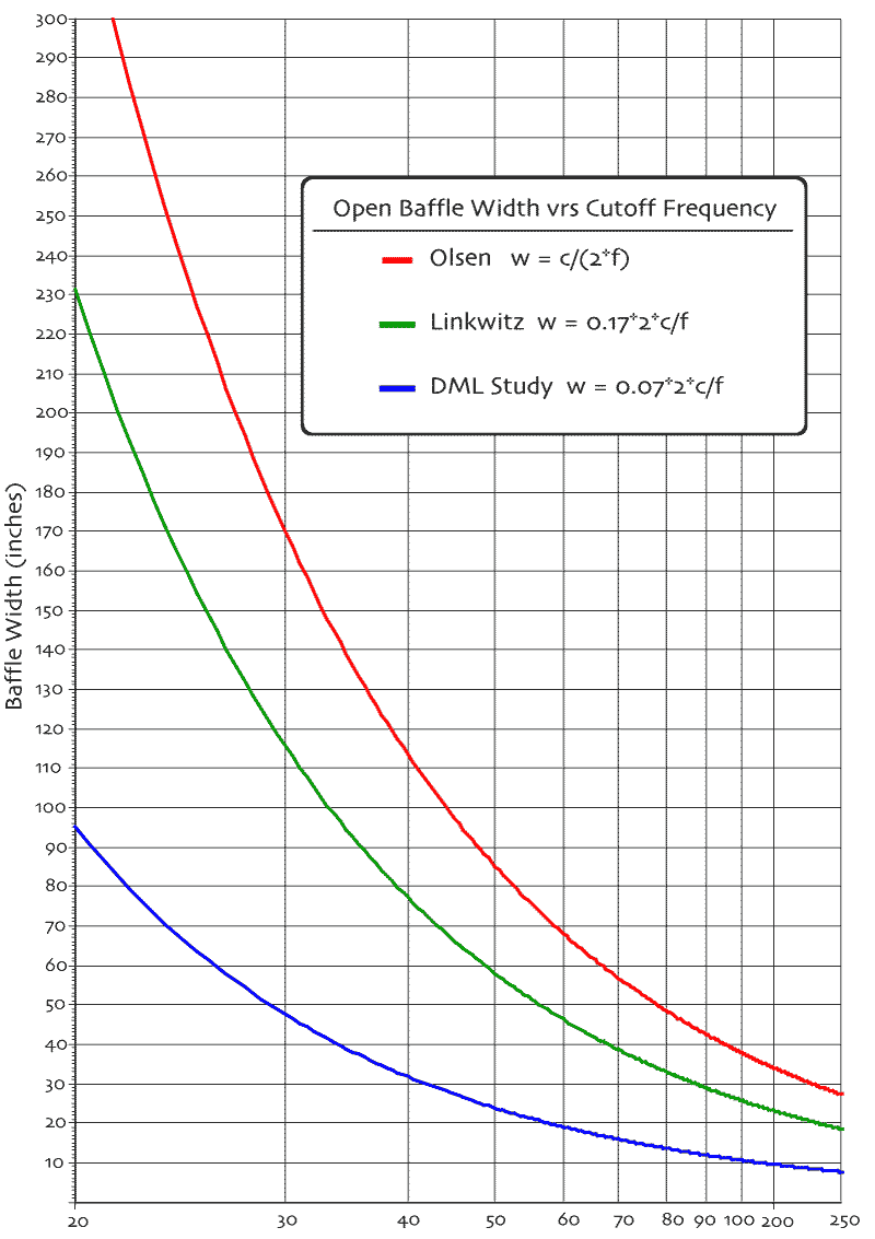

What do these graphs reference? The Fequal or a -dB point?
Drastic differences in any case.
Steve
Steve
