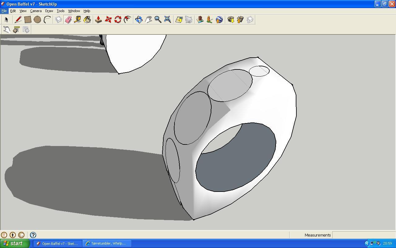

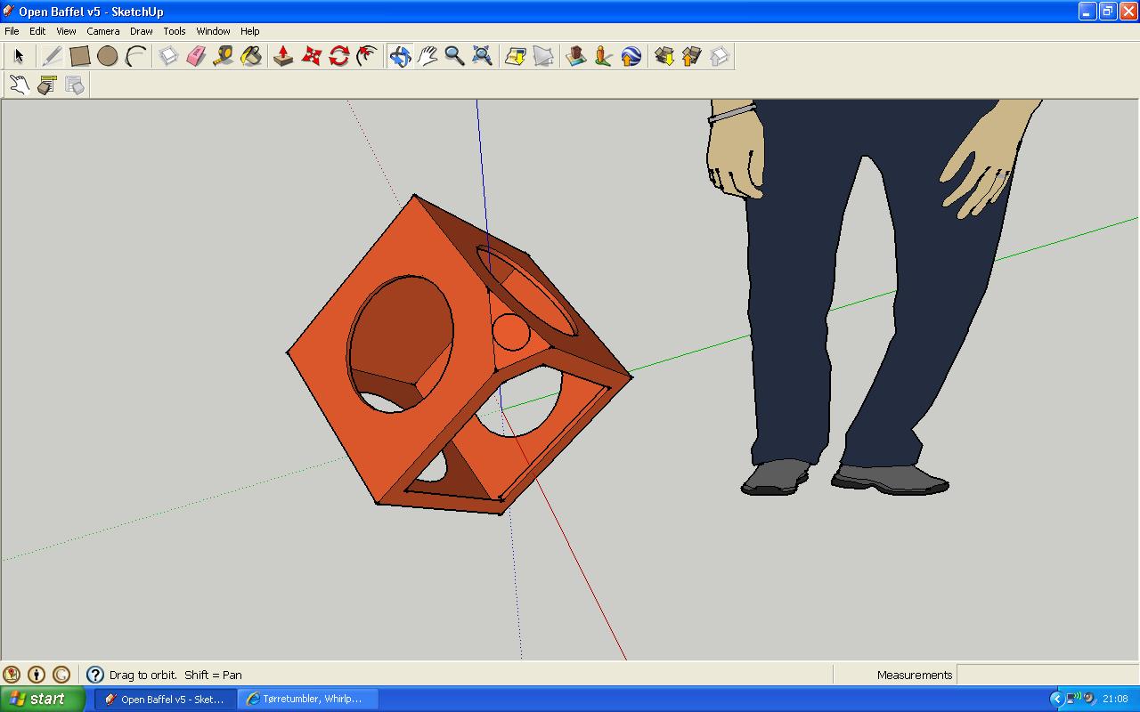

I have two ideas at the moment.
1: Think of a quarter circle. Here I will have 4 woofers in OB, and the Mark Audio fullrange on top (little forward tilted as in Carlsson) -
I will cross over around 200 Hz, depending on the Mark Audio drivers ability to go that low in OB.
2: A cube like the RAAL, Woofers on side and OB opening in front. Mark Audio CHR70 on top (again with a little forward tilt)
I will finish some google sketchup drawings that I will post toonight

Model 1 looks interesting. I expect some type of cardioid-type directivity.
I wouldn't point the Fullrange at the ceiling without a reflector. That size drivers beam in the last 2 octaves. I strongly suggest you try it before committing to that design.

The woofer I'd try next would be two 12 inch Peerless XLS on opposite sides of a cube shaped cabinet, with a divider inside, slightly over-damped (cab internal volume slightly less than theory says is right), wired so both cones push out at the same time. This way, any shaking of the cabinet at low frequencies will mechanically cancel out, and less energy lost. I'd then use active EQ to force it to be flat to 20 HZ at the listening position (typically that would mean about 15dB boost at 20 HZ relative to 100HZ, and I wouldn't take woofers above 100HZ. I'd use an active crossover with a 4 pole cutoff rate to split it away from the "satalites" (higher frequency speakers).
