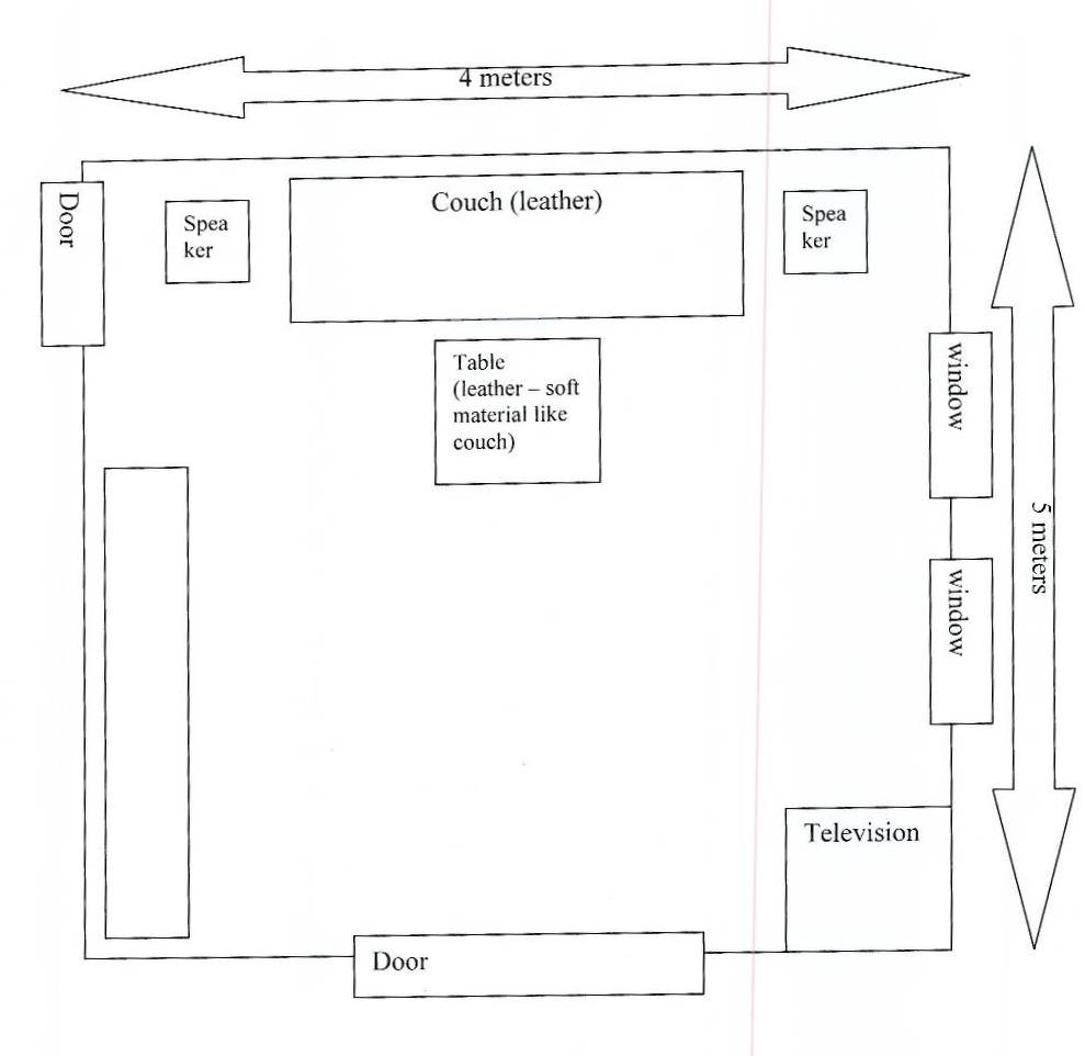

Cardioid bass is said to sound better than dipole in enclosed spaces. There's lots of good information on John K's web site. It should be easy to pull off with quad 10"s in an open U-Frame.
As for the Mark Audio unit I would stay away from dispersion lenses unless you have access to sophisticated modelling software and are willing to go through multiple iterations. It should work fine either open or boxed as long as you have good transition of the dispersion pattern at the crossover.
The biggest problem in your implementation is no doubt the room layout. Wide dispersion speakers sound acceptable off-axis but the optimal listening position is in the sweet spot. This is because of the nature of stereo recording, not the matter of delivery. You might find yourself sitting mostly on the floor rather than on the couch. Also wide dispersion speakers benefit from being placed at equal distance to the side walls. You might encounter strange effects if you have a wall on one side and an open door on the other.

Too bad you can't rearrange the room such that the TV could be right between the speakers.
Not really. I'm not a fan of having both music and TV on same speakers. Sometimes the kids are watching TV and I listen to music at the same time.
My stereo is a media center, and TC is also connected to a mediacenter. I have tried to combine, buts its not for me.
