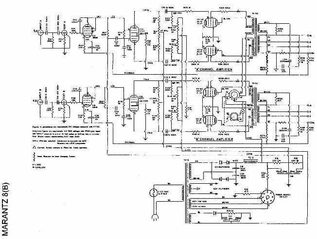

Take a close look at the 8B schematic. It employs stacked diode pairs in a Greinacher doubler B+ PSU, just like the H/K Cit. 2 does. Contact Jim McShane and buy the same diodes he puts into a "Deuce". Buy the film snubber too. If replacement PSU caps. have not already been purchased, talk to Jim about increasing the value of the parts in the doubler stack. If you do increase the cap. value in the doubler stack, buy Jim's NTC inrush current limiting thermistor kit. What's going on in an 8B is quite similar to what's going on in a "Deuce". We are talking about 2 of the very finest "vintage" amps ever offered to the public.

I got the amp recapped and I replaced any resistors which were more than 5% out of spec and it seems to behave as far as the power supply, but the amp doesn't pass a signal on either channel. I'm running it at reduced input voltage for testing which produces about 275V B+. I inject a 1V signal and I can follow it through to pin 2 on the 6CG7 where I measure about 35VAC, so good gain from the Input tube. I get no signal in pin 7. B+ appears where it should. The meter was replaced with one from VAC and I was told it has an internal shunt. I get no meter deflection with bias adjustment. I do measure B+ on both meter terminals. Suggestions appreciated.

Please refer to the uploaded Marantz 8B schematic. The B+ PSU is a "full wave" voltage doubler. Notice the cap. stack. Considerable benefit comes from increasing the capacitance in the doubler stack. When the amp was new, high value parts that fit in the available space could not be sourced. Modern etching techniques have GREATLY increased the capacitance per unit volume of electrolytic caps. and have done so at reduced cost. :) With care, that which was very good, to begin with, can be made better. :D

R31 open circuit = No supply to the anodes of the phase splitters.
If you have signal on the control grids, by default you will have signal on the anodes.
Well, see, there's the thing. I have signal on pin 2 and none on pin 7 of the 6CG7. I have anode voltage and the tubes are passing 12 mA of current through a common 13K cathode resistor. I have no signal on the anodes. What's up with that? The tubes both test fine in my emission tester. Any constructive suggestions will be appreciated.
Amateur here, maybe pointing out the obvious? Do you have a signal generator? If you do, with the amp off and 6BH6 and 6CG7 removed, apply an AC signal at pin 5 of 6BH6. Then trace it through R6, C5, and R5. Then disconnect C5 from ground, and disconnect feedback connection, then finally lift one side of R7. You're looking for a loss of signal between pin 5 of 6BH6 and pin 7 of 6CG7, yet you have signal on pin 2 of 6CG7. You shouldn't need either tube installed or power on to find this problem. Would love to be of help?
There's another thread on this subject and here's what I was told there:
No signal and or low DC voltage on pin 7 or the non-driven grid is normal. The reason is the grid is at AC ground thru C6. The DC voltage is low because the all of the voltage is coming from R7 which is a 1M resistor, very little current and your meter/scope loads it down unless you use a very high imp. meter.

Ah, I wondered about C6 and would it be a short to ground. But I think I just learned something? Is the signal transferred from the upper tube (grid pin 2) to the lower tube via the coupled cathodes? And is that the mechanism that throws it out of phase? If that is the case what is the purpose of all those resistors and caps between R6 and R7? I recognize R7 as a grid resistor. And is the lower tube a grounded grid then?
