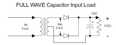

Neither. It will be something like 925V, which you may want to double in case of mains transients. This assumes that the 660V is an RMS value - the usual way that transformers are specified.
Good point, those are RMS values, hadn't thought of that. I see a good selection of 1200v rated parts on Mouser so i should be able to find something suitable.

This is a full wave rectifier, not a bridge.
Diode will see twice the peak voltage, which in this configuration is 1.4142*330VAC , so twice 467VDC = 934V
A nominally 1000V diode, such as popular 1N4007 customarily stands this, because of course it's made with some extra safety margin.

EM513 = 1600v 1A
EM518 = 1800v 1A
usual method in such case however is to connect two diodes in series
2 x 5408 = 2x1000v 3A
EM518 = 1800v 1A

Or BY228 = 1500V 3A 😎

I'd suggest using 2x 1N4007 or UF4007 in series for each diode (assuming current rating is fine), without any balancing caps or resistors. Although 1N4007 is 1kV PIV rated, and may have some margin, the AC mains could be 10-15% off the rated primary voltage of your transformer, as you haven't really identified that side of the equation.
Using 2 series diodes of the same type/batch should give you sufficient extra PIV (not 2x PIV, but certainly a good percentage of that). And it also reduces the off-state diode capacitance, and so alleviates noise egress from the PT side of the diodes.
A compromise on the brickwall primary side transient protection suggested by Mark would be a smaller MOV alone placed across the primary winding. Such a MOV would clip any primary winding induced voltage transient induced by a power switch turning off. If you feel as if your equipment needs protection from high energy transients/surges coming in from external mains AC (eg. lightning strike, or a HV line falling on an LV line), then I suggest that protection is best located at your switchboard, or in a local power board that also protects other audio gear as well.
