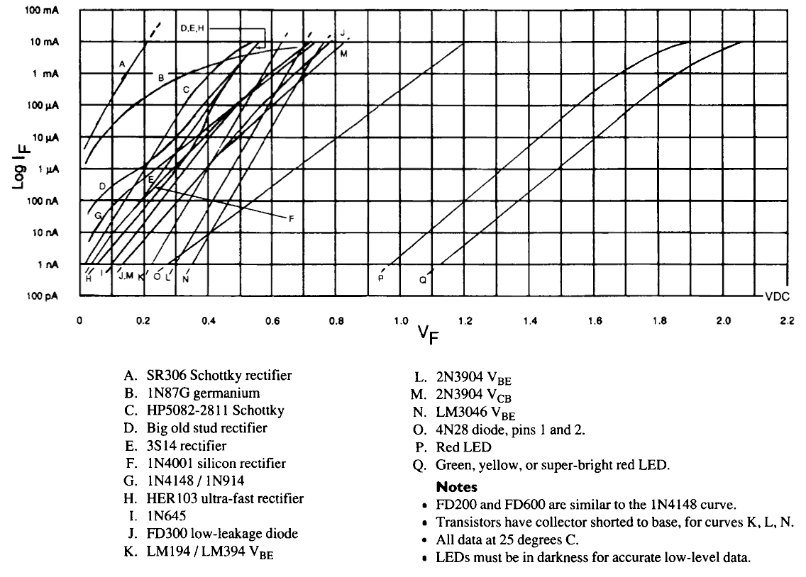

Bob Pease had some actual measurements and associated thoughts. But he was so prolific they are hard to find. This (below) is preserved in the back of his book.
IIRC: on LOG plot a basic diode is "linear" (really loggy) above leakage and below parasitic resistance. Series resistance on modern parts is small until you get to the last decade of rated current.
And "dynamic resistance" follows Shockley's Law over many decades of current.
There is no useful "threshold". It may look that way on a linear plot but on log plot it is the same curve all the way down (to leakage).
BUT "computer" diodes (most of our basic diodes) are Gold-Doped which bends their curves.
If you want log-curve a buffered BJT is the usual best-fit.
If you want a "threshold" you want an amplified diode and reference voltage.

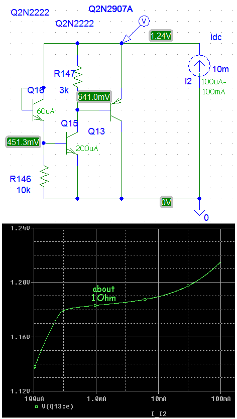

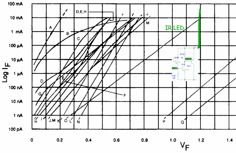

If you just stack two diodes, you get a differential resistance that's inversely proportional to the current. There is not much you can do about that, you can only try to keep the differential resistance low by using diodes with a low emission coefficient, that is, using the ones that have a steep curve in PRR's plot. The best you can get at room temperature is about 104 ohm at 0.5 mA, 17.3 ohm at 3 mA. If that's not good enough, use a different type of shunt regulator than two stacked diodes. The simplest alternative I can come up with is two diodes (or one LED) that conduct the cathode current plus some extra bias current that's >> 3 mA.
So if I take 2 diodes 1N4148 in series with a nominal current of 1.5mA, and vary the current +/-0.5mA, that will give delta-V of 64mV (Zd = 64 ohms), but when I pre-bias them with 7.5mA, the voltage variation is only 16.5mV (Zd = 16.5 ohms).
Using a diode-connected transistor should make it even better.
Jan
You could also try something like this, where 1 is the input node and 0 ground:
Q1 1 1 3 NPN
R1 3 0 150
Q2 1 3 0 NPN
That's a diode-connected Darlington with an extra resistor to bias the first transistor at a more or less constant current.
R1 may need to increase if you have only 5 mA to spare. With R1 = 150 ohm the circuit only just starts to work at 4 mA or 5 mA.
With more components and setting the minimum current to about 1 mA:
Q1 2 3 1 PNP
Q2 3 3 0 NPN
Q3 1 2 0 NPN ;; preferably a type with high hFE
R1 1 3 1500
R2 2 0 1500
C1 1 0 1E-9 ;; or whatever is necessary to get rid of ringing
Q1 and Q2 set the voltage and run at more or less constant currents, Q3 takes care of the current variations.
It's similar, but not equal. It's my circuit from post #36 upside down, with reversed polarities of the transistors that are not diode connected, resistors redimensioned and compensation capacitor removed. I think you need to check the step response (or some other stability measure) to see if you can do without the compensation capacitor.
