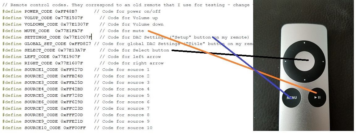

This old dog learned some new tricks. Serial Monitor with Dimitris code is neat. Press remote button and a code appears. 🙂 I am guessing if the software wasn't written for this, I'd have to use the one savvas posted.
I attached pic of how I configured remote. The new Apple remote codes start with 77. Up, down, right and left self explanatory. Wondering about the Global Dac Settings command? Power on/off and Global Dac settings only two I have no buttons for and left in OEM code.
I drew lines showing remaining commands. Wondering if I should use the Global one for menu instead?
Also, the select button and mute button throws two codes. The second code is the same for both buttons, 77E1A07F. Don't worry about them?
I wouldn't worry too much about the Global Settings button. It's not used very often.. you can get to it using the rotary encoder if you need to. Just go into Menu and then do a sustained press of the encoder.
I'm not sure about the two codes. I'd say that if the buttons work, don't worry about them.

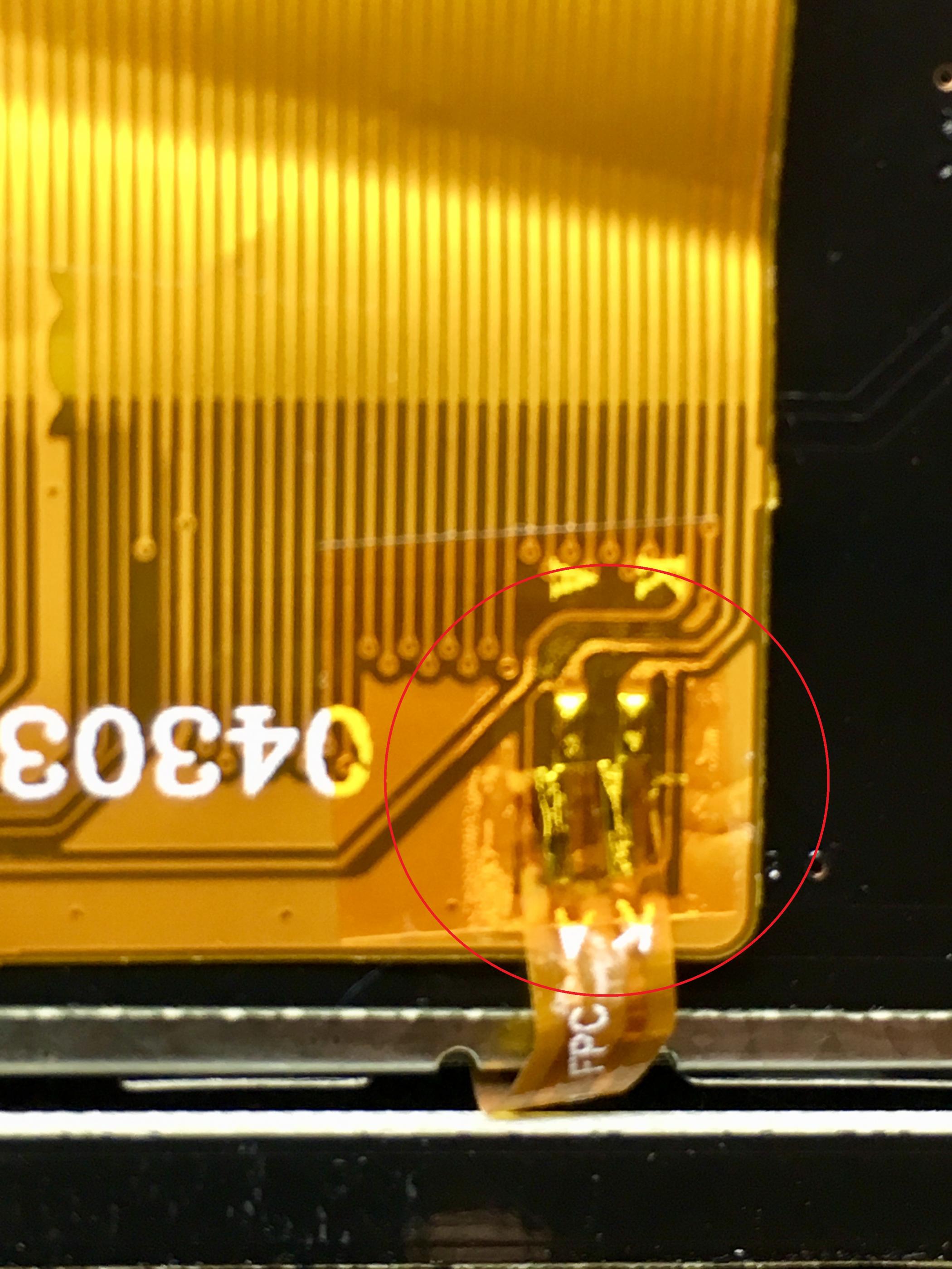

I've now assembled all the parts to build the shield. Kudos to Rich for the encoders and other help! The sainsmart 4.3" display arrived yesterday. The ribbon connector marked A K has what looks like sketchy solder connections under a layer of Kapton tape where the small ribbon attaches to the main ribbon. See attached pic. Does this serve any important shield function and/or is there a quick display test I can do?

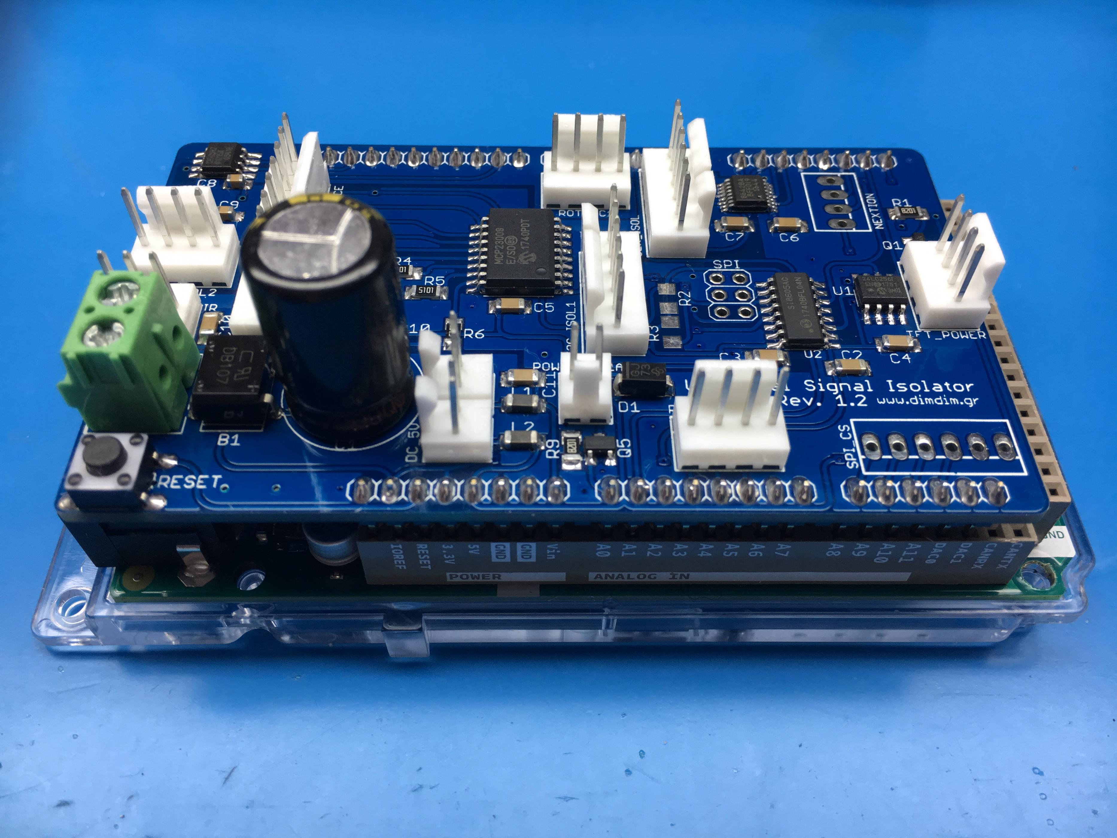

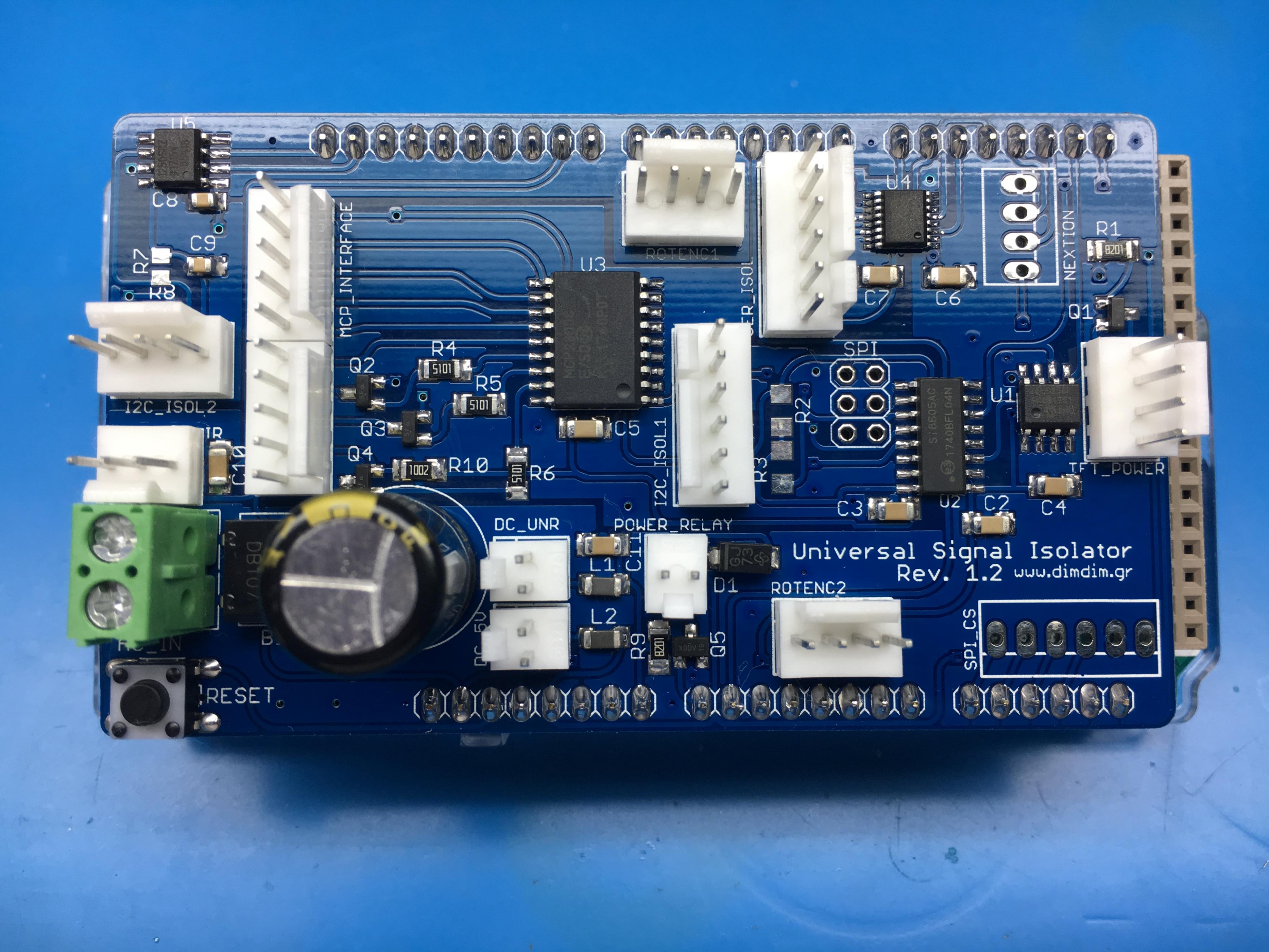

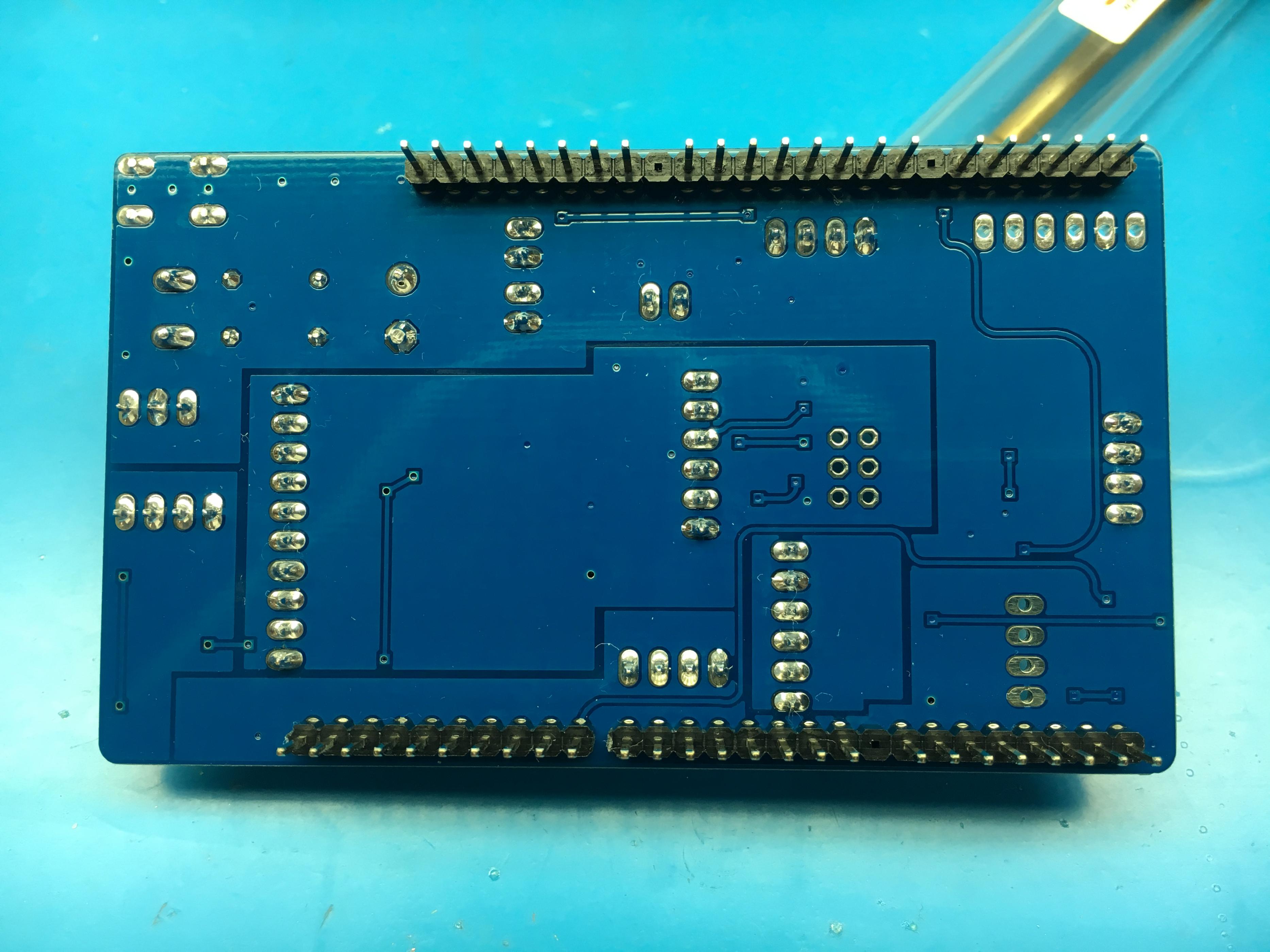

Just some pictures after populating the shield. Now moving on to the display harness. Probably the best way to see if my sainsmart is working OK is to finish the build and hope for the best...

Very nice looking shield! You will be using it with a Buffalo board, right? I'm asking because I'm seeing that R2 & R3 are not installed. That's OK for the Buffalo boards (they have on-board I2C pull-up resistors) but other DAC boards might need them.
Thanks! Yes, this is destined for a Buffalo IIIsePro28 (ES9028) DAC. You thoughtfully left ample room around the pull-up resistors so they can changed up later if needed.
