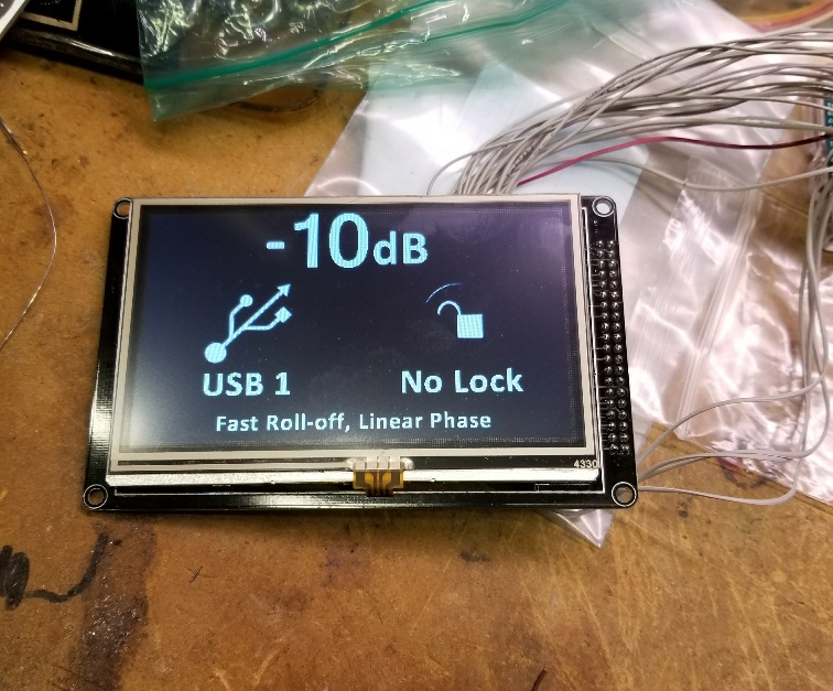

Physical Wiring
Hi DimDim,
I have been reading and trying to understand how to put this TFT HiFiduino together. I do have a few questions if you dont mind, I cant seems to find a guide in how to wire the TFT to the DUE or to the shield? I already have the shield, but I could not find any documentation as to where those pin connectors on the board are going? Would you be so kind to direct me to where I can find some documentation pertaining to the physical wiring?
Thanks,
Alex
I'd say that the hardest (or better, more tedious) part in building such a controller is making the cable that connects the TFT to the DUE. The shield is pretty easy to put together, even though it has smd components. They are very large components, for SMDs.
