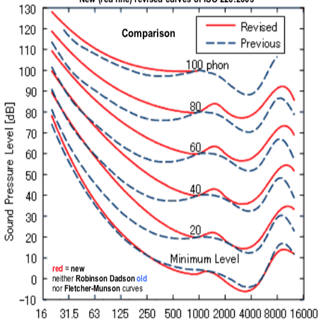

Our hearing's equal loudness contours require significantly more relative low frequency to "keep up" at lower volumes.
A 10 dB variance at 1kHz sounds twice (or half as loud) while a 5dB change at 30Hz does the same, and around 70dB is the minimum level most can hear at 30Hz.
110dB at 30Hz sound around equal loudness to 80dB at 1kHz.
Drop the level at 1kHz -20dB to a conversational level, ~60dB, and 100dB at 30Hz is required for equal loudness, a 10dB relative increase.

As you can see in the equal loudness chart, hearing "flattens out" at higher levels.
This tends to make musicians prefer higher levels than average.
It is another reason why inexperienced sound engineers mix "too loud"...
I have tuned my bi-amped home studio subs and monitors for flat response to ~25Hz at 80dB SPL with both the amplifiers gain set to full.
When playing at a lower volume (most of the time), I turn the monitor volume down by as much as 20 dB (compared to the subwoofers level), an easily variable "loudness contour".
I have never had this explained to me. This makes a lot of sense why low level near field listening sounds like it has no bass and when I turn it up I feel like it all levels out evenly. This is the second thing I learned today.
