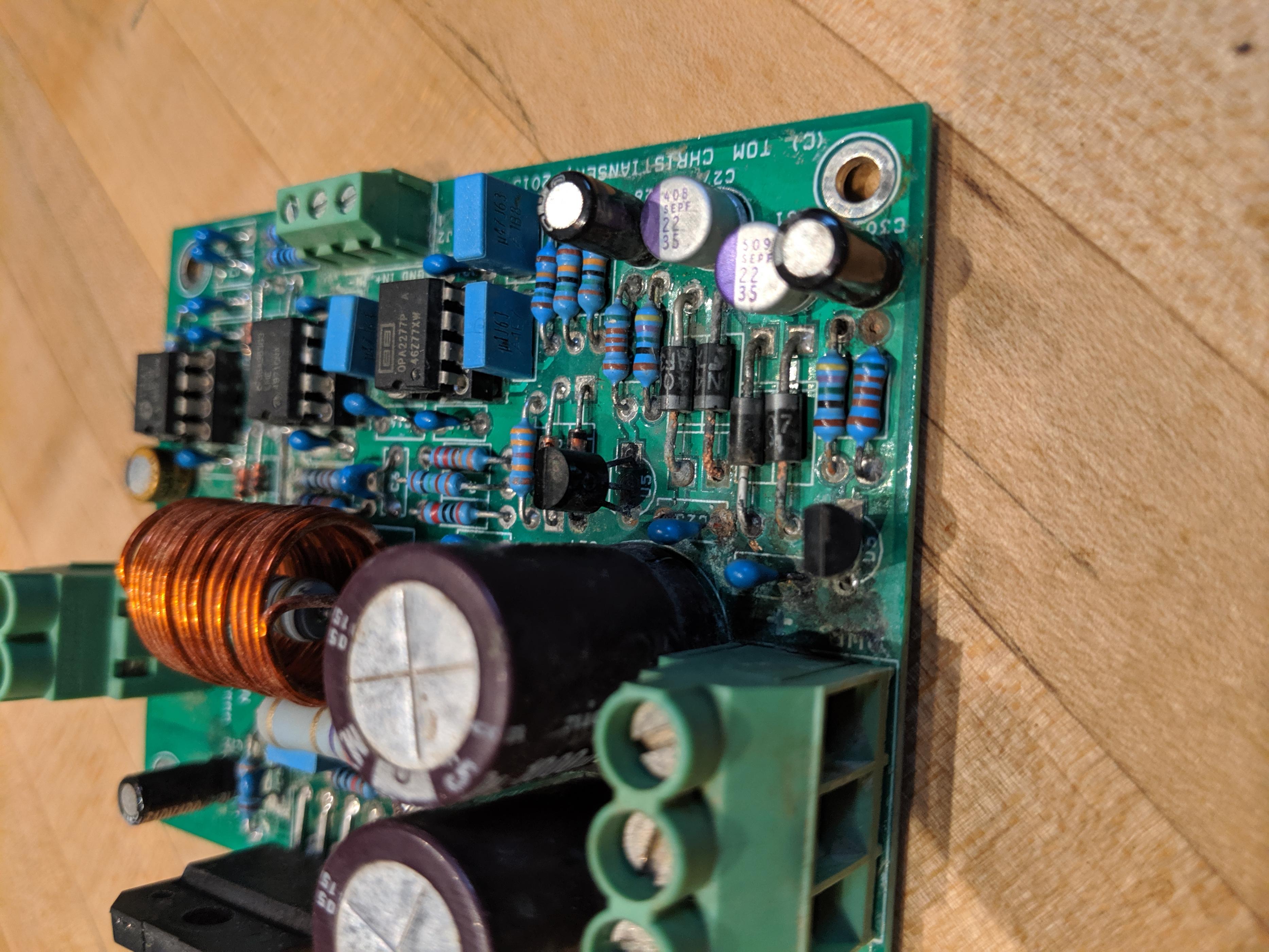

Mine complete:
I used 2200uF FCs before the regs and two elna staget caps by the output buffer (had them spare). I plan to get a 2x single > double opamp converter to fit 2xOPA627s.....if it will fit.
