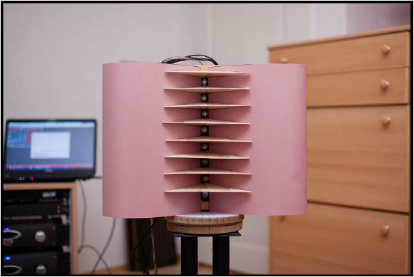

Okay, a couple of finer points, mostly because while the effort to print the V-dosc style waveguides is a commendable effort in and of itself…I think you’re going to mislead a few people down a path that is supported by the physics of what’s going on here.
Before I go into any of the individual things stated in your posts. From the patent:
“This wave guide aims to transform a planar circular isophase (membrane of a loudspeaker or output of a compression chamber) wave surface into an isophase planar rectangular wave surface.”
A critical word in this statement is “planar”…for the waveguide to work correctly the wavefront at the entrance of the waveguide must be planar.
So…let’s go through a few of what I believe are the more serious errors in description and understanding.
"The next thing is shading. Shading the array increase the high frequency extension and ALSO increase the beamwidth. On the flipside, if you remove the shading, you lose high frequency extension and the vertical beamwidth gets narrower.”
If a V-dosc waveguide is working correctly the output of the waveguide is a rectangular wave surface. For reasonable dimensions of one (back to this later) that means that they will not interfere with each other vertically, and an array of them will show the typical ripple patterns associated with comb filtering. This is the same as a paraline or any of the other circular planer to rectangular planer waveguides used by the pro-sound industry to create better high frequency summation of large arrays. Some are more effective than others…but that’s outside the scope of this discussion.
If you’re forced to shade the outer tweeters to maintain high frequency extension that means that the v-dosc style waveguide is relatively ineffective at transforming whatever wavefront is launched off the soft dome tweeter to a vertical columnar wavefront at the entrance to the waveguide and cancellation is occurring.

Here is the measured polar response of my high frequency combiner, using one element (the first graph) and three elements (the second graph.)
I was doing some measurements and had a "Eureka" moment where I nearly fell out of my chair. Again, this realization will be completely obvious to anyone who's built a line array, but I didn't realize it 'til yesterday:
The device must be about as large as it's going to play.
For instance, in my device, when it goes from one tweeter to three, the polar response improves noticeably. This is the complete opposite of what I expected. I'd expected that going from one tweeter to three tweeters might raise the output by 3dB or so, but I assumed there would be some destructive interference which would prevent me from seeing a gain of 6dBish. (Which is what you'd get if the devices generated a perfectly flat wavefront.)
Note in the 2nd measurement, how the polar response above 6khz is darn near as good as a conventional waveguide, but below 6khz it's not-so-hot.
So, think what's happening here is that when the device is playing frequencies that are larger than the device, the wavefronts aren't shaped correctly.
For instance, in a conventional waveguide or horn, we are trying to generate spherical wavefronts. And when the wavefronts are bigger than the waveguide itself, the waves are still spherical, they're just spherical waves that are unconstrained by a waveguide. This is why we see a broadening on the waveguides beamwidth below the frequency that the waveguide can constrain it.
Here's a measurement of a tymphany NE19 on an XT1086 waveguide from 18Sound. Same tweeter as I'm using in my high frequency combiner. Note how the polars get *wider* at low frequency, but they don't get wrecked.
But in my high frequency combiner, the polars are all over the place below 6khz.
I think what's happening here, is that the device is producing a flattish wavefront at the frequencies that are controlled by the device. Each element is 5cm tall, and 6800Hz is 5cm long. So this means that the device is doing what it's supposed to do above 6800Hz, it's flattening the wavefront. But an octave below, at 3400Hz, there's zero wavefront control, we're generating spherical waves. Hence, the chaotic polar response below 6,750 Hz.
And that's not good.
Here's the vertical polars, and they seem to reinforce what I think is happening: each element loses pattern control at 6800Hz, and then they start to interfere with each other.
For instance, note how the vertical beamwidth *above* 6800Hz is less than twenty two degrees wide. But at 400Hz, the vertical beamwidth is 44 degrees and at 2500Hz the vertical beamwidth is a whopping seventy degrees!
My big "Eureka" moment was when I put walls on the top and the bottom of the waveguide. If you look at the pictures that I posted, I measured the device with no top or bottom, just the left and the right side.
My assumption was that the addition of a top and a bottom would improve things, but it actually got a lot worse! That's when it hit me, these wavefronts cannot be flat. Because if the vertical wavefront was flat at 2khz, it wouldn't "see" the top and the bottom of the waveguide, the wavefront would sail right through the waveguide as if the top and the bottom were not there.
(On a side note, this is one of the "neatest" things about Paraline style devices: because the vertical beamwidth is so narrow, they are insanely efficient in their passband. It's like taking the light from a incandescent bulb (spherical radiation) and focusing it into a narrow beam.)
Another thing about these devices, is that they have a very narrow beam. As little as ten to twenty degrees. When you go from ONE device to THREE devices, you improve the HORIZONTAL polar response. A big part of this is because you don't have to keep your head (or the microphone) in a vise. IE, with one device, and a height of just 5cm, that's an insanely narrow vertical beam. As you add more devices on the vertical axis, the beamwidth stays similar, but the vertical "sweet spot" is taller because the device is taller. Taken to the extreme, the device would go from floor to ceiling.
To be honest, I'm kinda stumped on how to fix this thing. Here's some ideas I've had. None of them are optimal:
1) One idea I had was to *physically* curve the three elements. Basically tilt them away from each other, so that they interfere with each other less when they reach a frequency that the elements can no longer control the wavefront shape. That's a bit of a band aid, because it would probably only improve things down to about 4000-5000Hz. It won't give me those crazy smooth polars that you see with the conventional waveguide.
2) Same idea as #1, but use five elements instead of three. That would probably work nicely. That means that the curvature of the device itself would keep the wavefront curved down to about 1,350Hz.
454118d1418726865-line-array-prototype-waveguide-cbt-shading-line-array-1-png
3) Add some vanes like Follgott did in his project. The idea of the vanes is to basically keep the wavefronts from interfering with each other. Take the spherical wavefront and squish it flatter.
4) Some combination of all three.
Here's a summary:
My paraline style device appears to work very nicely above 6800Hz. Below 6800Hz, the performance is good, not great. I think the issue is that each individual element can only flatten the wavefront down to 6800Hz. Below that, the wavefronts are spherical, and they're interfering with each other.

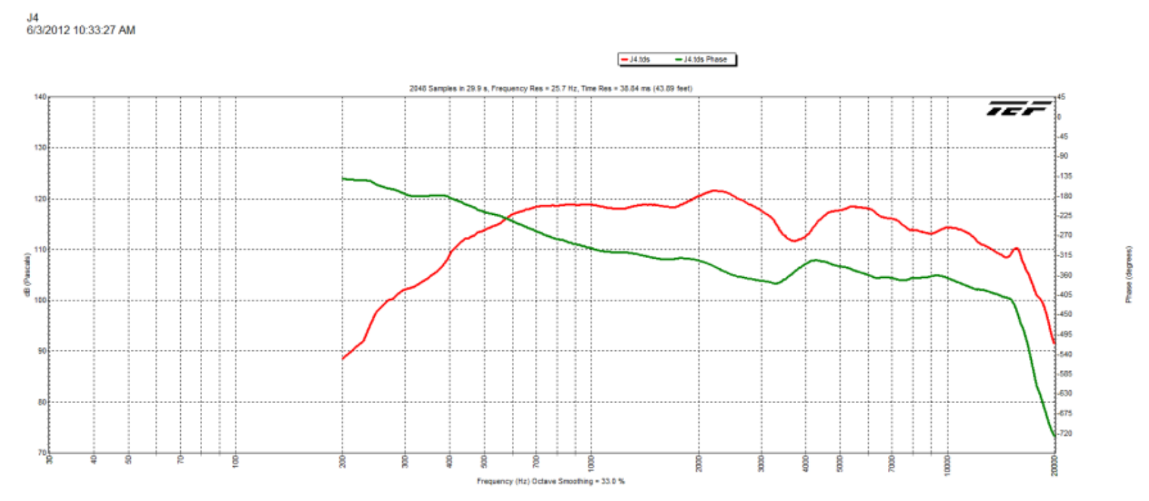

The layered combiner does seem to become ineffective above 15kHz as the attached plot from the J4 shows. The massive power handling is still giving it >130dB/1m potential output at 20kHz though. My guess on the reason why is that the compression driver itself is not generating the expected wavefront so even if the combiner where perfect there would be a reduction in output. Perhaps the combiner could be co-designed with the compression driver to correct this?

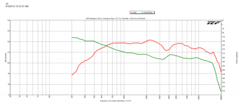

I created this animated GIF, to provide a better comparison between this VDOSC-esque thing, using one tweeter and using three.
The thing that impressed me about it the most, is how the performance improves as you add elements.
I posted some thoughts on why this is, earlier in this thread. In a nutshell, I think these Paraline and DOSC type things don't work properly unless their vertical height is equal to the lowest frequency or even longer. Basically if you make a speaker with a single Paraline or DOSC, and it's height is less than the lowest frequency, the wavefront will become curved. And we don't want that; we want a flat wavefront.
Ideally we'd just buy a ribbon or planar that's about ten inches tall and very very narrow, but such a device does not exist.
In the GIF, I've just taken the two measurements done earlier in the thread and animated them. This isn't exactly fair because the EQ settings are a little bit different (not a lot.) I didn't change the output level on my amplifier for the three tweeter measurement, but the impedance dropped, which draws more current.
If I was doing things rigorously, I would use identical voltage and EQ settings, but I'm not very rigorous lol
