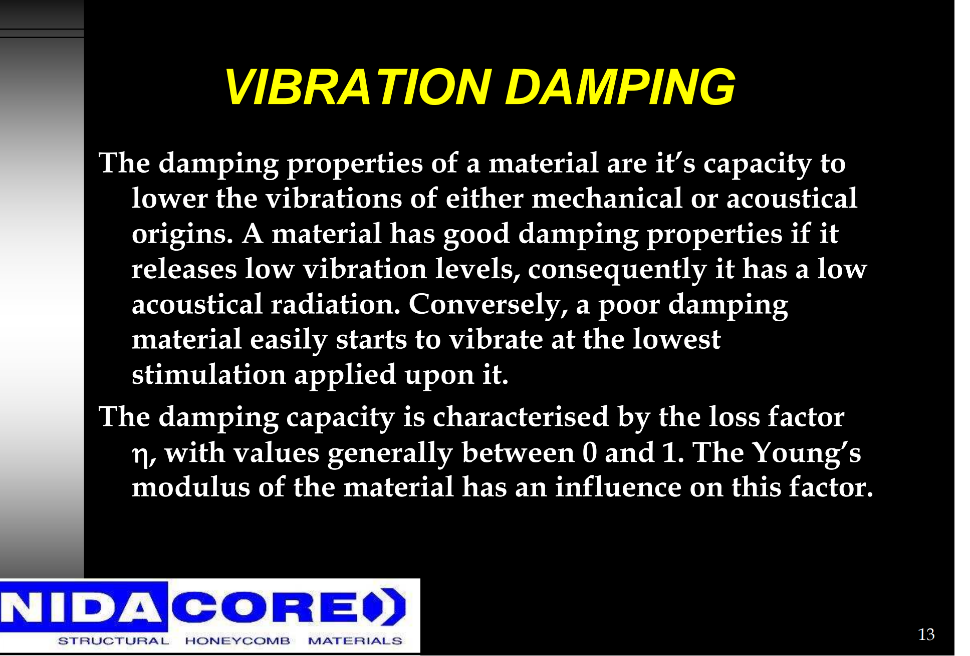

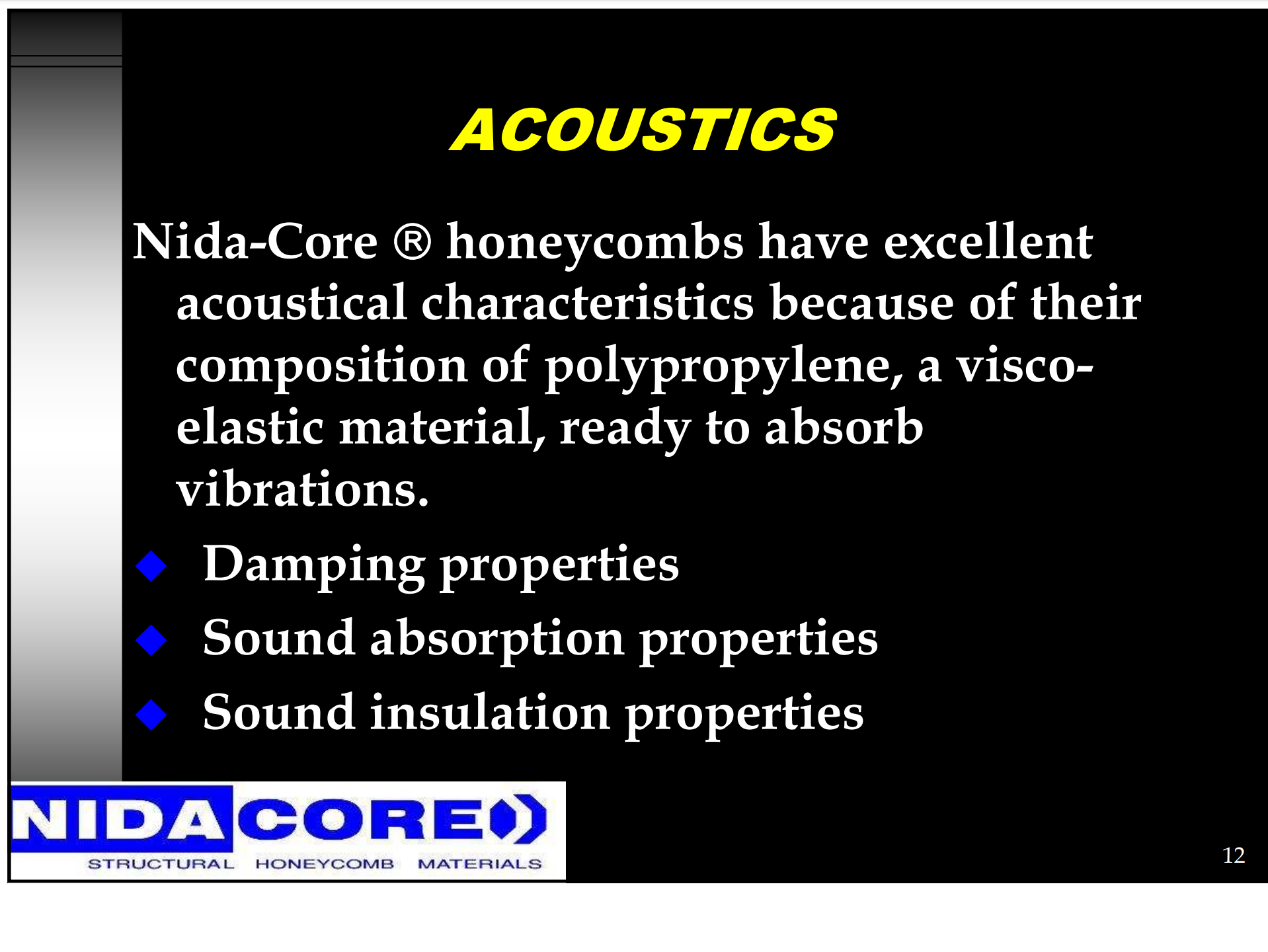

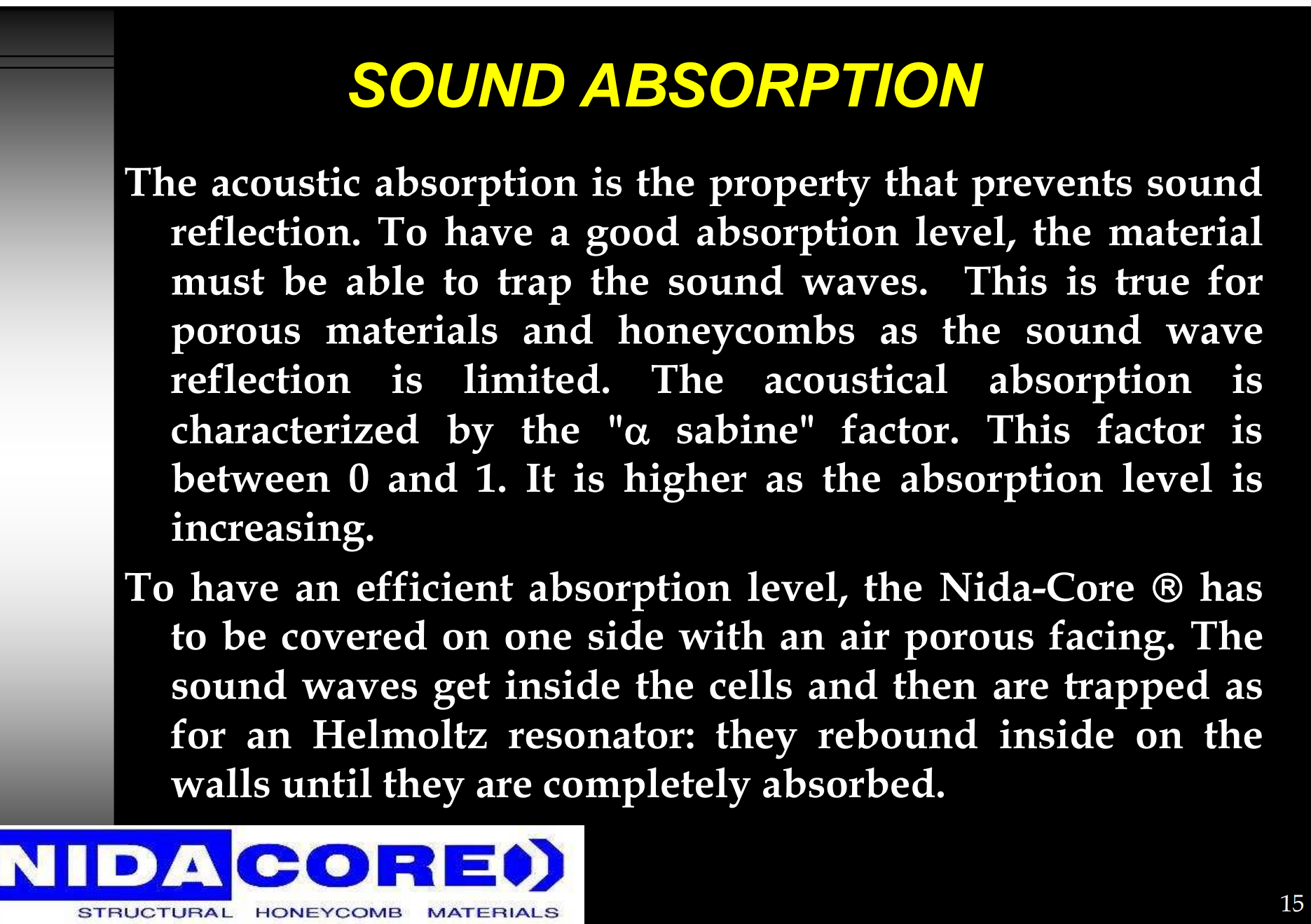

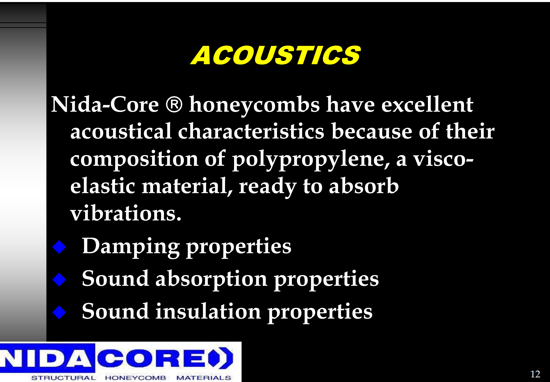

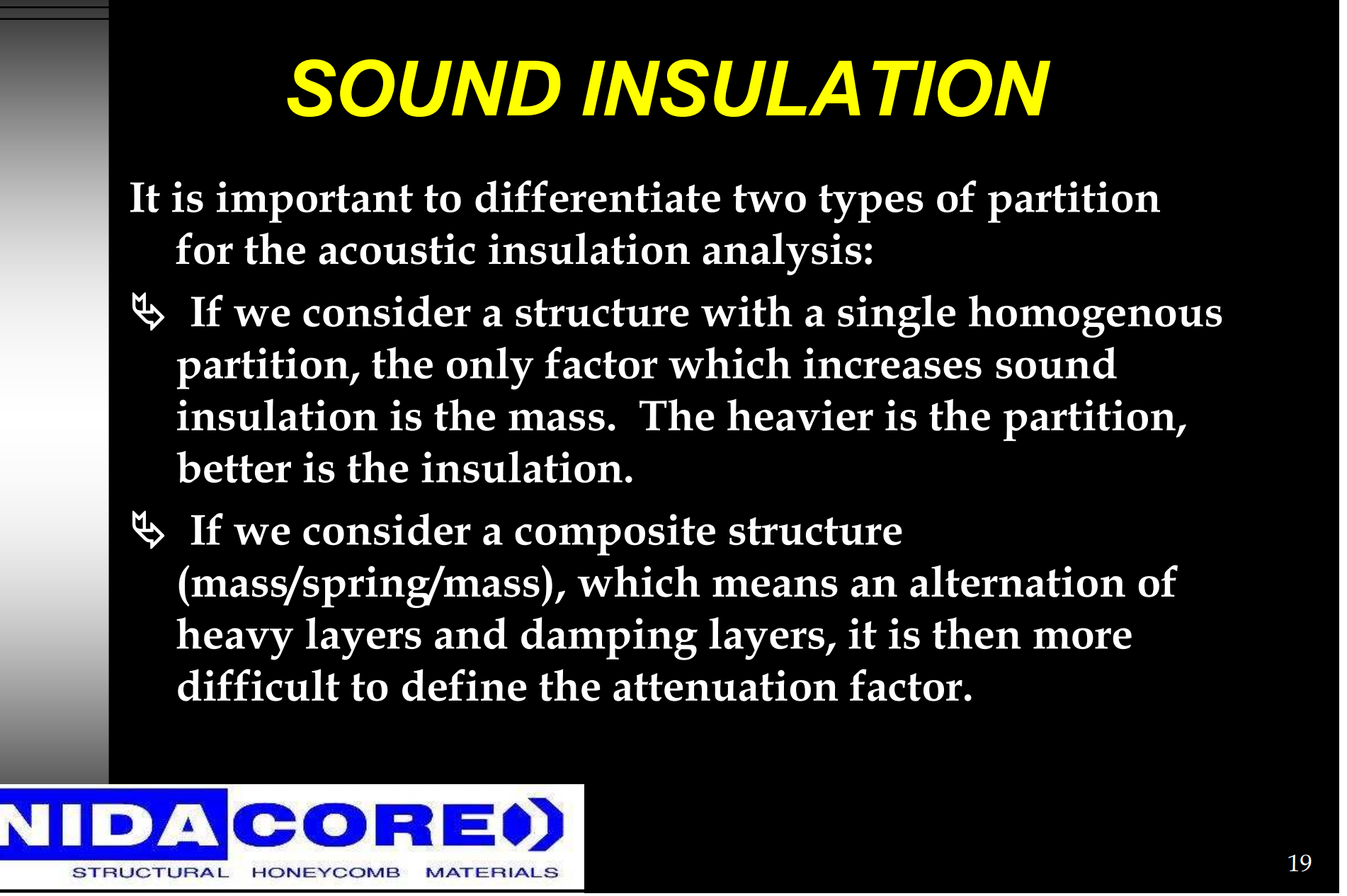

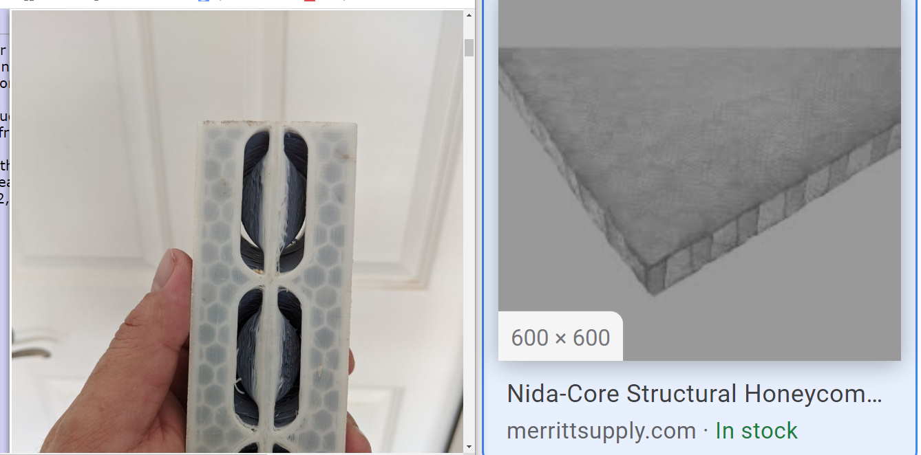

hi jzagaja. nidacore is polyester covered with polypropylene core. can you send me a graphical example of elastic plywood damping (small radiuses) so i can show it to them. tks
