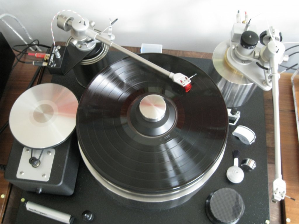

I think all vpi motors are designed to work with the VPI SDS so your roadrunner set-up should work fine since you use it with a VPI motor, albeit a belt drive, the rim drive actually has a belt that connect the motor to the belt drive system for example:
