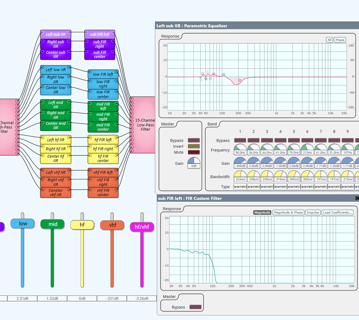

With regard to how is it best do minimum phase IIR (driver corrections is what I'm addressing)....this is a comparison I've been running just this last week.
Instead of simply letting the FIR generating software automatically embed minimum phase driver corrections, I put in IIR EQ's as preconditioning filters for each driver section. And then compared.
here's a snip showing partial signal flow and the left channel's sub filters (running 3 ch LCR)
So far, only the sub channel makes any difference at all, transfer function or listening, whether IIR is used separately or IIR/min phase is embedded into FIR.
Which makes sense because the FIR filters being used were only 8192 taps @ 48kHz, for about 12Hz frequency resolution. Not so good for <100Hz work !
But fine for higher drivers.
Bottom line imo, is when you can't tolerate latency, or have insufficient frequency resolution from available FIR capacity, use IIR.
Otherwise, FIR rules.
