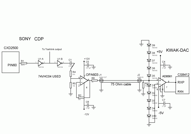

Hi Marce
SP/dif > analog or digital it's not an either or, it's both!
Transmit end is usually from a CMOS digital gate driver with a resistive element including the output driver drain to source Rds on. feeding a transformer. Thevinin sources are used to model drive levels and impedance to matching coax Zo including the transformer turns ratio. Please note the transformers are used to break ground loops and help CM noise suppression in the case of single ended coax SP/dif.
Receive end usually is a 75 ohm termination resistor AC coupled into the clock recovery IC input which consists of a CMOS Schmidt trigger that is a comparator with hysterysis and most times has useful linear gain. here is a good app note that explain Schmidt triggers from Fairchild Inc.
http://www.fairchildsemi.com/an/AN/AN-140.pdf
In my experience it takes more analog expertise to insure so called digital interfaces between systems or seperate PCBs work correctly esp. with independent DC supplies and CM noise. Most CM noise comes from so called "ground bounce" using CMOS devices. http://www.fairchildsemi.com/an/AN/AN-640.pdf
Its digital, its 0s and 1s, and we should use digital engineering and layout techniques, getting the o's and 1's from one end to the other is what we are trying to do.
Again an old application note, look up simultaneous switching noise, again ground bounce, and ground bounce is present on exery digital circuit with switching to as greater or lesser extent. When you have a few FPGA's or processor's on a board you get ground bounce, or Delta I noise, controlling it again is well documented engineering
practice and PCB layout, decoupling schemes etc.

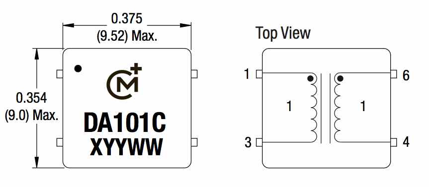

Correct orientation?
Two questions from someone on a steep learning curve.
With a 1:1 (4 pin) pulse transformer, is there a correct orientation?
For example, in the Murata DA101C shematic attached, are pins 1 and 2 for signal in while pins 6 and 4 are for signal out? Or does it not matter which side see the signal in?
Am I right in assuming that the dots on on the windings of pins 1 and 6 indicate the active in or out of the respective windings?
No, no 'correct' orientation - treat it like any other passive component which isn't polarized. The dots are just there to indicate winding start I think - not related to in or out, just polarity. So if you put a positive going voltage on the dot pin on one side, the dot marked pin on the other side will go positive too.
