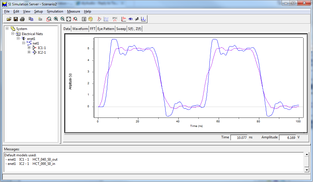

Gmarsh - done a bit of basic sim this morning, havn't got all the parametrs in, but looks bad and gets worse... Adding mismatched transformers should be even more interesting. The attached was cobbled together rather quickly, I would like to do a proper SPDIF interface using devices that are generally used, so any pointers to suggested devices would be helpful.

So you understand my point, SPDIF is by todays standards should not present a problem in getting a clean signal form A to B, compared with the ridicoulous speed a lot of todays digital interfaces run at with crazy rise times and 100Mhz plus clocks. We should be able to engineer the interface so that the signals arrive cleanly, this can be done using current engineering techniques, such as replacing nasty RCA connectors with BNC etc. That is why I am questening the effect transformers have, and looking for data, so that I can understand more of the problem.

But does the ringing really matter? John Kenny's SPDIF unit had some of the worst ringing I've seen, yet it worked flawlessly, sounded fine, and the measurements from the analog side (which is all that really matters for the sound, which I *think* was part of marce's point) were as good as any of the other units I've tried.

The ringing? Yes, I measured it, with and without attenuators (no difference). Also on two other units I had on hand, and a homebuilt SPDIF-to-AES/EBU converter using the TX102. The one with the least ringing had a slower rise time than the others, but worked just fine. I think I ended up where abraxalito is- any audible differences are more likely due to noise than to waveform fidelity.
