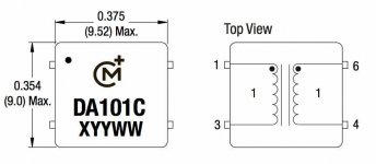

I'm using a Lundahl pulse transformer LL1572 (1:1) on the SPDIF unbalanced (coax) output stage of my Goldmund Mimesis 36+ CD transport, and I rather like it : smooth and natural sounding, much better than the stock Coilcraft WB2010.
However, some people seem to prefer Murata DA100 series, Scientific Conversion SC939 or Newava S37211...
Could somebody help me ? Some experience on the topic ? What criteria or rating is important to choose a 1:1 pulse transformer for SPDIF ?

The end device has to pull a clock out of SPDIF to use for playback, and the less damaged the SPDIF signal is before it gets there, the better the clock recovery is going to be.Can I ask how a pulse transformer on a digital signal can effect the sound! If the analogue was going through the transformer I could understand there being some effect, but a digital signal!
Think of SPDIF as an RF signal with sharp edges, and your goal is to preserve those edges. Making sure the interface you come up with doesn't ring and get extra edges, suffer from reflections that can bash subsequent edges, or take too much slope off the edges.
As for transformers... my usual metric for a transformer is a return loss versus frequency plot, you want it to be as low as possible at SPDIF frequencies. My usual transformer for SPDIF is a Mini-Circuits ADT1-6T, chosen for this reason. It's a 50 ohm transformer, and I match a 75 or 110 ohm input to 50 ohms when I use it. Never really used anything else.

It's the way the clock is encoded with the data that makes spdif so susceptible to the interface. There are several papers written by Julian dunn on how bandwidth limitation of the transmitter medium results in data modulated jitter.
Another factor is also that a poor transformer will have quite high leakage inductance making it harder to terminate properly and a poorly terminated interface gives rise to reflections which will also degrade the recovered clock by causing level uncertainties.

I would suggest that those using SC xformers know their limitations and have designed their circuits accordingly. If they are not taking this into consideration, perhaps you should consider another designer's units. Regards
While the point of the thread in the link I posted is, amongst other things, that ALL transformers need to be optomised in circuit, one of the clear messages also was that the SC transformers art tested were more compromised than the Naweva. He certainly had the means and the knowledge to optimise both; with both optimised the Naweva was the preferred option. SC may have improved their designs since, I don't know.

The nice 'digital' square wave generated in the playback device, once it's sent through the SPDIF interface and its associated cables, transformers, connectors, passives, etc.. can end up coming out awfully mangled on the other side. And the choice of any of these devices, including the transformer, can affect this. Pulling correct bit values out of the 'mangled' received signal is straightforward, but that's only half the problem with SPDIF, and by far the easier problem.
SPDIF embeds the clock in the data stream, and the receiving end has to use a PLL to extract it and provide the playback clock. It does this by detecting the edges in the SPDIF stream and trying to line up the edges of a local oscillator with it. The more the edges get pushed around in time by the 'mangling' of the interface, the harder the PLL has to work, and the quality of the recovered playback clock degrades. Jitter happens. And it can be audible.
So yes, a transformer can affect the sound of SPDIF.
