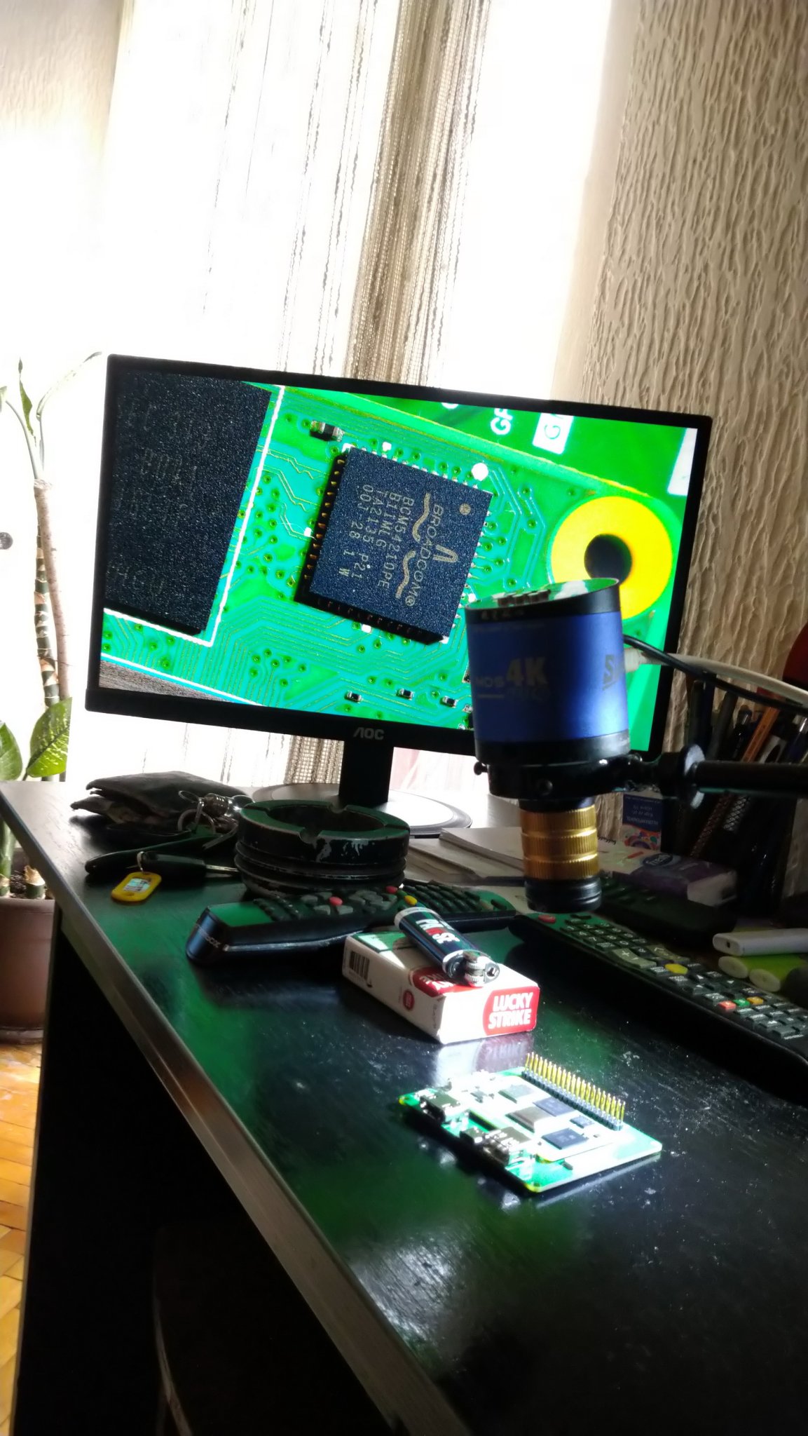

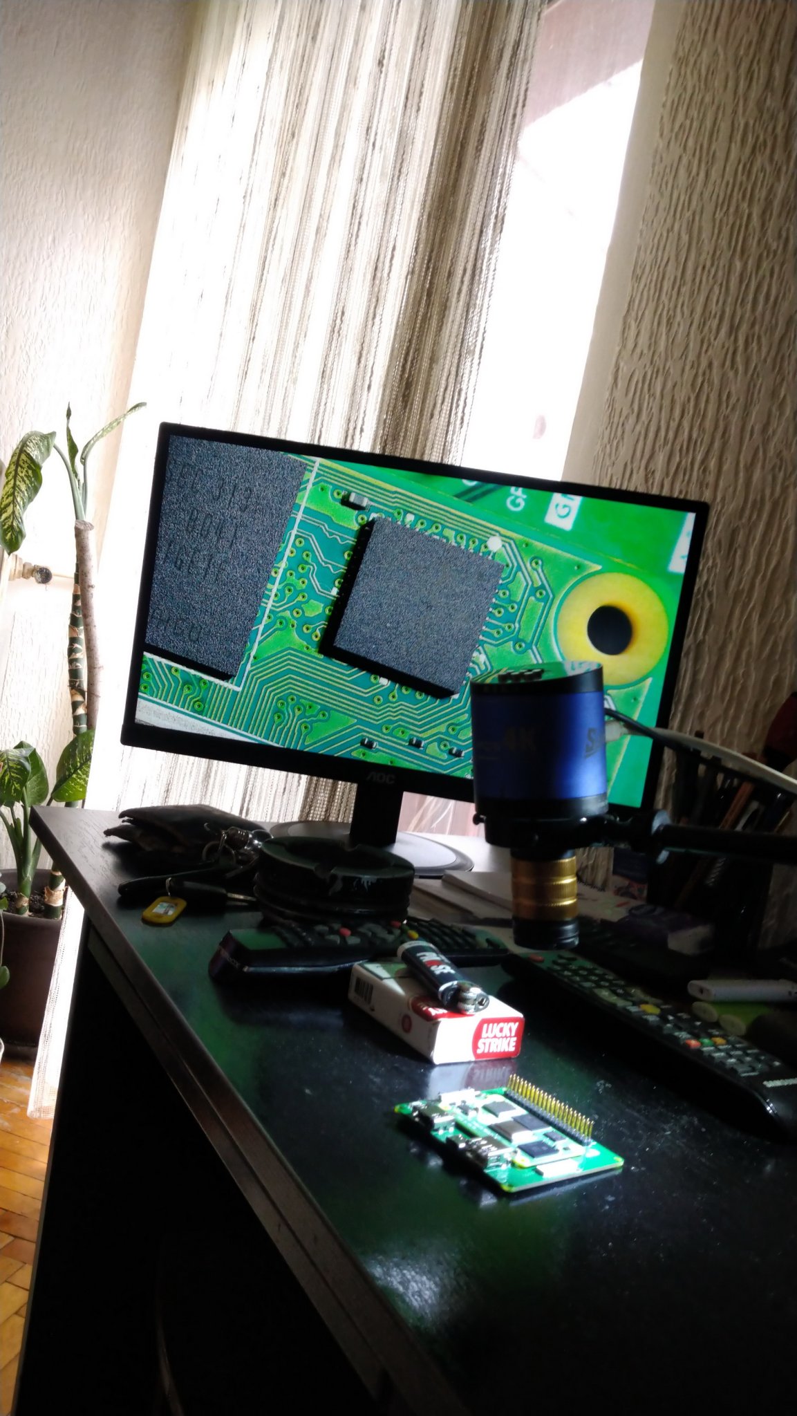

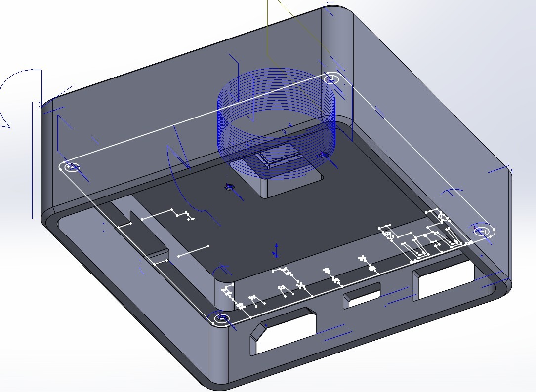

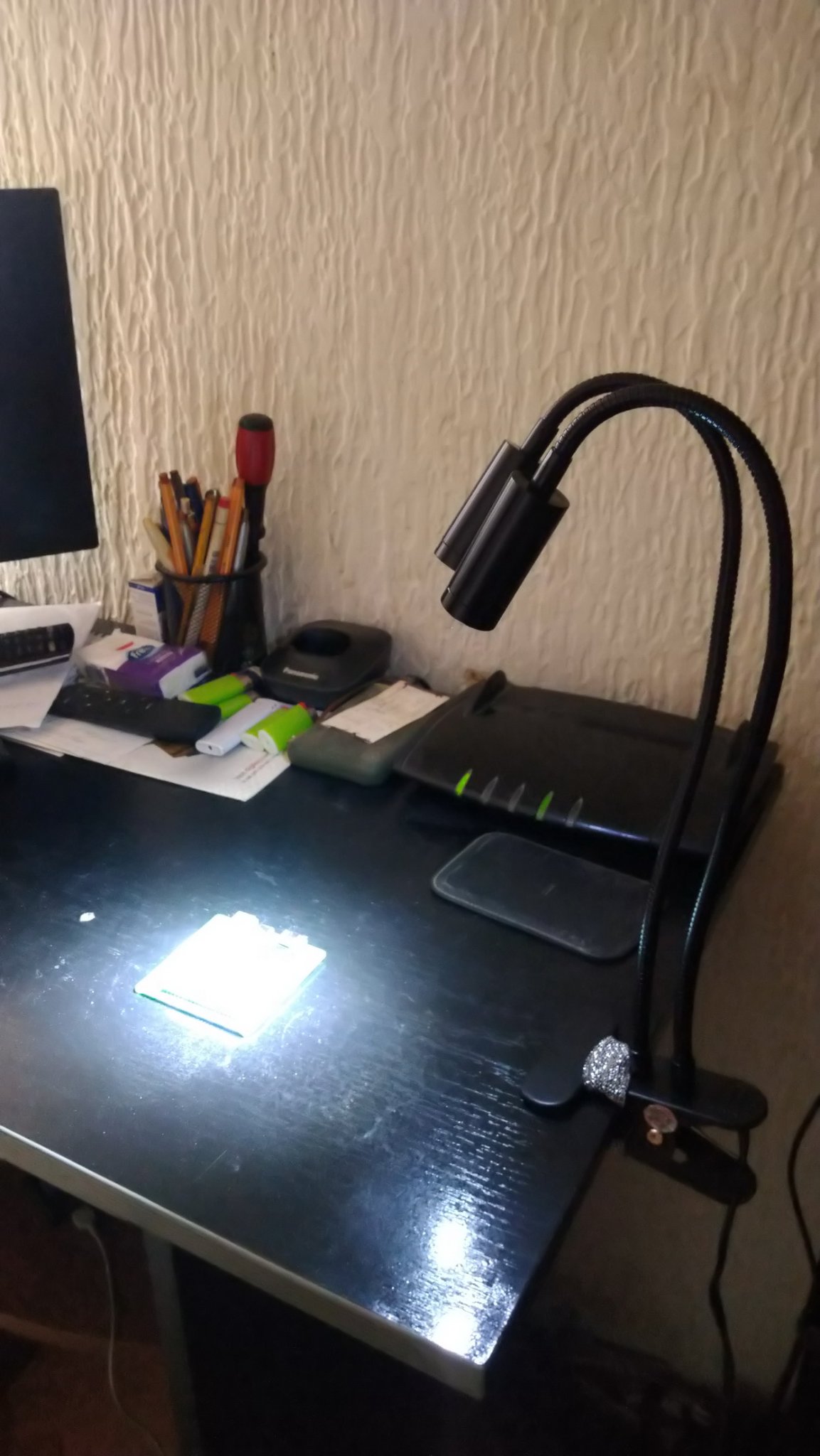

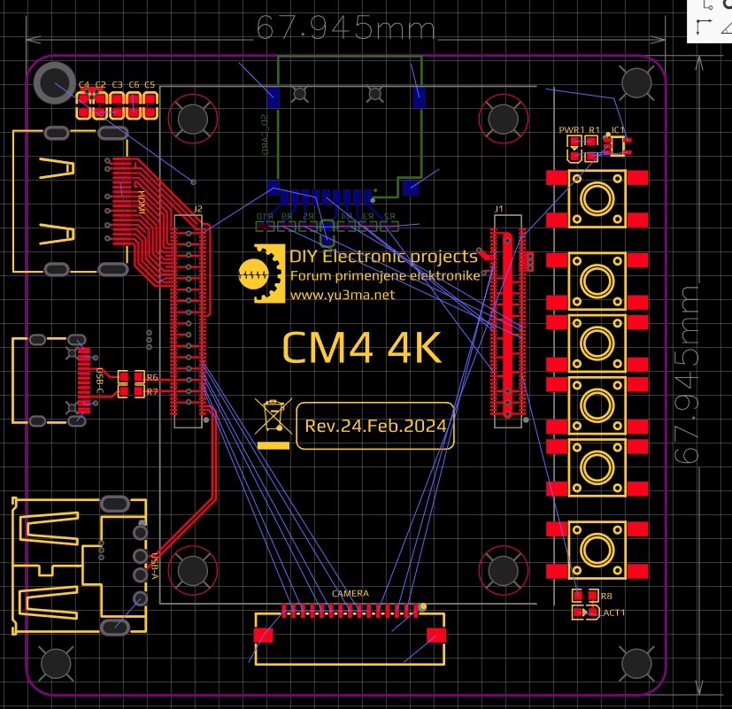

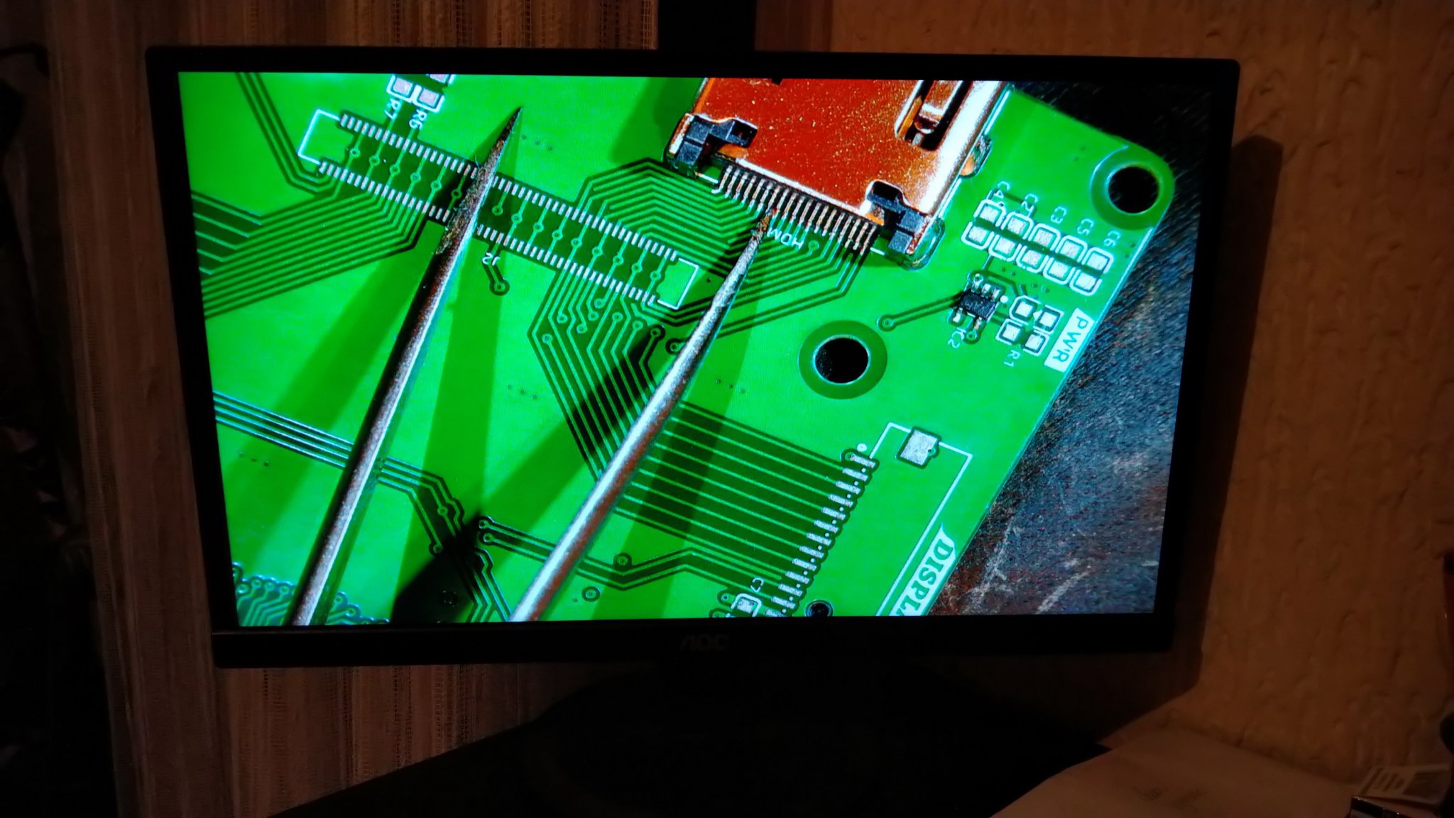

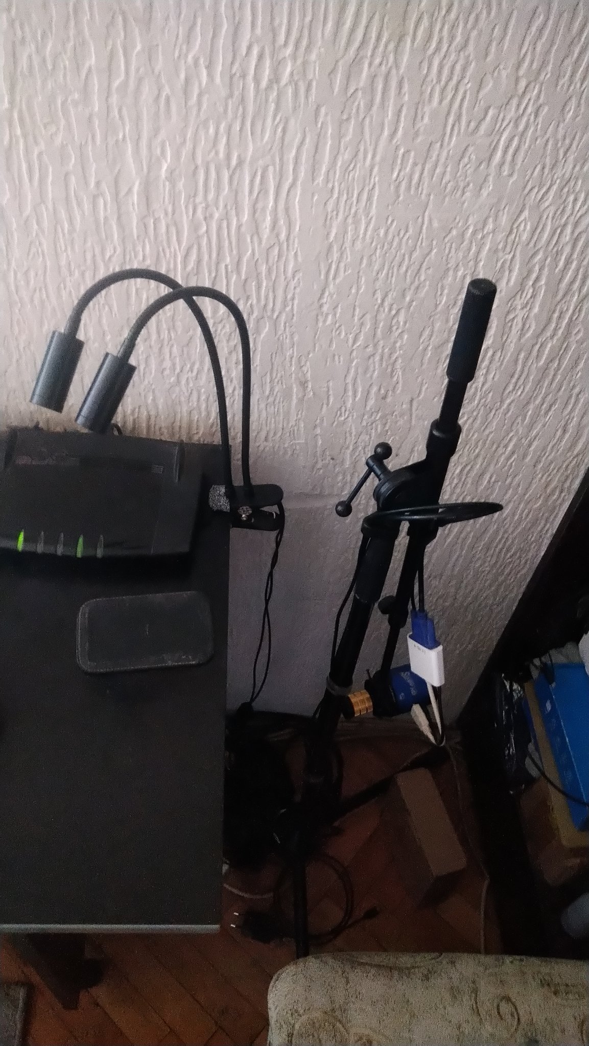

After several unsatisfactory cameras, microscopes and led lights I decided to build my own camera things this way:
Camera and microscope is mounted on microphone stand -> https://www.thomann.de/gb/km_210-9_stativ.htm
Amazing led lights, very good qualitty -> https://www.aliexpress.com/item/32989490586.html (I decided not to use direct vertical led light like ring led lamp, direct vertical lights produce huge reflection, so I decided to buy something which will not light strictly vertical but from an angle, this one is ideal and nice quality. Polarising booth and things is well done : ))
Auxiliary barlow lens -> https://www.aliexpress.com/item/32809788262.html
Amazing microscope -> https://www.aliexpress.com/item/32916828145.html

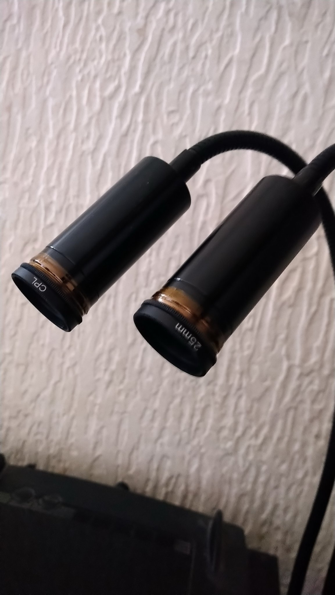

3x CPL filter 25mm -> https://www.aliexpress.com/item/33012338593.html filters will be mounted on booth led lamps (with help of thermal tape) + one to microscope, so that all 3 filters can be manualy adjusted to get the most of the polarised light

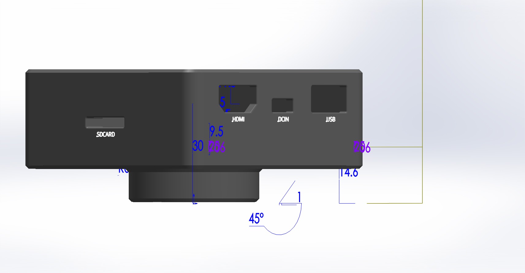

Camera -> https://www.aliexpress.com/item/1005006236848544.html , I'm not satisfied with camera, I'm cheated, seller tolds about IMX sensor inside camera but sensor is Panasonic, not bad but I decided to make my own camera, based on RaspberryPi CM4 and RaspberryPi high quality camera those one with C-mount.
Diy camera filer removal https://www.raspberrypi.com/documentation/accessories/camera.html#filter-removal
Filter will be put back to my own diy enclosure and camera will be mounted into enclosure including CM4, will contain also an wifi antena, usb, hdmi, sdcard... : )
Hope this help somebody to decide the right thing for their work.
This is without CPL, no reflections and not bad at all : ) With pi camera and cpl it will become very good.

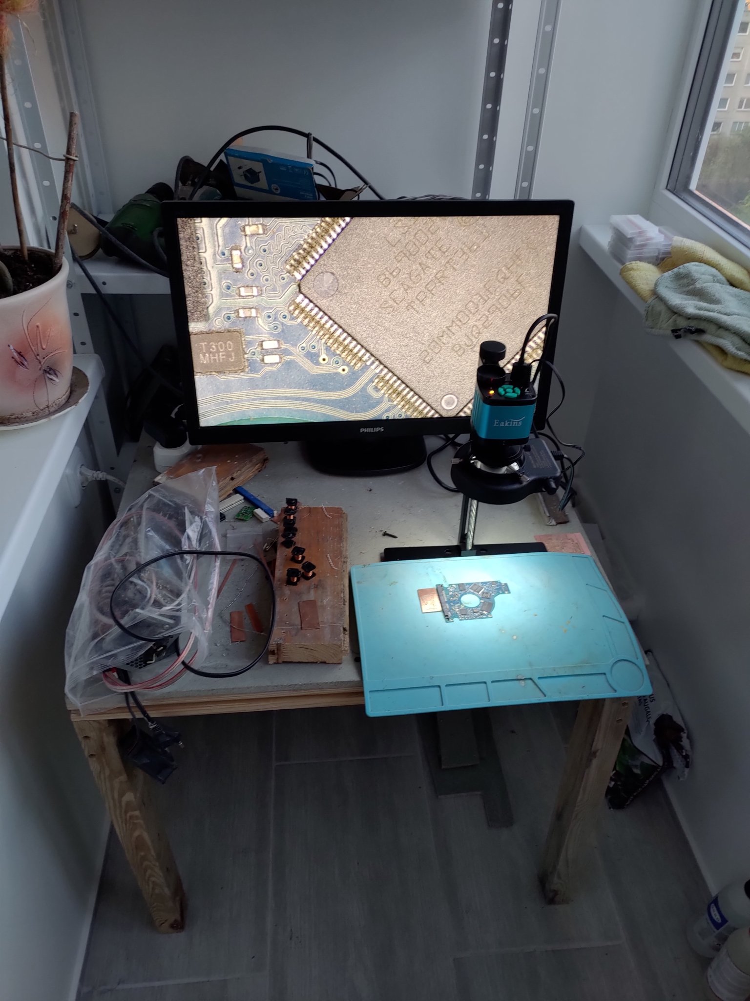

Hello all . Interesting discussion is going there ,so i will add my few cents .
A several years ago , needed to repair cheap a phone , change usb socket . It was so problematic , i've had just magnifying glass 8x with small led light at that time,and no mini soldering iron. It took me entire evening...
Later ,another few years ago ,had to solder LTC3440 ,in vssop-10 package,pins are very close there ,and now i had a tool named third hand .It has two magnifying glasses with adjustable position,whose can be used together, and pcb holder (aligator type clips) ,probably most of us know such tool . It was even more problematic ,and after soldering i was unable to properly see a half day (!) .Optics is doing something like discalibrating/disfocusing the eyes ,i was scared ,that i may had damaged my vision .But at another day it was fine ,but i dediced not to risk again any more ,costs of eyes uncomparably more than any microscope . You can't buy new eyes !
After that i have quickly purchased digital microscope with hdmi output ,camera was rated at 32MP (but who knows the truth) ,FHD,and a bit later pc monitor tft ,probably cheapest one .It's like a day and night . Watching to monitor don't disfocus my eyes .If i try to use magnifying glass , i clearly see vision problems after that . Also i notice no lag on monitor ,maybe because it's not usb based (hdmi probably much faster) . So for me no more optical things ,only digital .
Only two things i would like to improve somehow , it's the microscope ring type light , which makes not all prints on smd parts readable ,some needs to be placed at angle ,that was mentioned by another user too . So maybe led light with adjustable light is an option .Another thing is that camera lens is somewhat close to board ,contains no optical zoom ,only digital zoom .But picture is still very clear ,much better if compare to phone camera or magnifying glass .

See post 26 about CPL filter, if you need to clearly see text on chips you will need polarised light! I had vertical light similar to ring leds, vertical lights simply have reflectios to camera so I decided to buy led which will light from angle, that prevent direct vertical reflections but some reflections still exist, but if you polarise booth led and camera you can remove reflection. I will put two cpl filters on my led lamps and one to camera so that I have 3 locations for filter adjustement. Also see this video moght help you ->
polarised light help to remove reflections, for example the most iritating reflections is from flux, filter nice remove them. Idecided to diy polarised light instead of buying an led ring with polarized light.
Done my diy polarization, very good work! Now I have on 3 items ability to fine tune polarization, on booth two led lights and also on microscope. It is able to remove any reflection and also shadow removal is also possible! A bit of thermo tape is need to fix it on led ligh lamps, good work I'm happy to have this finaly, : )
