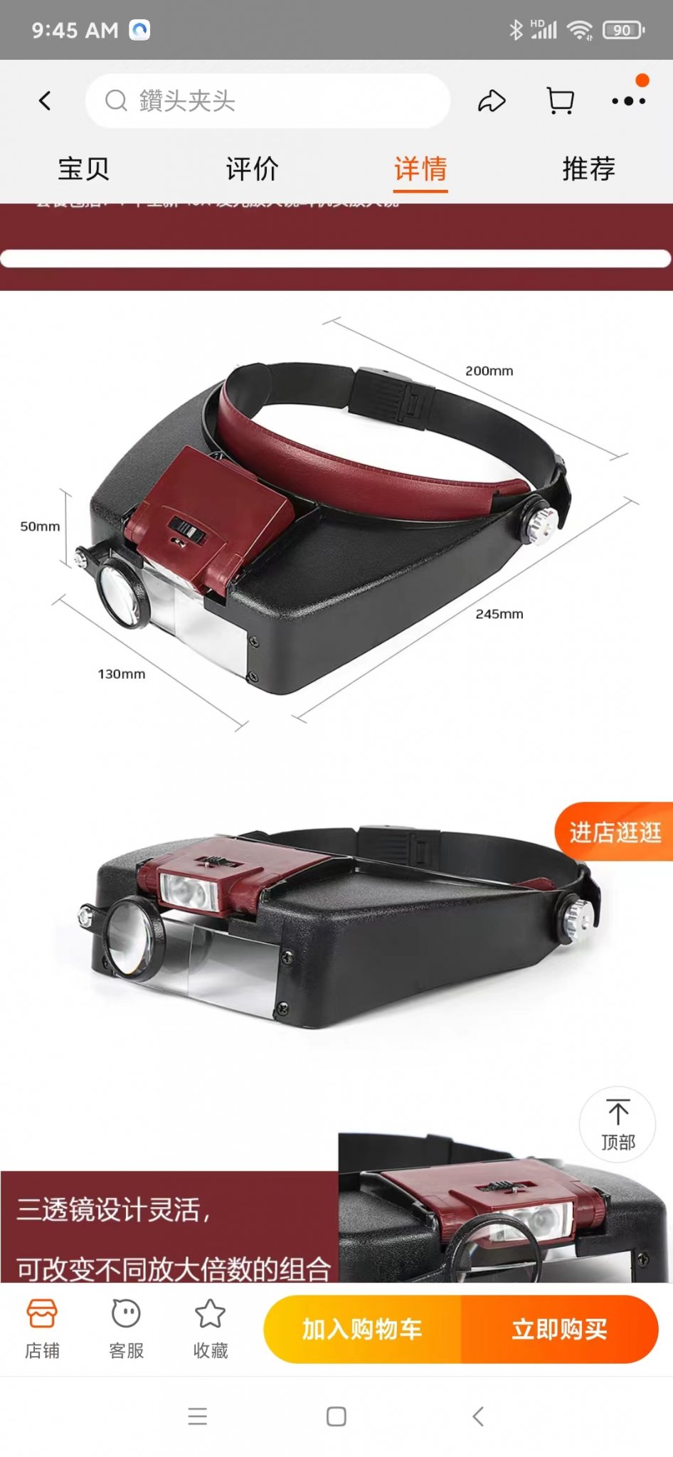

To be honest, I still have some needs regarding comfortable soldering without my heavy Nikon SMZ66. I'm talking about some magnifying glasses frame + light, what I was capable to get from taobao was junk, I even replaced a plastic lense there with the optical multicoated one, I borrowed that from my photo lens. If anyone has a decent example of such type of tool I'll appreciate that.

Sorry for the typo, my heavy(4.55kG) Nikon SMZ660 with 10x and 30x(nearly never used) eyepieces.
100% agree - a digital microscope is suitable for inspection, etc., but not for soldering, where binocular (stereoscopic) vision is MANDATORY.
The best simple head-mounted magnifier I found is the one at: https://www.amazon.com/gp/product/B007CDJKM2/ref=ppx_yo_dt_b_search_asin_title?ie=UTF8&th=1I'm talking about some magnifying glasses frame + light...
Beyond that there are lenses that can be custom mounted to glasses, such as dentists and dental hygienists sometimes use. Quality devices like that are custom fit to glasses frames, kind of like: https://www.orascoptic.com/en-us/loupes I am told prices can start around a $200-$300 for entry-level of professional quality devices. Some include lights. Of course there are also high end units that are much pricier.
that one is plastic again, hence, no fun at all. I saw a similar Orascoptic stuff for surgeries $1000-2000 but they have a large distance of the focus.The best simple head-mounted magnifier I found is the one at: https://www.amazon.com/gp/product/B007CDJKM2/ref=ppx_yo_dt_b_search_asin_title?ie=UTF8&th=1
