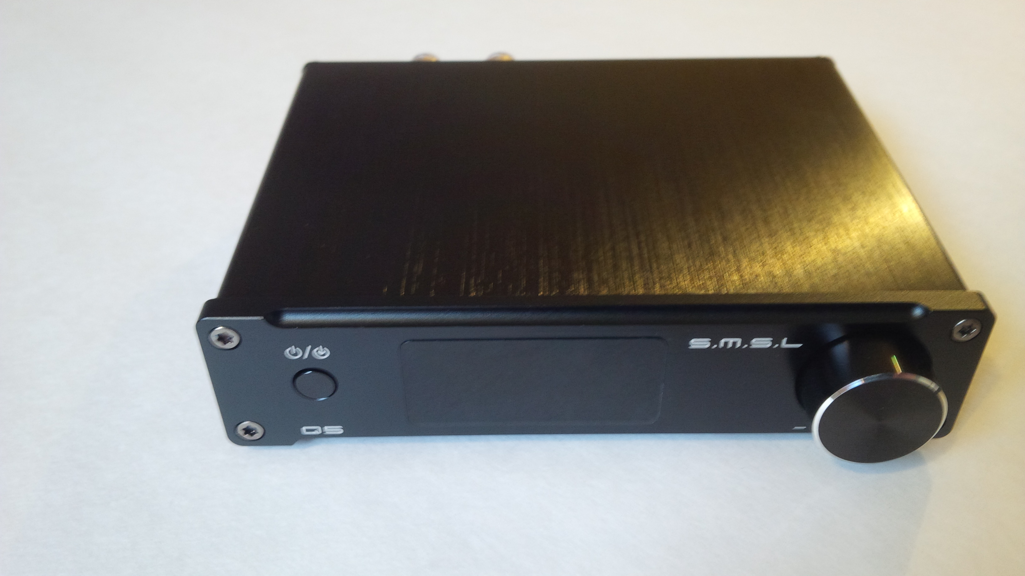

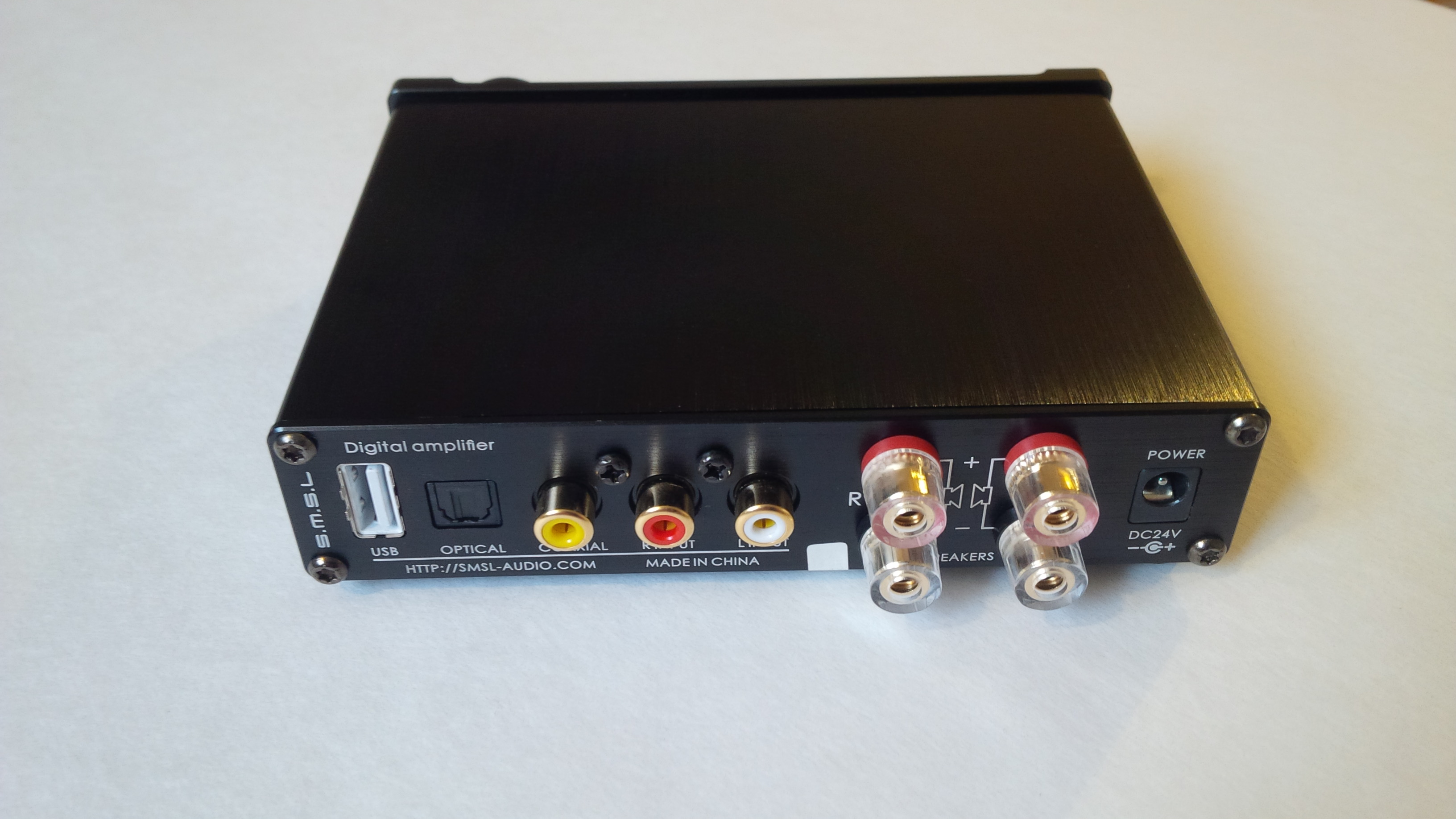

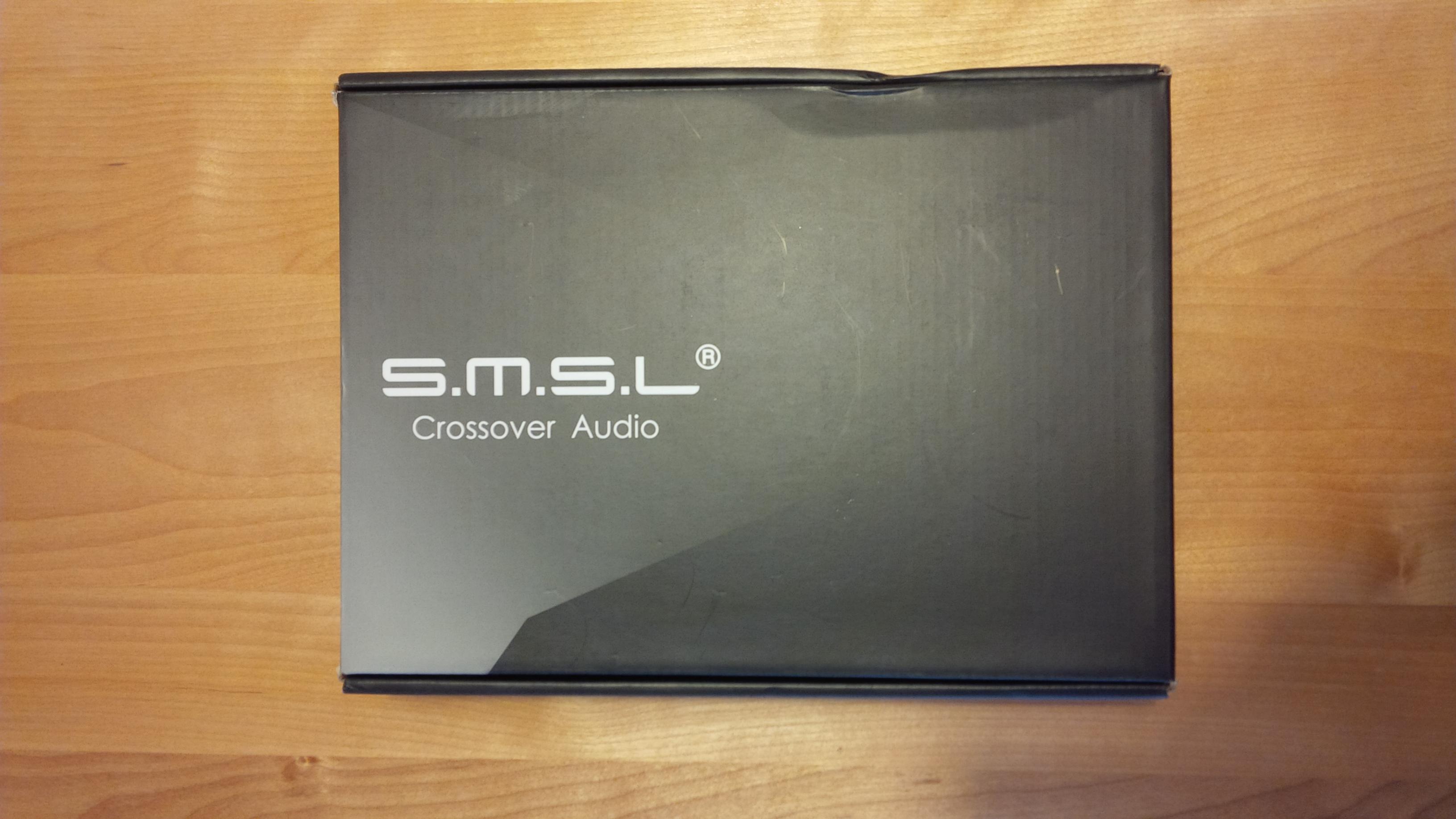

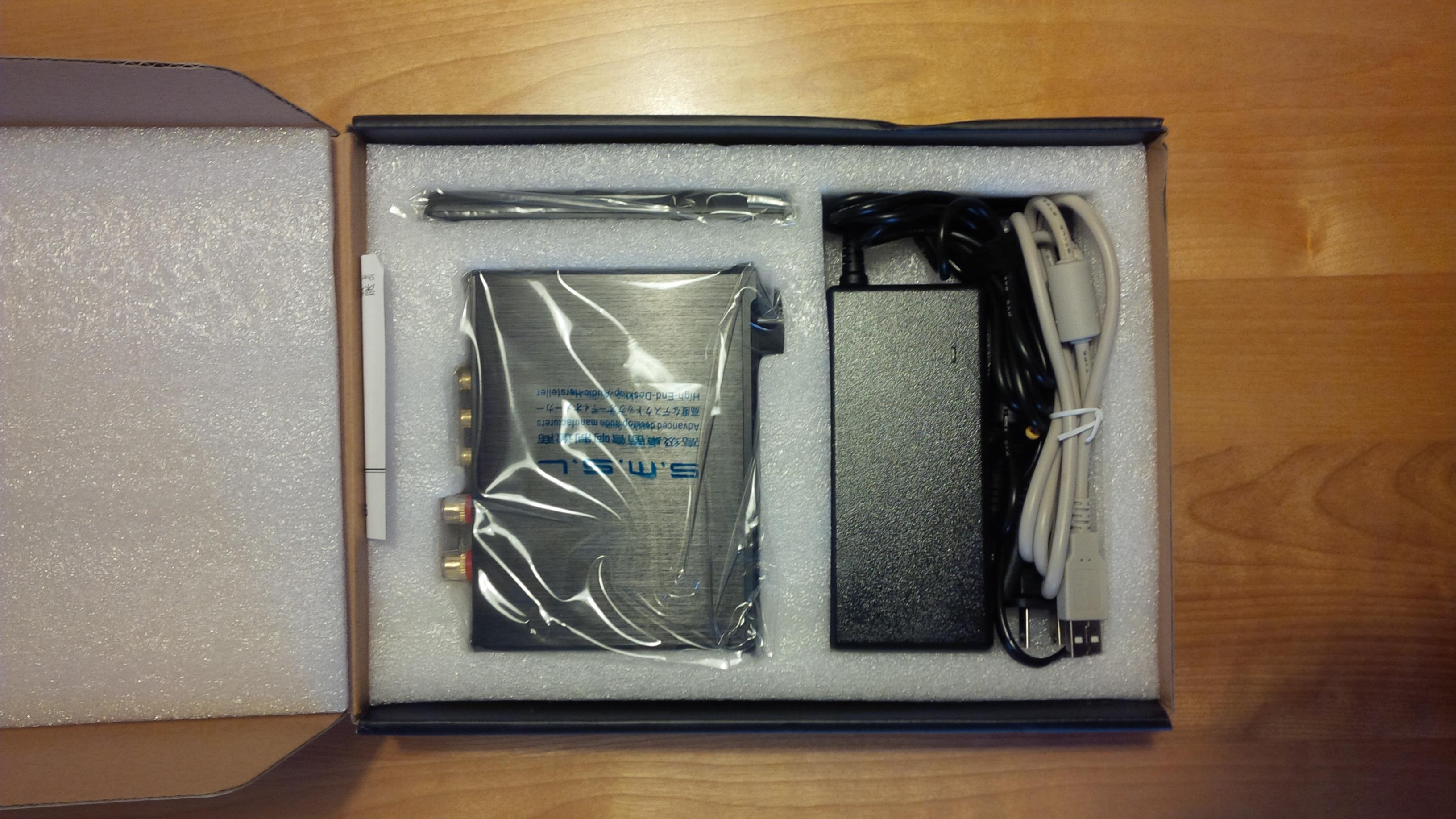

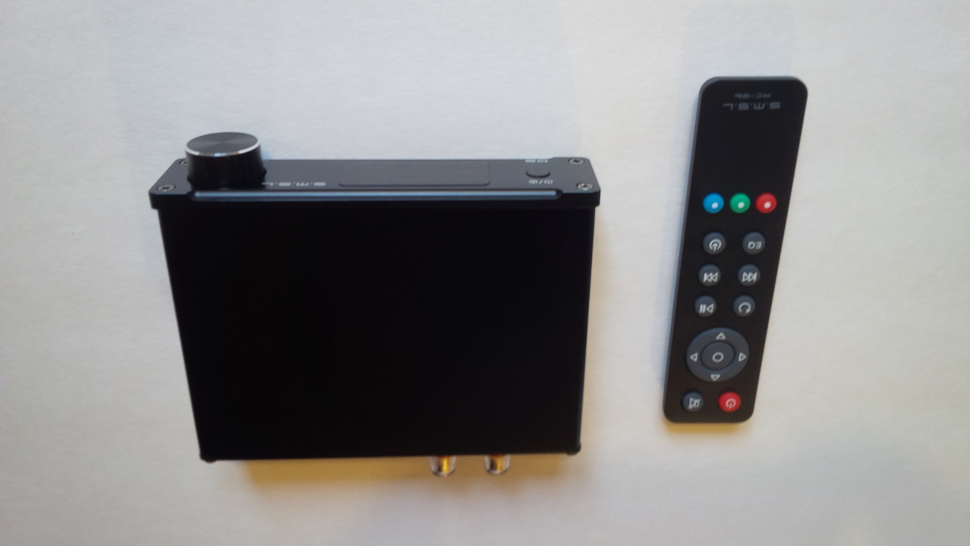

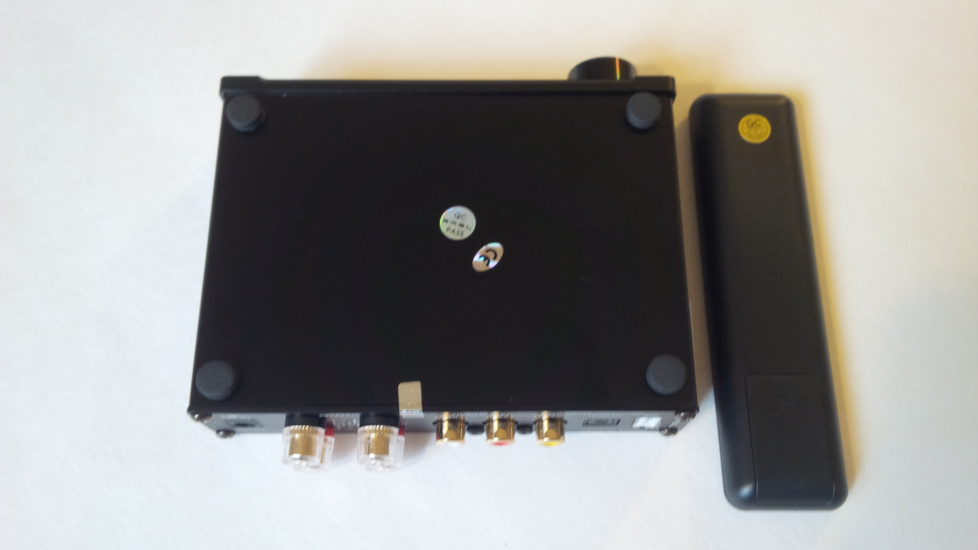

I agree, seems to be excellent value. I've had a Q5 for about a week. Very well packaged for shipping, and neatly presented/accessorized. See pics (pardon the quality on a few of them!).
Sounding good so far, although three times now the left channel hasn't worked when first turned on. Will be contacting the seller. I think it's probably a bad internal connection. Very nicely made judging from the exterior. A Breeze Audio 2.1 arrived today and the SMSL is clearly better finished, though the Breeze is fine.

Update - the left channel of the SMSL Q5 quits working when the amp is turned off and on again. Pulling the power plug for a few seconds gets it working again. I bought the amp from Shenzhen Audio. They've been very responsive. Latest word is that the manufacturer is going to revise the unit. I noticed the amp currently is not available on the Shenzhen site.
I hope that a fix is coming soon, as it's a nice amp. Pain to use right now though.
I've had the missing left channel issue a few times, but only when I've broken the USB connection with the amp powered up. After plugging in another USB source the left channel goes until the amp power is pulled then reconnected.
With (both Raspberry Pi & Cubox-I) USB source connected and switched on, and amp powered up, the fault has never occurred (I need to break the USB connection to trigger it). Unless I'm messing about changing things my kit stays powered up for days at a time.
I've got both the Q5 and Audiobah TPA3116. Both are very good, but I'd definitely go for the Q5 for use with a laptop if there wasn't a decent USB DAC available (TPA3116 with laptop analog output won't compete with Q5). The Q5 can behave a bit strangely if the USB source is disconnected then reconnected, so I'm in the habit of switching it off with the PC and then on again after the PC boots.

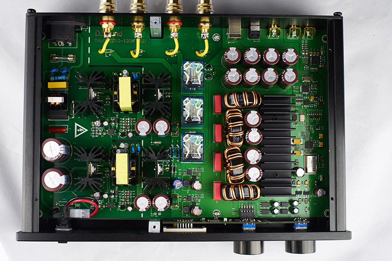

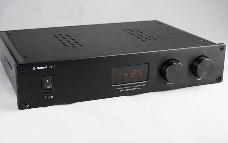

another pure class d amplifier
I found very interesting chinese PCM2PWM amplifier: d.sound d310.
Specyfication:
Distortion: thd + n = 0.008% @ 10W / 1kHz / 8 Ω / 44.1K coaxial input
SNR: 95dB
Efficiency: "90%
DNR: 103db
Power supply rejection ratio: 80db
3 digital input: USB, coaxial RCA, optical fiber
1 analog input: RCA
Digital format: 44.1k / 48k / 88.2k / 96k / up to 24bit192k
Input power: AC 90-240V 50 / 60Hz
Output Power: 80W & 8Ω 120W & 4Ω / thd <3%
SNR: 95dB

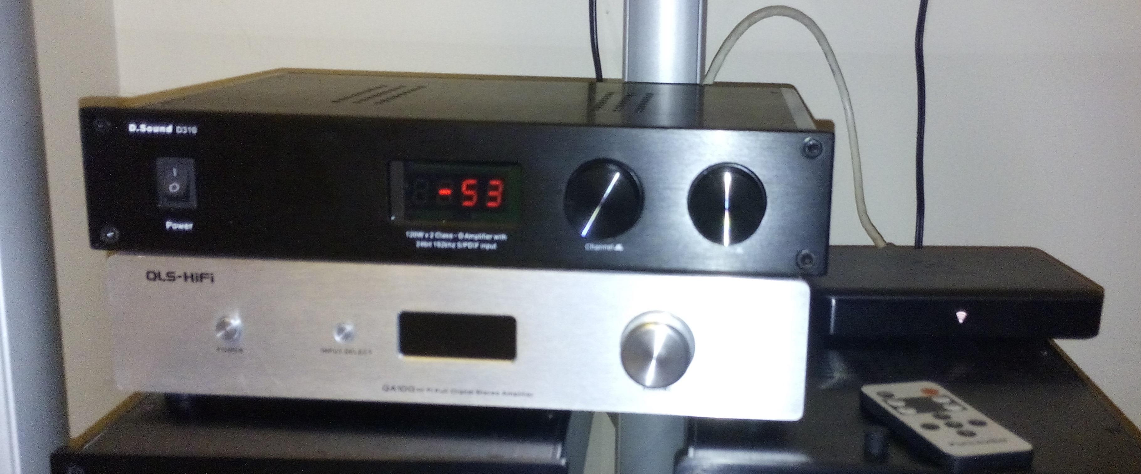

I compare this amplifier with ucd400hrx based amp and qls qa 100. First is typicał analog2pwm amp, but second amp is pcm2pwm. I find d.sound is better than qls in all aspect of sound. Larger base bass, better treble and improved holographic great location.
There is only one problem. This amp is only on chinese market. My friend was in China last week and bought this amp for me.
