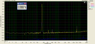

well, i want hear direct-digtal...but i found not much about that, especially about > how does it sound ? < -- but seems, nobody knows...or want to tell :confused:
so i decided, to try myself...
and made a test: i program pcm -> pwm converter, to see, how good this could be;
was some work on a ARM cpu and with standard test, sine wave, looks not bad;
see att. pic

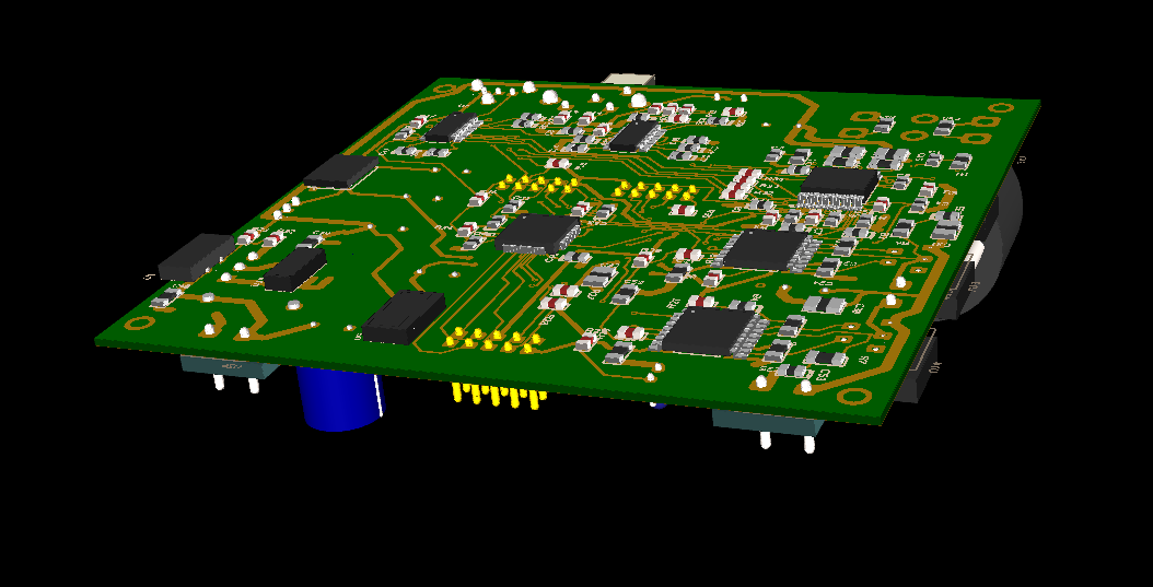

for this, i want a simple setup first - and looked for "ready" amps, but nothing cheap to find;
next is, to build an amp ...i decided for a test the STAxx chips from STM;
at the moment first layout is almost finished, 100x100mm board...see pic.
it has:
- the digital FFX amp , 2 x20W
- supply reg.
- system controller (ARM F0) for volume (filter etc.), IR-remote , LCD display etc.
- spdif opt + cinch in
- usb in
first i will try without biquad filters and much processing, just volume control...
