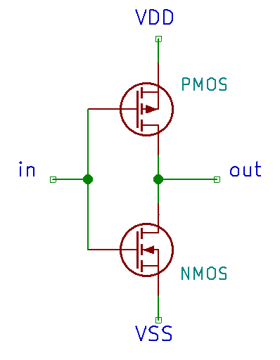

An unbuffered inverter is just an NMOS common source stage and a PMOS common source stage that are essentially in parallel, as in the attached picture (details such as ESD protection left out for clarity). When you drive it with full-swing or nearly full-swing signals, the transistors are switched on and off completely and the whole thing works as an inverter. For small signals around the point that makes the output go halfway between supply and ground, it is just an amplifying stage - like I wrote, two common source stages in parallel.
A buffered inverter is three unbuffered inverters in a row. Since you are used to analogue electronics, you probably understand that a negative feedback loop around a single pair of paralleled common-source stages is easier to keep stable than a loop around three such stages. With three stages, you have more loop gain and more phase shift in the loop, so it gets more difficult to comply with Nyquist's or Bode's stability criteria.

I'm still rather unclear about the difference of the buffered or unbuffered hex inverter. Will the 'U' variant still be able to provide a high impedance input and low impedance output?
A 74HCU04 inverter certainly provides a high-impedance input. When the input is driven hard enough to turn its MOSFETs completely on and off, it has a similar output impedance as any normal 74HC logic gate. When you use it as an analogue amplifier, the output impedance is much higher than when you switch it completely.
Suppose you would use 74HCU inverters in a circuit like you posted. There is always an inverter connected as an analogue amplifier followed by a second inverter. The first one may have a highish output impedance, but as long as the swing at its output goes from close to ground to close to VDD, the second inverter is driven pretty hard and has the usual 74HC* series output impedance.
Practically, the main difference between a 74HC04 inverter and a 74HCU04 inverter is that a 74HC04 inverter has a higher voltage gain around its trip point because it internally consists of three inverters in a row rather than a single one, and a 74HCU04 is much less prone to oscillations when used as an analogue amplifier because it internally consists of a single inverter rather than three in a row.
