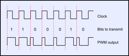

Interesting discussion. PWM can obviously carry 'numbers', albeit serially. How much of that binary serial aspect though is an accident of technological history? Instead of just 0 and 1, more accurate time differentiation theoretically allows for 0, 1 and 2 states in PWM. It's not obvious why representing numbers as 3, 4 or 65536 states is any less 'digital' than a binary representation.
I agree that it is partly historical. I once knew I guy who developed a system of 3 value logic rather than binary. The very big advantage at the time (must have been 70-ies) was that with the same number of 'bits' (trits?) you can code much more values. IIRC he called it ternary logic. Of course never got anywhere.

Digital doesn't have to be binary, although it usually is binary. The key thing with Class D is that the pulse width is not a number, but an analogue, and is (usually) continuously variable.
