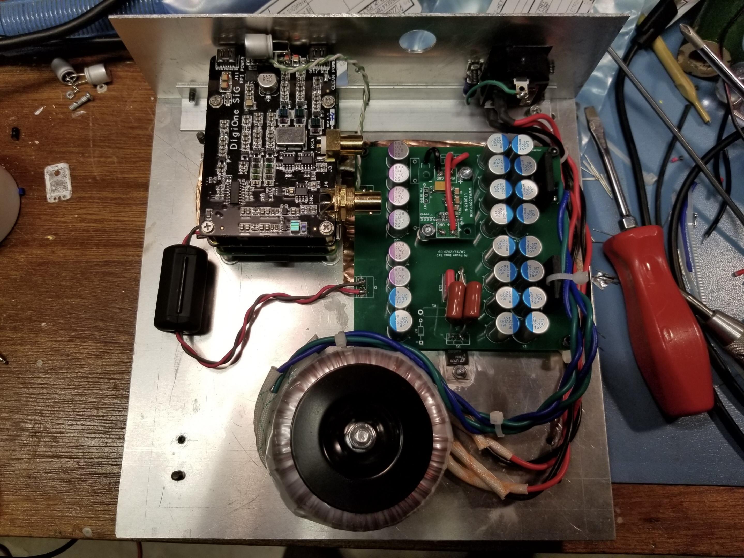

Well this works great for me.
Pi 4 with allo digione sig running moode 6.7.1
Yes, of course i bet its nice. You use a linear psu with very good regulator (lt3045). The digione sig costs more than my whole streaming setup 😉 (without the DAC). But its worth the price, i know. It uses very good clocks with low jitter and isolation.
But you need an external DAC, so i went the i2s way and use a r2r DAC from the past, i just like this chips.
Did you try if there is a difference between the rpi 3 and 4 ? In my setup the rpi4 creates so much emi, that i need to put it behind a grounded screen or i can measure its emi all over the sound system.
