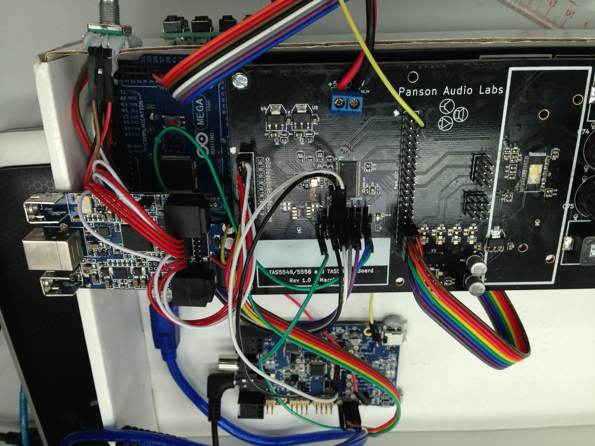

With miniDSP USBStreamer
Here is my PurePath digital amp with miniDSP USBStreamer.

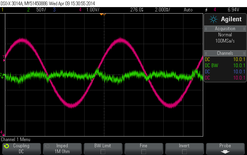

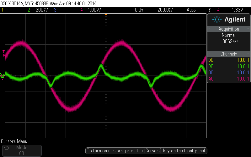

Here are measured waveforms of the digital amp. The amp is powered by a regular 12 V SMPS. A 1 kHz of 2 Vrms was driving a 4 R load (USB to I2S done by USBStreamer). The output was connected to AP Portable One. THD+N was about 0.1 % (BW = 22 Hz to 22 kHz). Distortion residual is shown in the left picture below. Right picture shows 100 Hz distortion residual (THD = 0.022 %).
I will use AP-S1 to send digital signal to the board and get more data later including FFT of the output.

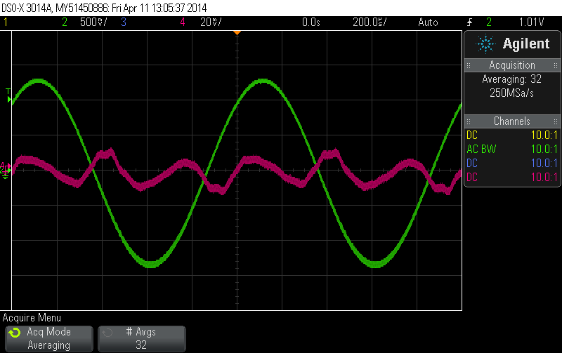

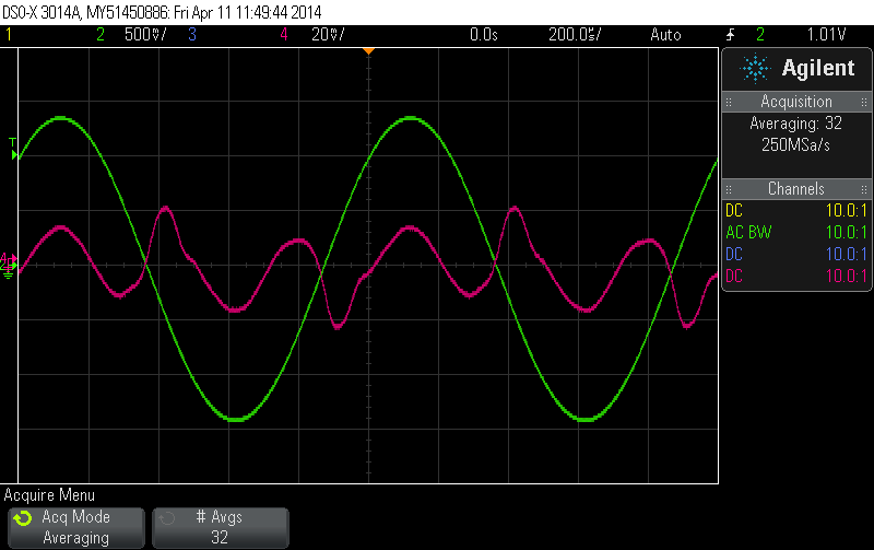

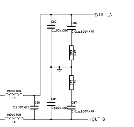

Distortion residual of two different output inductors are shown below. The inductors are Wurth high-current shielded SMD parts. For 22 uH, THD is 0.13% (1 W, 4 Ohm). For 10 uH, THD is 0.097 %. THD difference is not much at all. Distortion residual does show different shapes.
Left photo: 10 uH, middle photo: 22 uH
Filter capacitors: C80 = 2.2 uF (film), C82 and C83 = 1000 pF
