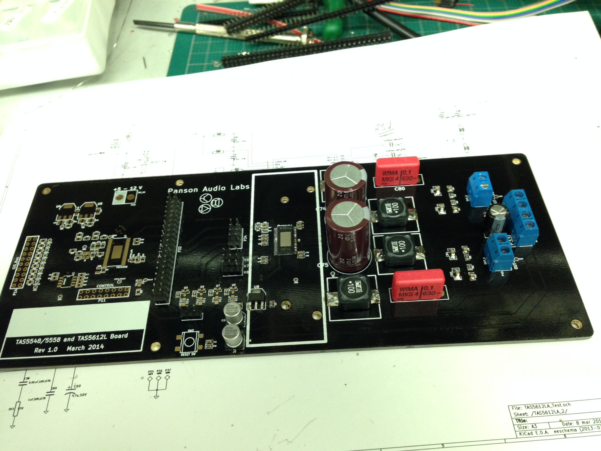

Your suggestion is actually I am working after, more or less. The amp will accept multiple input both analog and digital.
Please see picture of the test board. The board does not have everything but 5548/5558 and 5612.

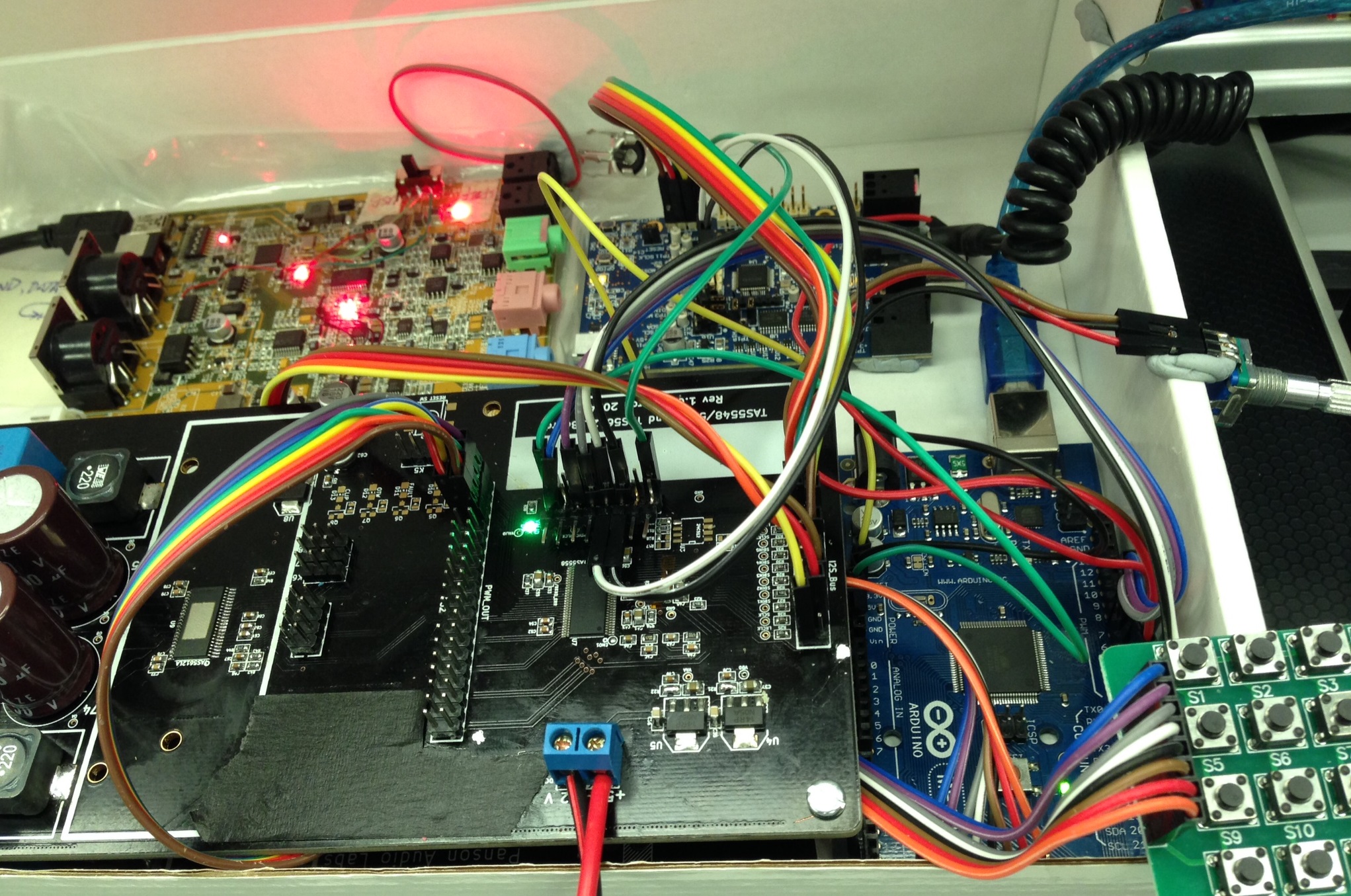

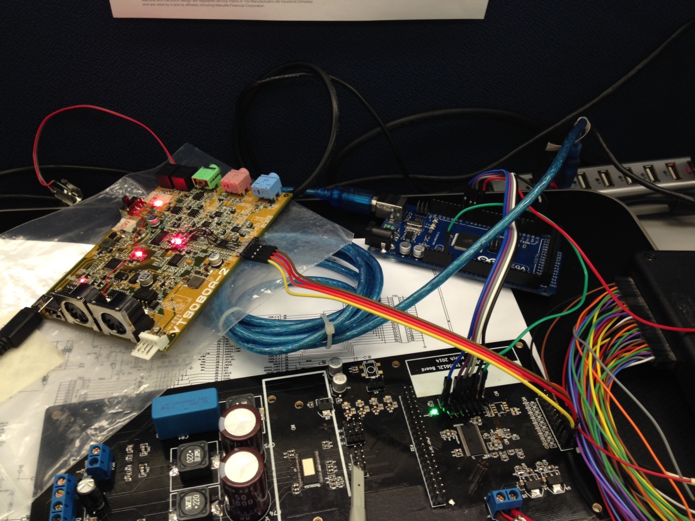

Here is my TAS5548+5612 board operating with an Arduino board being a host controller. Signal source is from VIA VT7136 USB audio streamer. I have tested it for 24-bit, 192 kHz.
foobar + upsampler, VIA ASIO driver, 5548 native 192 kHz processing.

I looked for an older part (TAS5716) initially for single multiple channels. TI suggested 5612LA for new design as 5716 is "old". Now I can do high-power stere😵n the other hand, I need two 5612 for stereo active 2-way (full bridge).
One 5548 (96 k processing) can drive four 5612 (stereo, full bridge) for an active four-way project. What do you think?

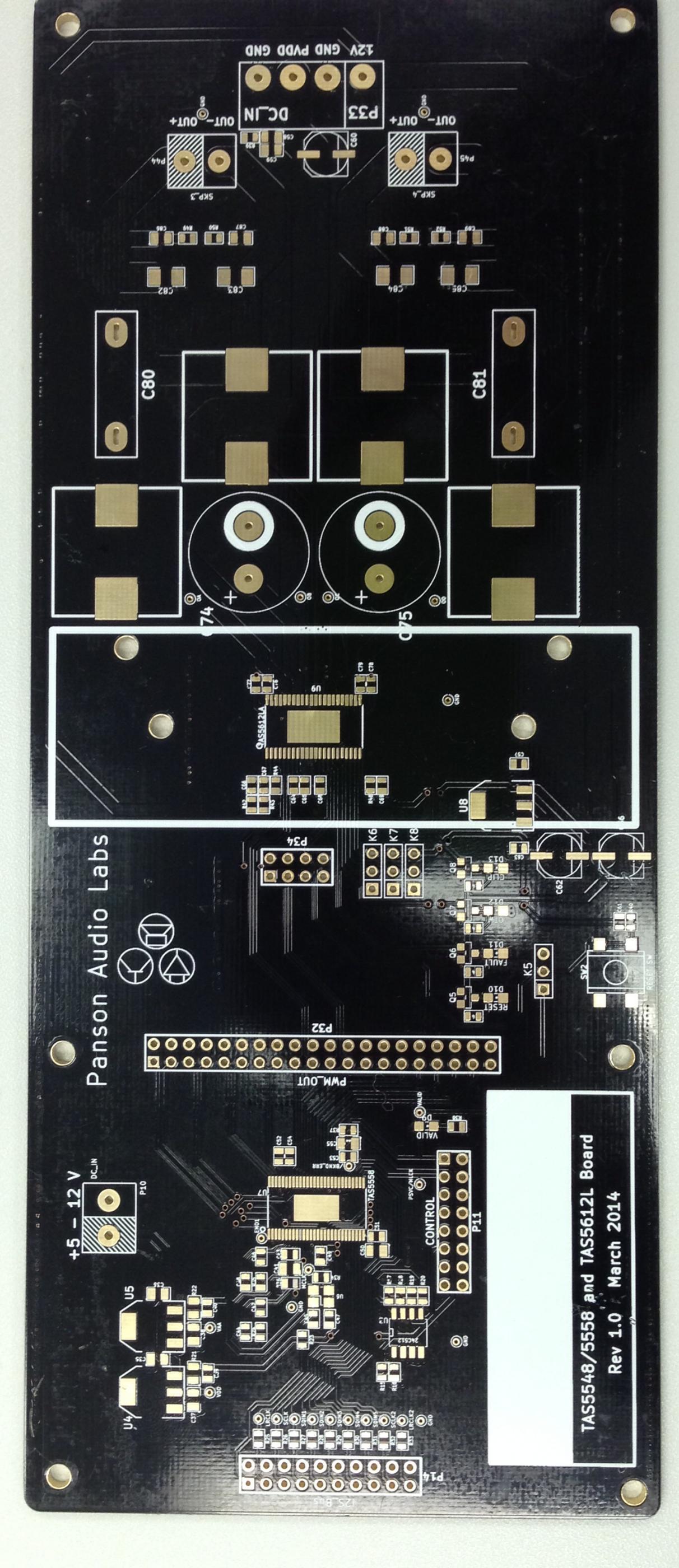

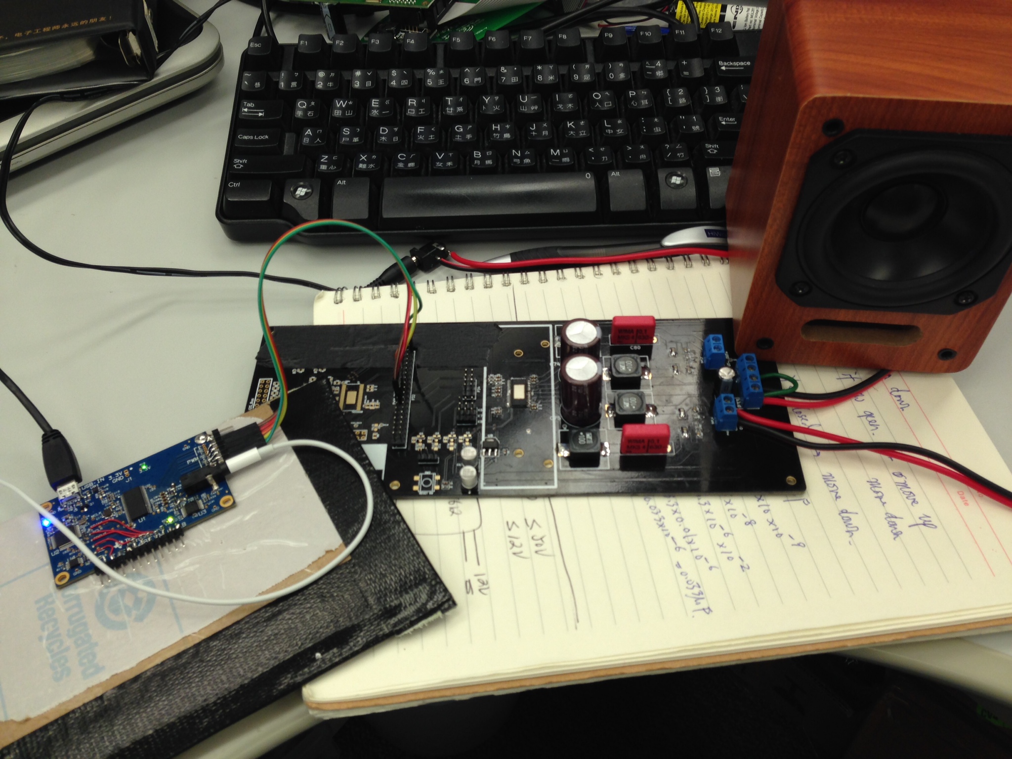

The first version PCB as being tested is essentially flawless. Board size 218 x 90 mm, 2 mm thickness, 1 oz copper, 2-layer gold plated.
I would like to offer 10 free boards to the diyaudio members. If you are interested, simply reply here. You only need to Paypal me US 10.00 for air-mail shipping and provide your postal address via PM.
I will send you schematic and current Arduino code via PM.

I am using Arduino Mega2560 board for this project. Photo shows my latest test setup. A rotary encoder for volume control and a keypad for input selection, mute, etc.
