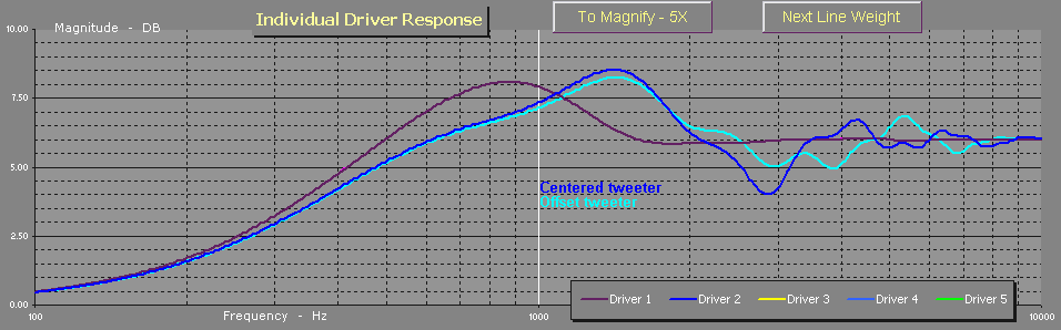

Its because to see it in action requires a small source compared to the
baffle, such that path lengths to the edges are quite similar and reinforce.
(Why the Olson studies are as symmetrical as possible, with a small source.)
(Why you offset midranges and treble units, to vary the path lengths.)
A large pistonic source on a similar sized baffle has very varied path lengths
which smooths the effect leaving the 6dB baffle step effect + usually a mild
hump of around 2dB above that before settling to +6dB.
rgds, sreten.

Interesting. I didn't know that. This phenomenon exists even when the driver is behaving pistonically, I assume?Hi,
rgds, sreten.
an example : http://zaphaudio.com/SR71.html
Bass unit with tweeter in central and offset positions :
I assume the modelling assumes pistonic for the bass / mid unit.
rgds, sreten.

Could you run that past me please because looking at it it would seem the two have different causes, caused by different phenomena with different solutions (except soffit mounting of the speaker).
For starters baffle edge diffraction appears to be largely unrelated to baffle width and results in phantom treble sources at the edge (and possible comb filtering) while uncompensated baffle steps result in a lack of bass in free standing speakers only.
(My own speakers use conical 90deg horns for treble, as most Tannoy DCs do, and are positioned with their backs on the wall hence I did not address either problem and the speakers are +-2dB at the listening position at 1/3 oct resolution.)

As planet10 says, it's different manifestations of the same phenomena, and it can be hard to visualise conceptually.Could you run that past me please because looking at it it would seem the two have different causes, caused by different phenomena with different solutions (except soffit mounting of the speaker).
Try this description by Linkwitz to see if it helps, as he describes it in terms of a time domain phenomena, which is what it really is:
