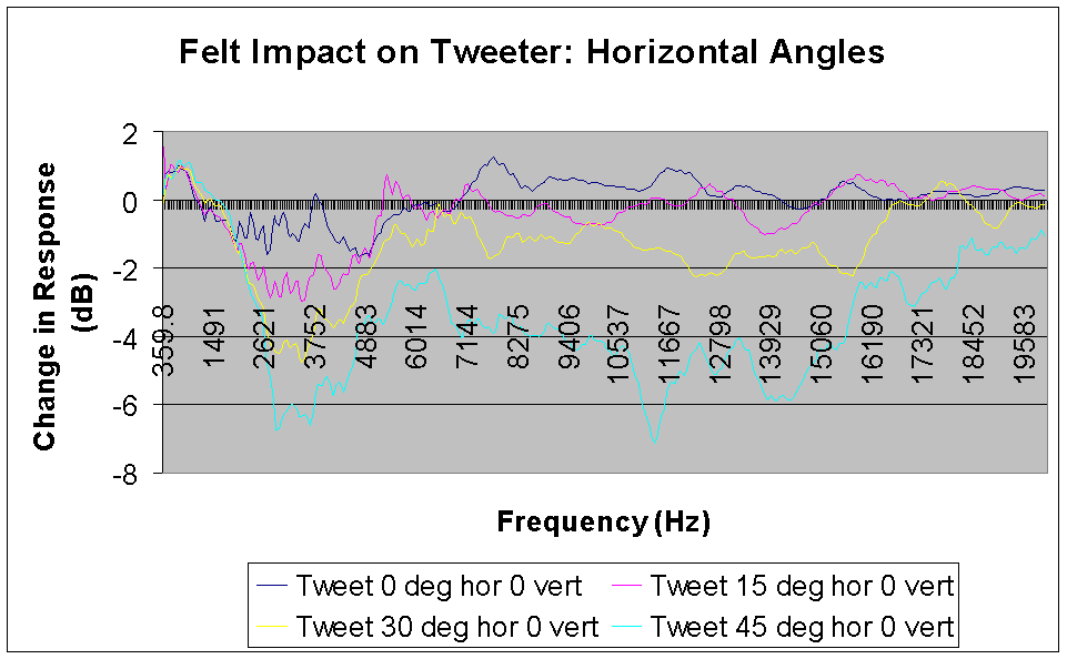

But in my testing, damping of the wave as it propagates across the surface of any material such as felt/foam is minimal. The wave must pass through the material to be useful. This is why I often now only use strips of felt. Fully covering a baffle maximizes the effects, but with very rapidly diminishing returns.
Dave
Fully felt covering baffle and relatively small aperture to tweeter provides some strong off axis absorption down low to help control tweeter bloom. I think what we hear from felt is as much this as just diffraction control.
Attached a measure/experiment I made on one of my speakers with felt (this is the mcmaster carr stuff) covering the front baffle around tweeter, to illustrate.
