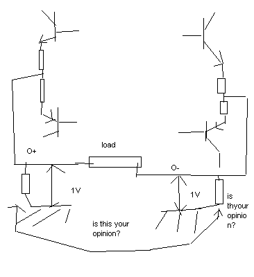

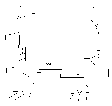

When you built X amp like Susy, both input and feedback point is taken for setting gain, so its more difficult to set 0VDC by putting R to ground in differential. If both bases of differential has resistor to ground point, any slight difference in those transistors will result in common DC offset.
You got common 1V offset compared to real ground. There's 2 help for this. One, put small valued R (but big wattage) like 100ohm in both outputs. With this, the 0V reference is "forced" to set in the outputs, to help the R in the differential setting 0V. It is possible, because in the whole X amp, the system is kind of "floating" wrt to actual ground.
Two, you can put "magic resistor" from each output to the CCS in differential.
If you search in passlab forums, this common offset has many discussions.

Yes, exactly like what you draw. Look for questions about DC offset in AlephX thread. Ah, I remember, the way to set 0DC offset is in the AlephX thread itself.
