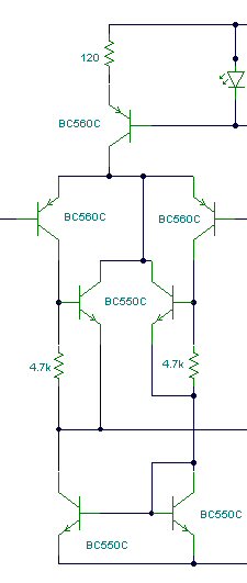

It is interesting. How can I use differential front end, but have big 2nd harmonic? In what part of differential should be modified?
There are at least two ways to make a LTP (long-tailed pair) distort. You see, it rather relies on the transconductance of each transistor being relatively constant. This usually means making the bias current of each transistor much larger than the signal current variation and making the bias current independent of common-mode signal.
To make the thing distort you do the opposite. Make the bias and signal currents of a similar size AND/OR put a low resistance in the tail to make common-mode signal vary the transconductance. This applies to both FETs and BJTs, although gm vs Id or Ic will have different characteristics. You'll have a significant common-mode signal if your amp is non-inverting and uses negative feedback.
[By the way, you can make an accurate analogue multiplier by applying one signal across the diff pair inputs and use another signal to modulate the tail current.]
What is the meaning of LTP? A differential with resistor current soruce?
Maybe Millwood wanted to say the single transistor input have wider bandwith, not faster. It is true for current feedback design, they usually have wider bandwith than voltage feedback.
How about DC offset in current feedback design (like in Borbely preamp). Is the DC offset as not as stable if we use ordinary voltage-feedback differential?
the single CE input stage with a resistive load delivers TWICE the transconductance of a similarly loaded diff. stage.....all other salient details being constant
Is this because in single transistor input all current are going into 1 transistor, while in differential, the current from CCS have to be divided to 2 transistors?
Aha, this is interesting. I have been wondering what this design like I attach aiming. At first I think it is to reduce the needed current entering the bases of differential (if the bias at BC560 is only 150uA, the base current needed certainly very-very low if we consider HFE).
But here Tradebam gave good hint about it. Is this design aiming at having big 2nd harmonic, because the bias at BC560 maybe as low as the audio signal entering the differential?
I liked this differential design. It can handle big bias current, but MAYBE it have great sensitivity, because signal is entering a very low bias (150uA) transistor.

Yes, the interesting thing about using mosfet for differential is that we can run very high bias, without requiring DC current at the gate. But mosfets still have C input, that have tobe charged/discharged. It results in somekind of "AC current" needed to activate mosfet's gate.
What do you think about CFP differential like in post #17? We can have big bias differential with bipolars, but the input will need very low base current, due to very small bias current at the BC560.
