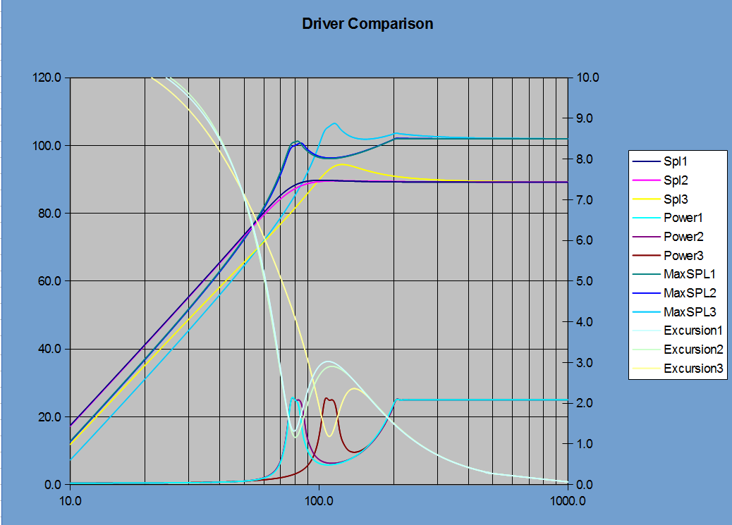

Your actual F3 numbers are at about 72, 74 and 90, respectively, for those boxes. Here is a graph that gives response, power handling, excursion and max SPL for those three boxes, assuming a power handling of 25Watts. Excursion is on the right axis and everything else is on the left. As you can see, the smaller box is not a major change in anything.
If you start with a flat example and tune lower in the same size box, the response will droop, if you tune higher it will peak (as in your third example).
If you change box size and nothing else, you will gain (or lose) 6dB of port output at the port tuning frequency for every doubling (halving) of box size.
Those two last statements are your two main degrees of freedom in the ported system. They explain (almost) all frequency response behavior. Get a program with graphing capability and try them out.

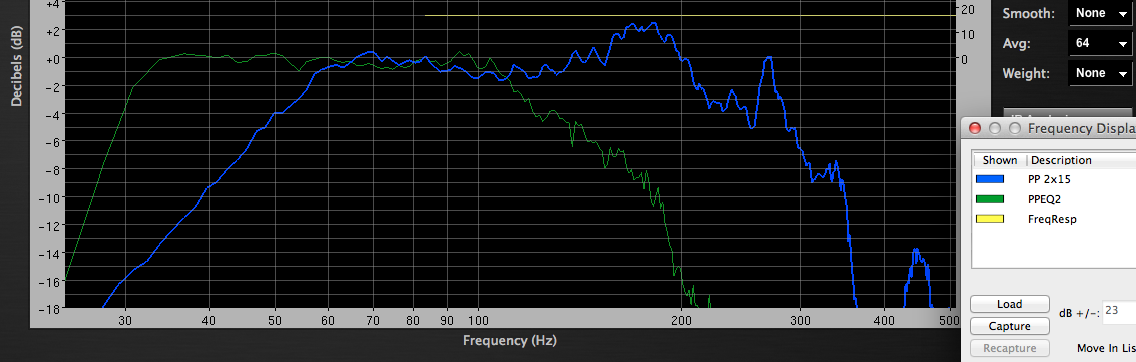

A "classic" TS ported alignment shows a "4th Order" (24 dB per octave) roll off below Fb, but actual acoustical ported box response can range from a bit steeper than that to around 12 dB per octave. Still have yet to build a ported box yet that actually has a measurable roll off at 24 dB per octave.
Here is a ported box (39 Fb) just finished that measures around a 14 dB per octave rolloff below 58 Hz, with EQ -3dB at 30 Hz.
