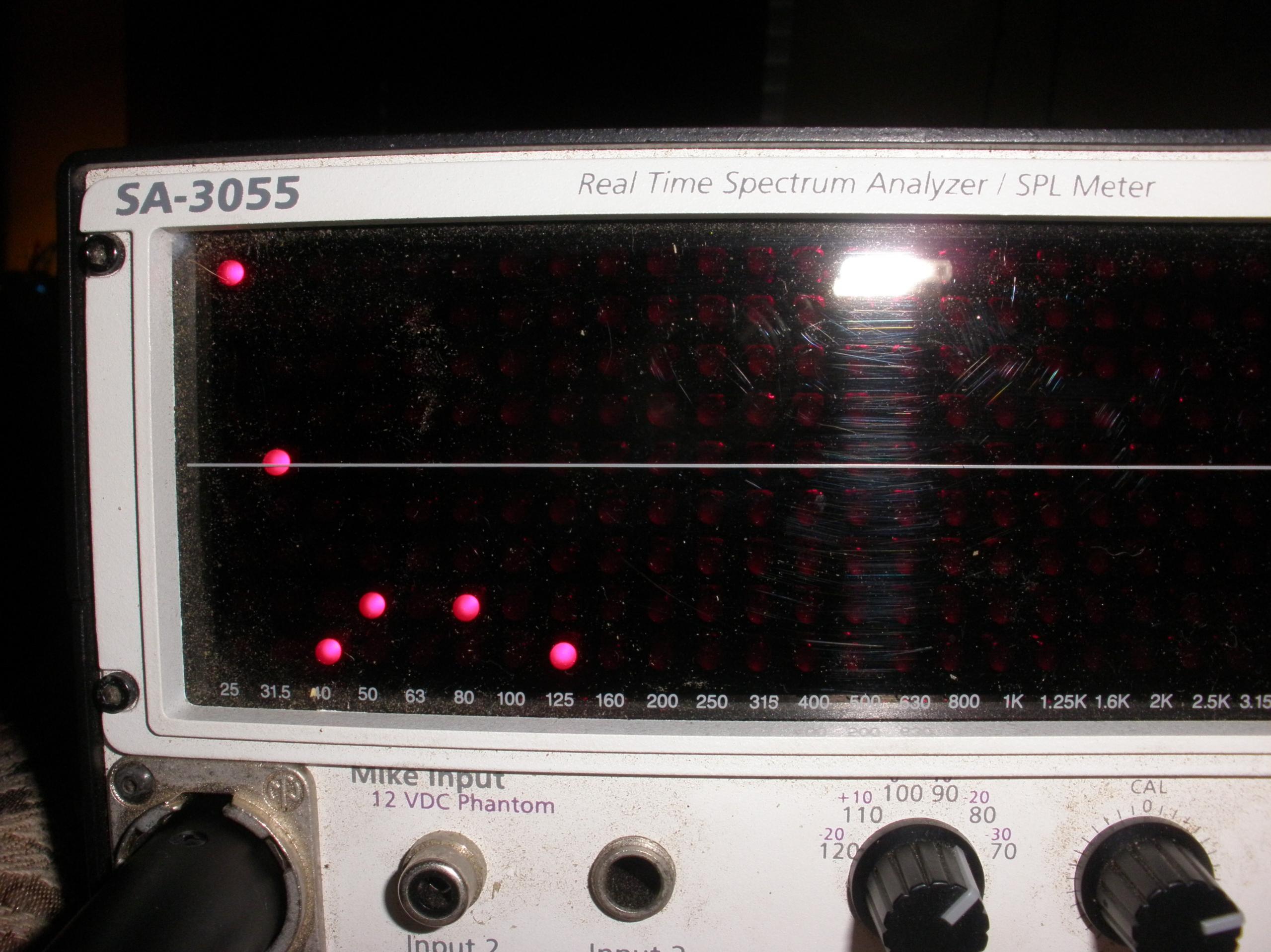

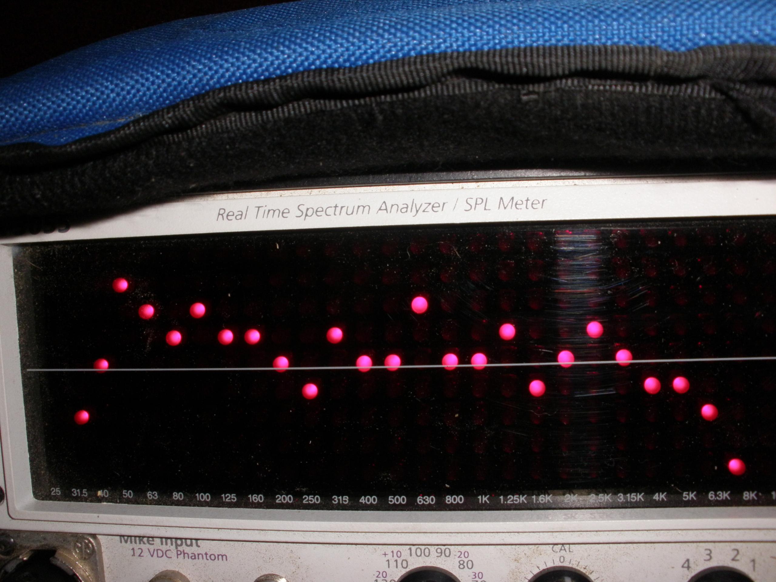

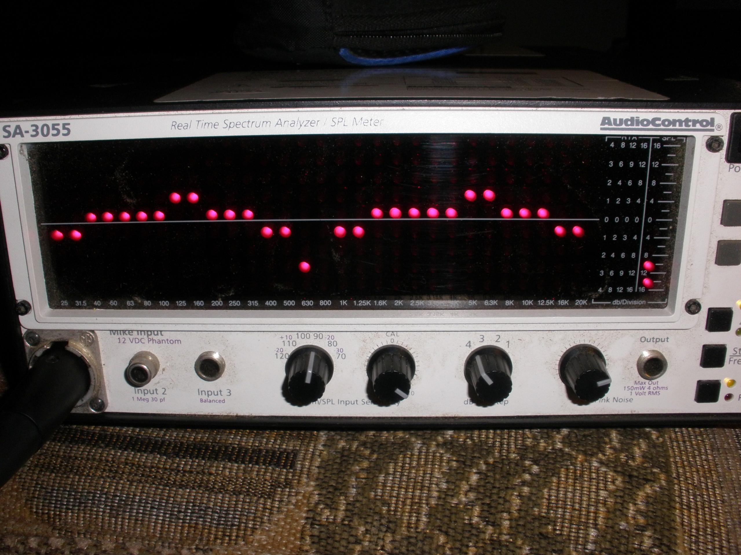

on post #297, that was pink noise with the mic about three feet away mid level high on a stand, i was very impressed when i compared it to my traditional round speakers which sound awful to me now, it like going from driving a VW beetle( old one) to a Viper, there is no substitute period.
RTA update

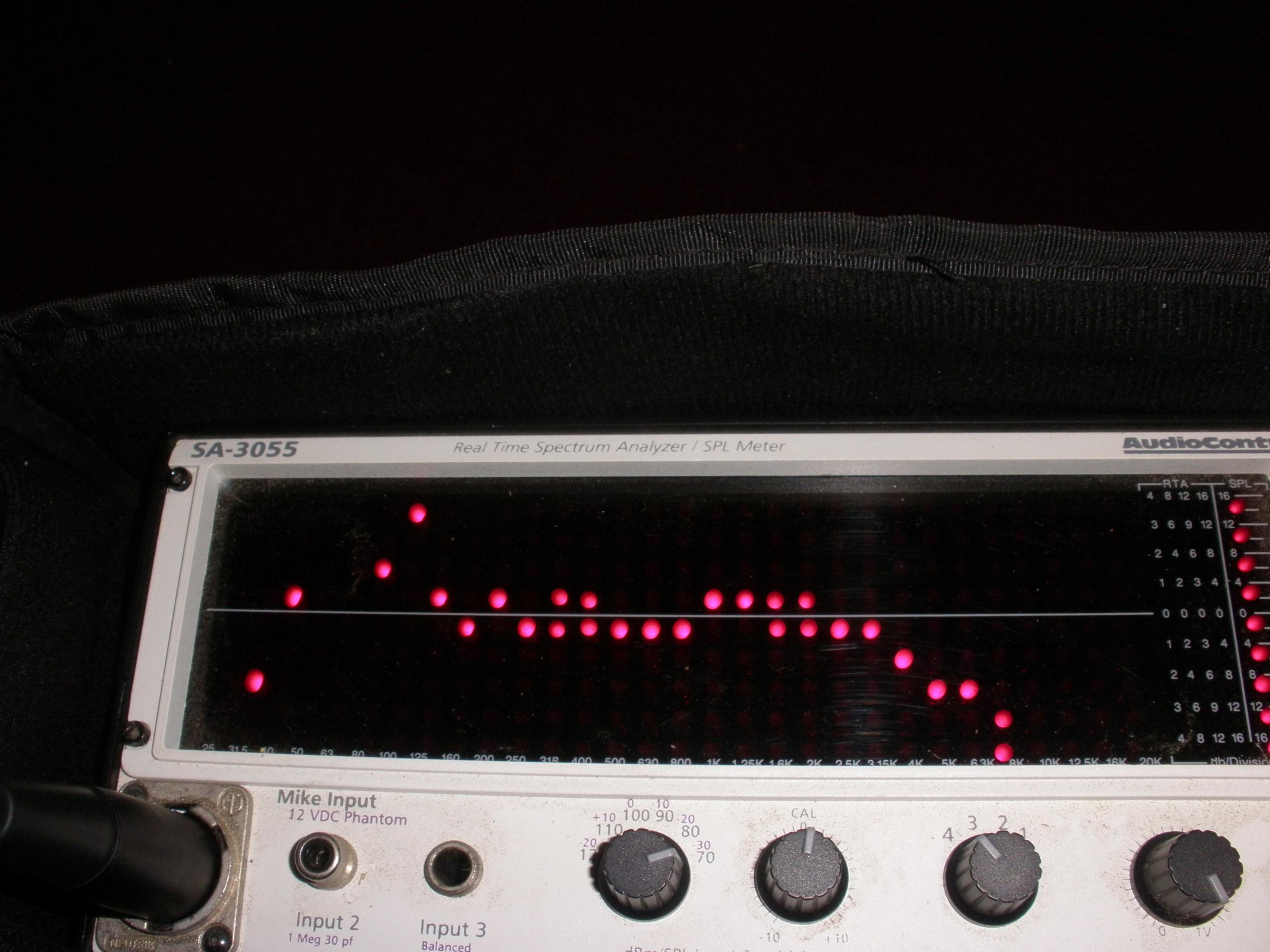

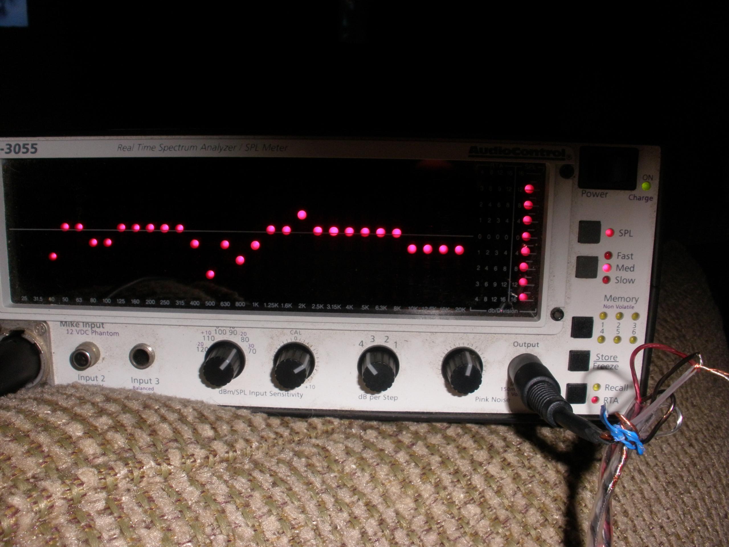

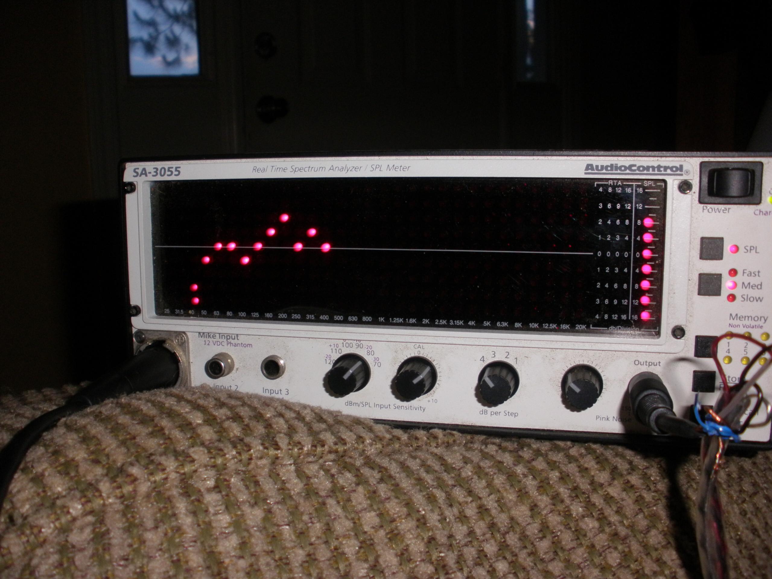

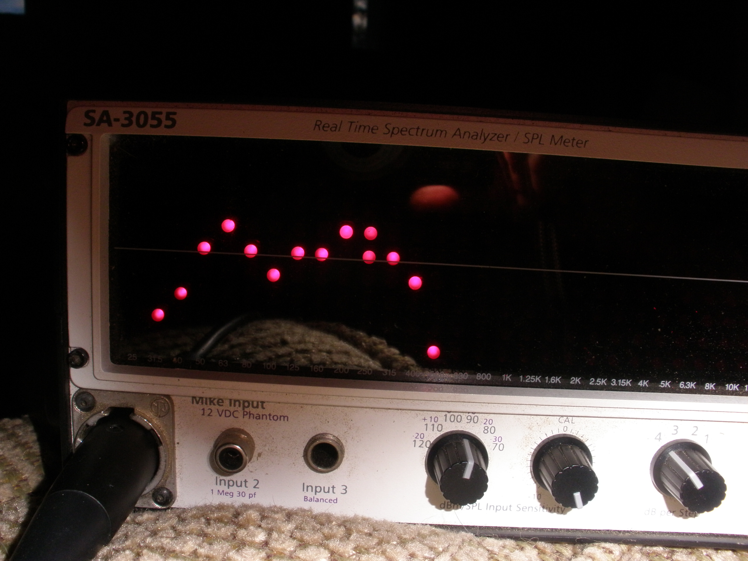

sorry i have not posted sooner, back injury. either way, Here are the other pics, I have not figured out how to describe each pic, but will have a number,
All measurements are done about 9' or 108cm. with the mic on a camera podeum.
> 5090422
pink noise with the meter set at 80-100db, callibration a litttle high to show cross-over points, very impressive, flat from 25hz thru 25k, nice drops at 24 db slope, the curves merge perfect.
>5100432
brown noise, not very familier but tested any way, Ger sent this to mw as well the pink noise, to have or rather post how flat the hybrid planer works. Obviously, most people choose pink noise for testing, thats what i suggest.

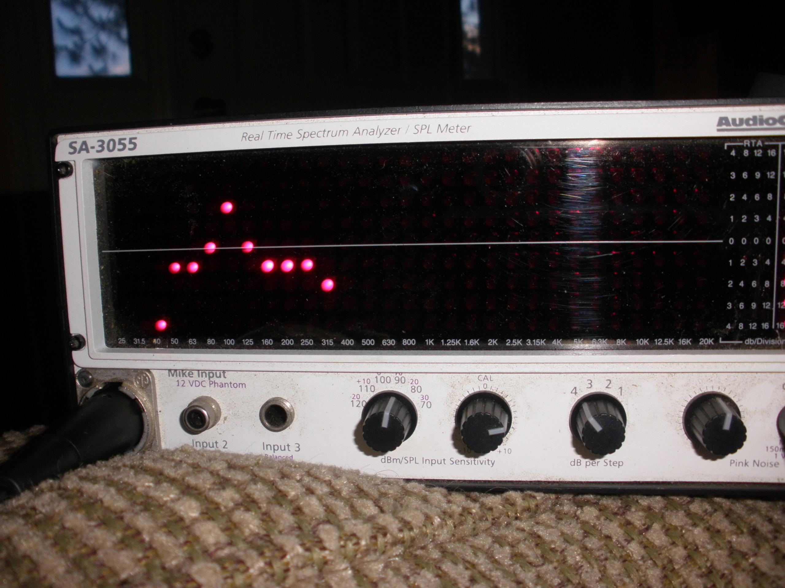

>5100433
this one is awesome, it blew me away, this is a test tone @ 18hz from a CD, this what i picked up at 9" or 130cm away, only from one. the entire house was shaking, dishes in the kitchen going crazy, the woofer was going nuts, but no distortion, i went on testing the tl, but will have to post more pics, as it was getting late and i do have neighbors.
The first pic was something i have almost never seen in my line of work, a flat responce is allmost impossable using tradtional round speakers for the entitre frequency range. I think i posted a pic of that as well. I will post it again here, save some time,
same tone same distance.

Hi Mavric,
You might try measuring just the ESL by itself, no woofer. Then measure the woofer by itself, no ESL. This should give you a clue if the dip around 630 is just the dipole roll off of the ESL, or an interaction between the woofer and ESL.
I'm not sure how you have your crossovers set up, but you might find that if you swap the phase of the woofer, the dip at 630 may fill in.
I will follow up this week end with that specfic test, thanks for the heads up.

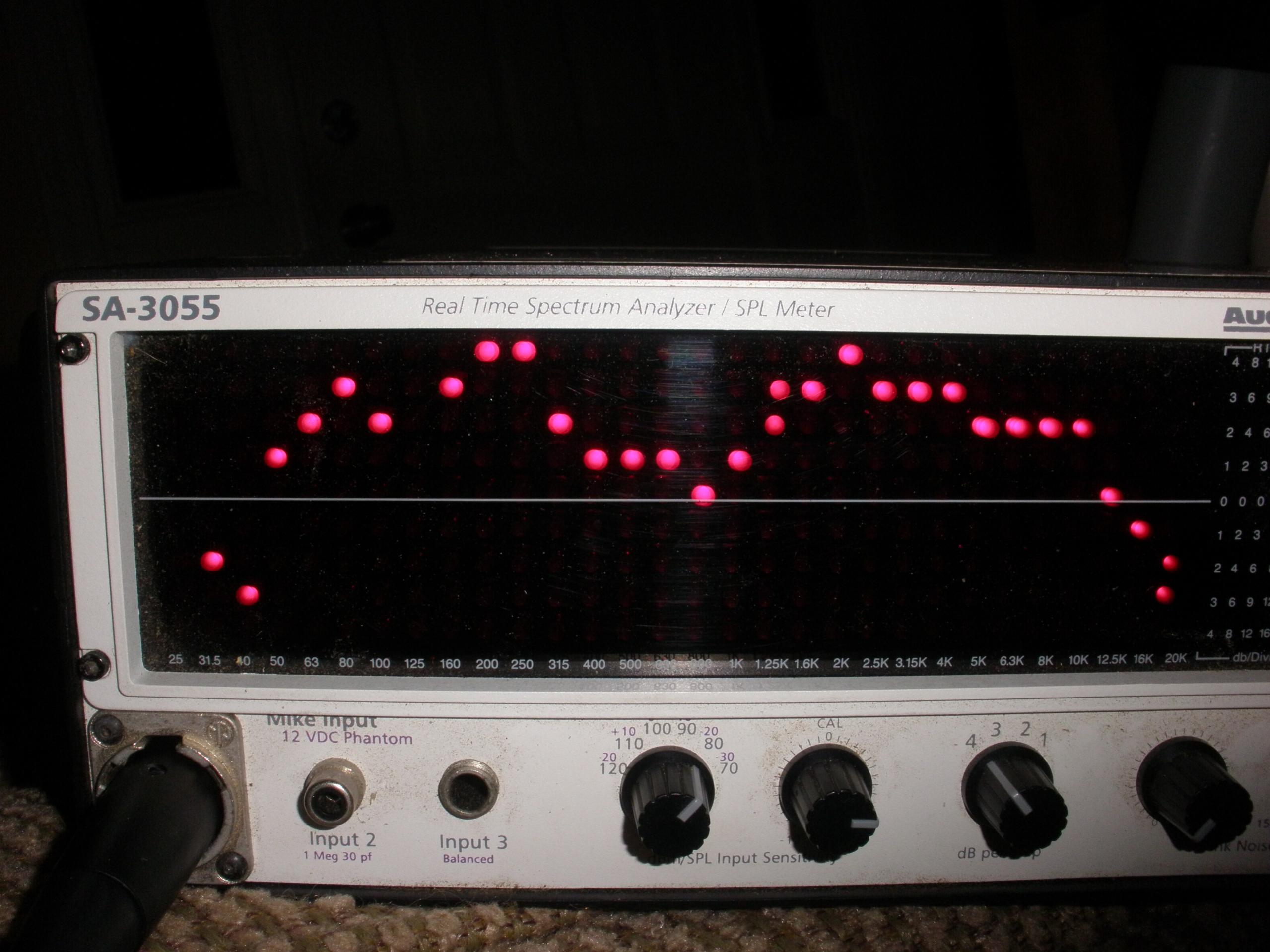

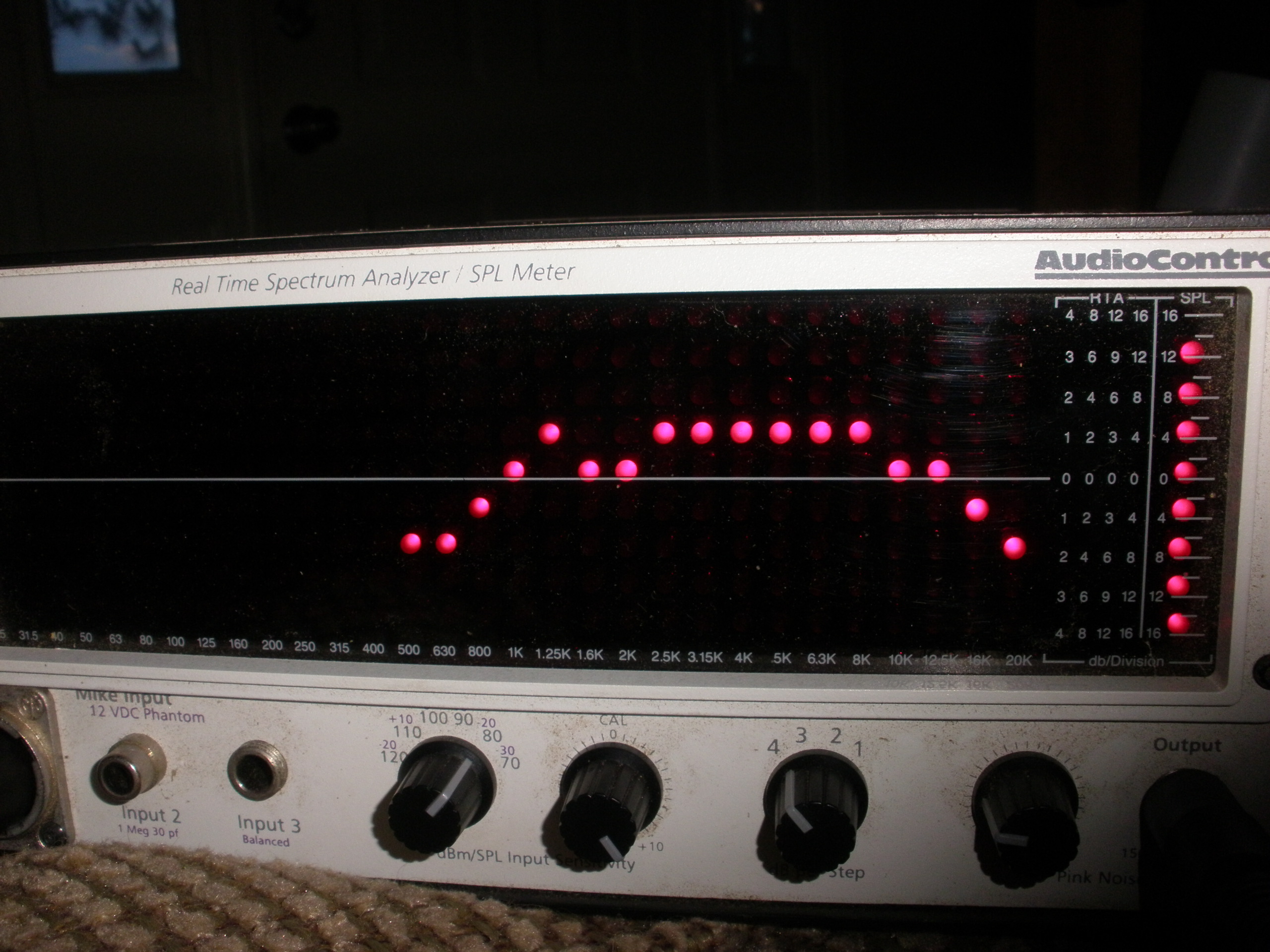

Rta coming
I have to leave the meter at work, but I have aquired the banna plug for the pink noise generator. It is the weekend and vacation for most, so some time Tuesday, i hope i can post the results.
>as requested, testing just the panels@ 9' or 130cm
>then, the tl, at same paremeter.
i believe this will still have a flat responce, no EQ, crossover flat, and some really old amps.
max power on these is roughly 130 watt/rms i will be no where near that and i do not have the equipment to post a stagnent output. my guess is 75.
> this be tested in stereo.
the funny thing is, i allready know what they sound like. As soon as the weekend passes, i will try and show the data. I wish i could have done this a long time ago. sounds stupid, but its the friends here that made it possable.

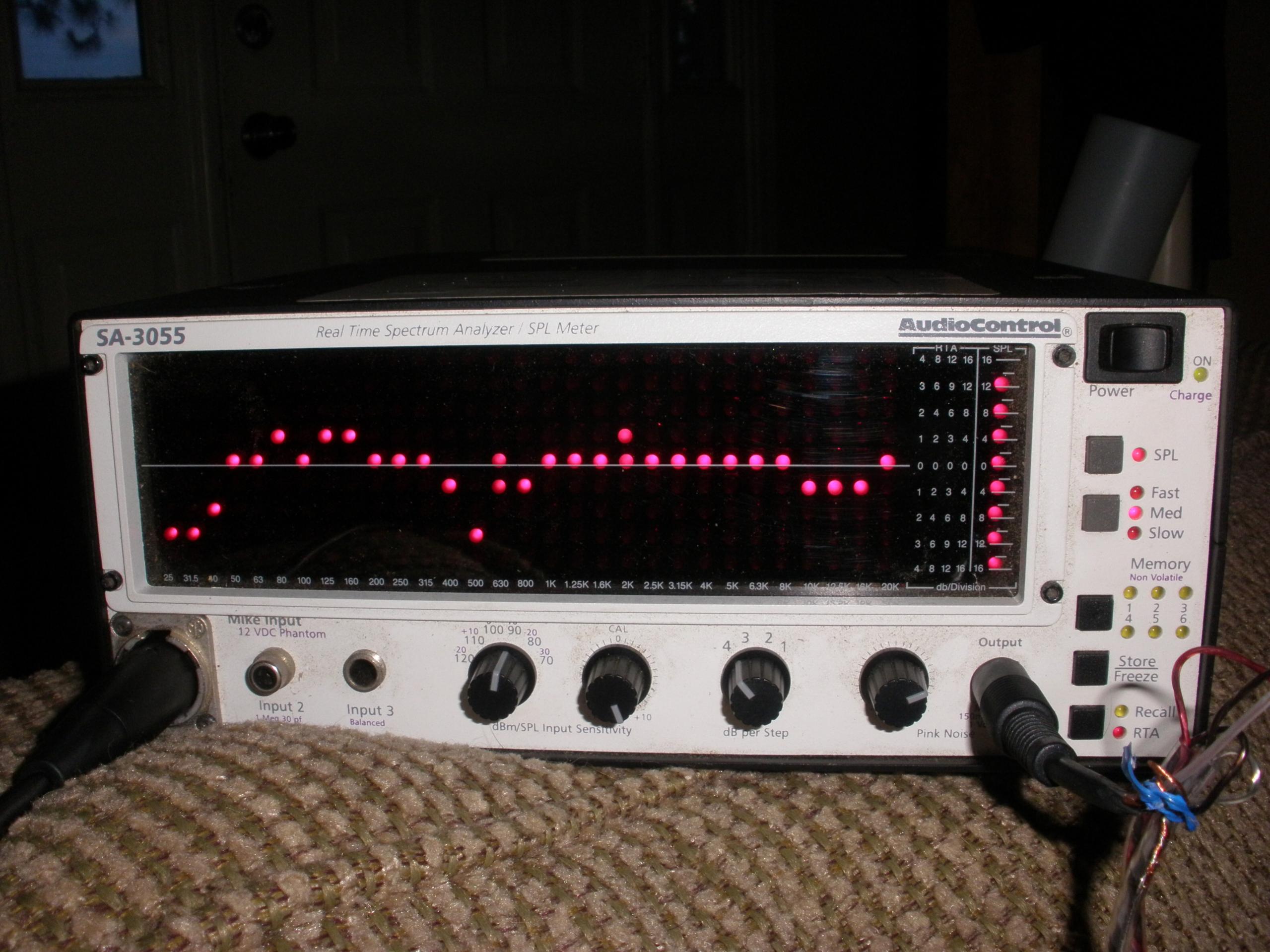

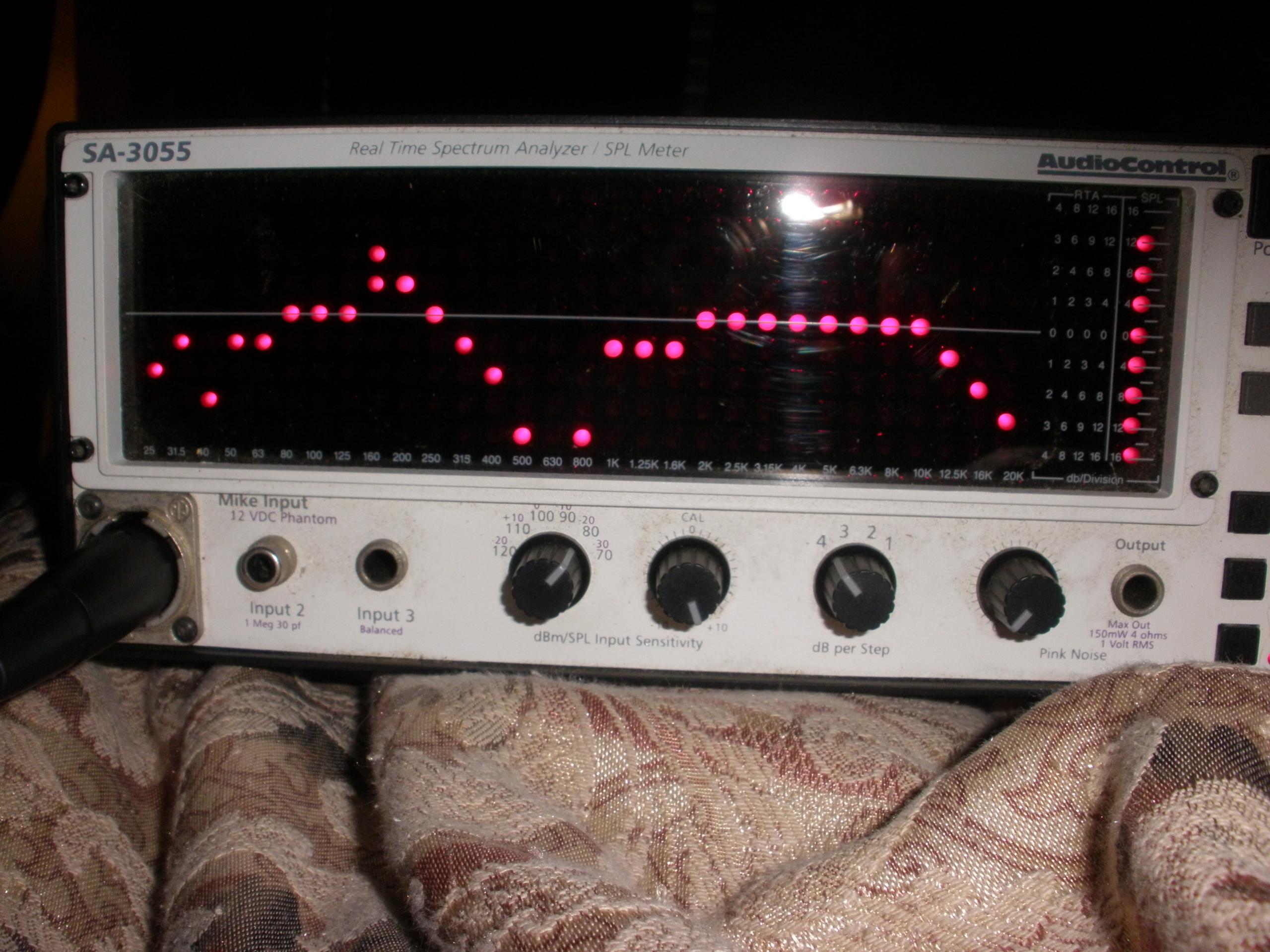

Rta pics as requested
Pic#62020472
> Just one esl panel @ 9feet or 130cm away at mid level or listening level, all the test will be the same except the last. I am using the pink nouse generator on the RTA meter, crossover is set a 500hz, 24 db slope, wattage is tough but i would think around 75 watts, maybe a little more, these amps are only rated @ 125 @ 4ohm. There was no TL, just the panel(1).
pic #62020473
>Just the TL, i think something is up or wrong with this sub as it is very very old, as well as my amps. I myself can hear something resonating, could be something in the house, dont know.
pic#62020474
> the other TL, a little differnt responce.
pic#62020476
> both esl's and tl's playing in stereo, rather mono, but using both speakers at the same diastance as first noted.
pic#62020477
> Same setup, only moved another four feet away, seems to be even flatter on the responce. This is simply amayzing. Has anyone else performed test at these distances here? I have looked but nothing, every test that i could find was relativly close to the speaker, mine see to go flatter the further you are.
I will have the meter for a few days, so please let us know your thoughts on the tests. Mav

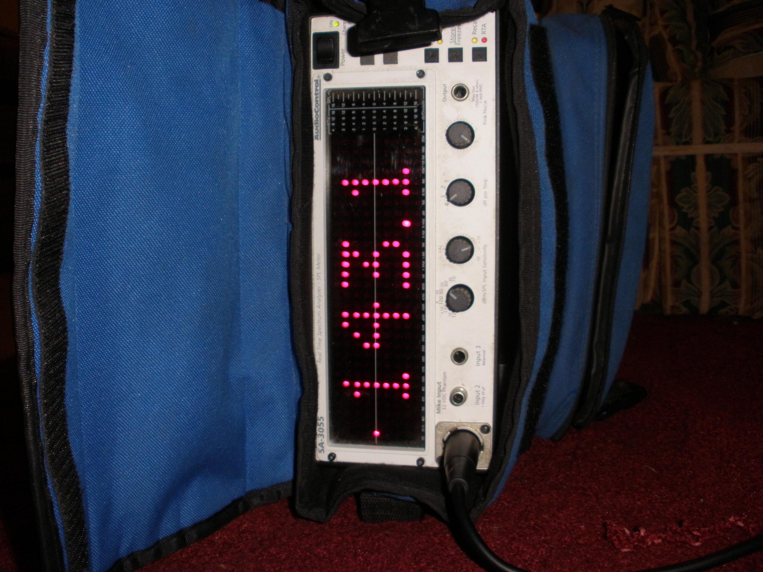

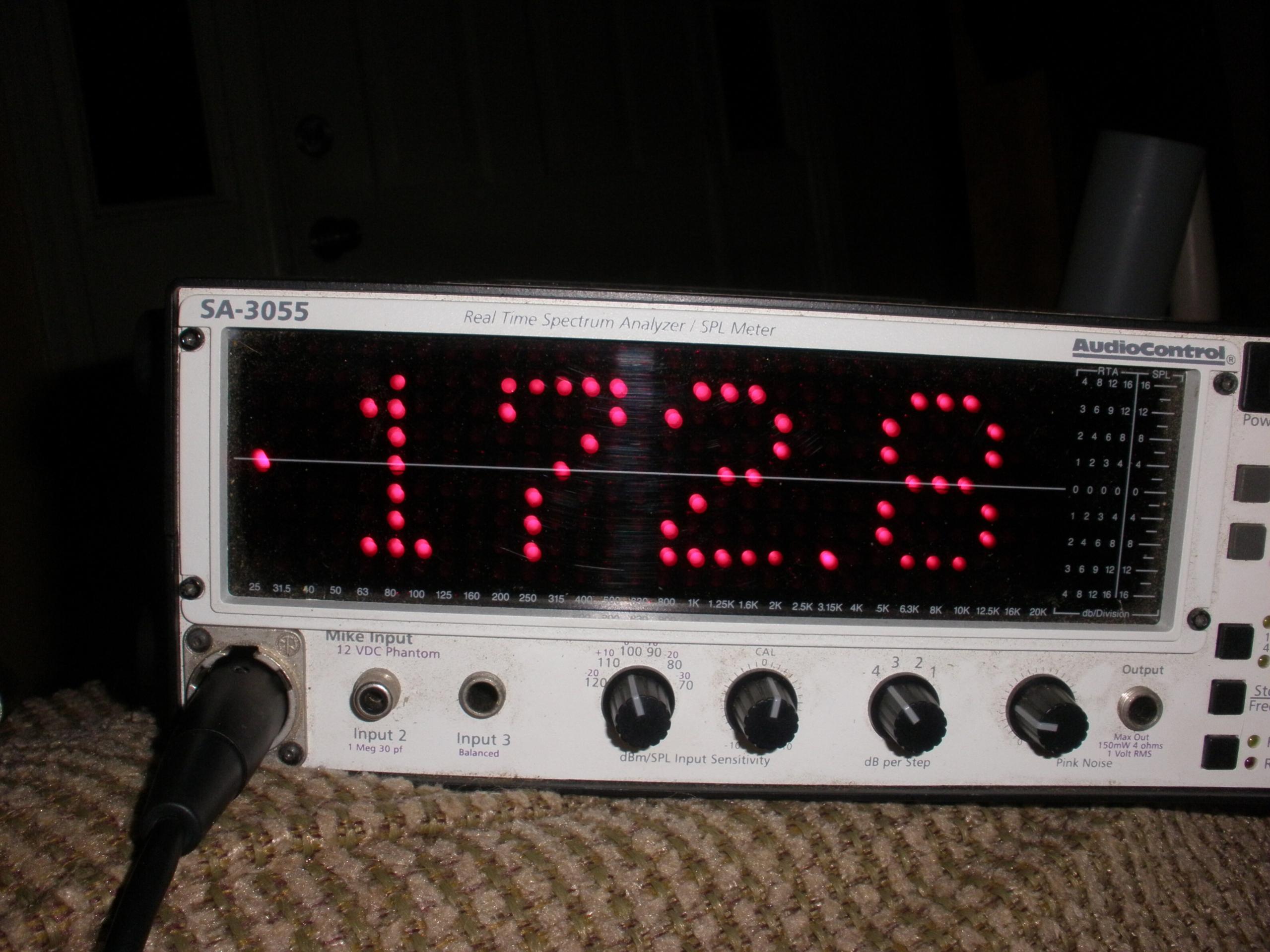

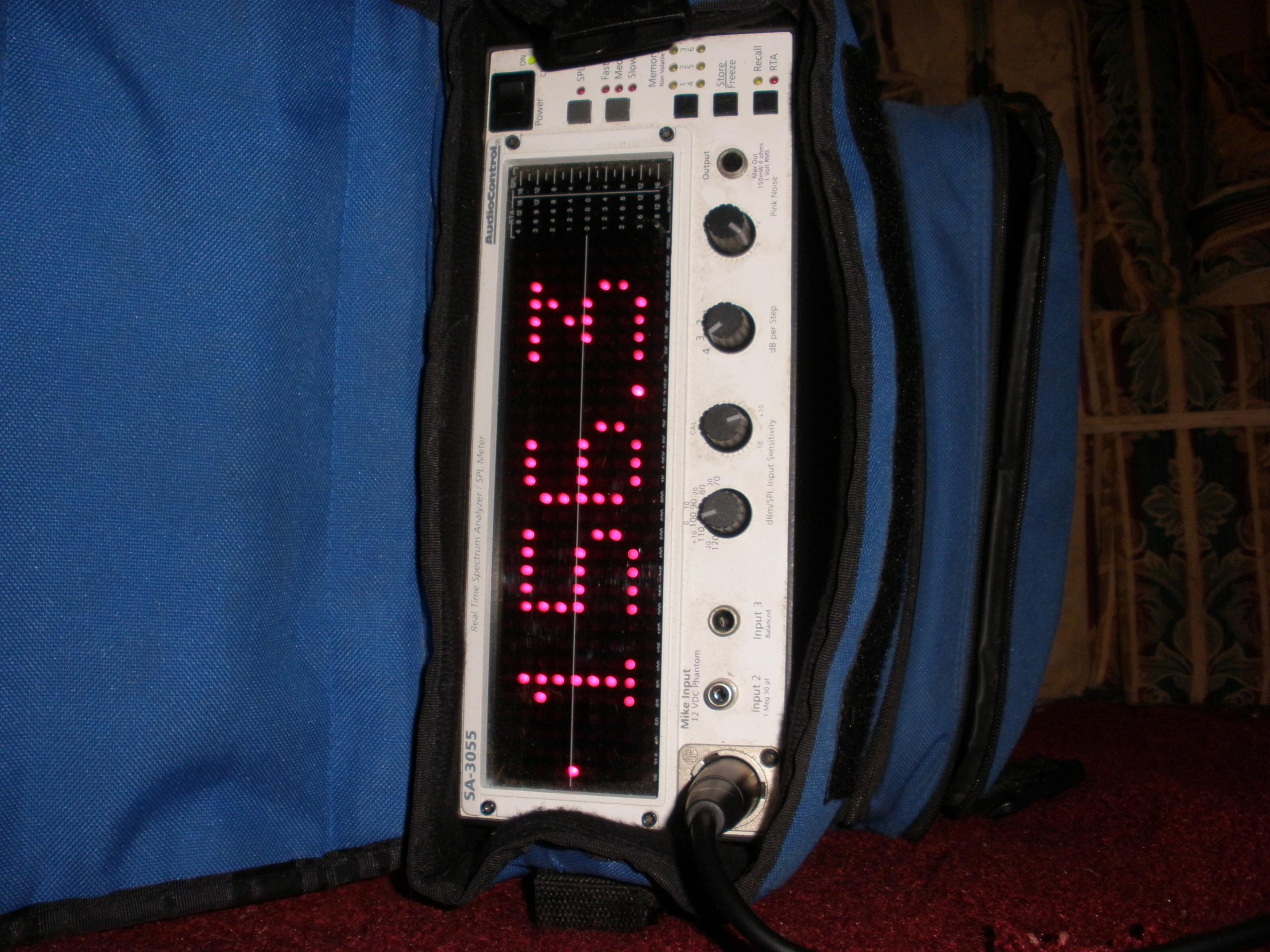

Spl @ 20'
This is beginning to mess with my neighbors, Check this out, and keep in mind the equipment. Even RTA shows pretty flat. And yes I had to change mics, things dont work like that on this meter, this is crazy loud, the music was White Zombie, had to irritate the wife a little.

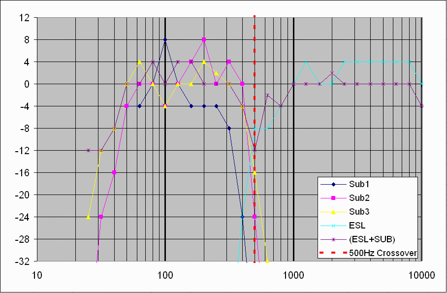

Hello mavric,
Usually when people are measuring close to the speakers (1m or so) they are trying to capture just the first arrival sounds from the speaker before all of the reflections of the room are added in. This tells them what the speaker is actually putting out. The measurement equipment has a way for them to select only the window in time that contains the first arrival sounds before all the reflections and echos start arriving at the mike.
Your RTA measurements are somewhat different in that they are time averaged taking in everything from the speaker and all the room reflections. This type of measurement is pretty good at letting you know what the spectral balance is, whether listenting to the speaker in that room will sound boomy, or bright, etc.
I threw your RTA measurments into XL so we could look at them overlayed all together. There appears to be a dip in the response at and above the 500Hz crossover point. You might try a couple things to get the ESL to integrate better with the woofer.
1) Try swapping the phase on the woofers to see if the outputs add together better at the crossover and fills in the dip a bit.
2) It looks to me like the ESL is not playing low enough to integerate properly with the woofer at 500Hz. For proper integration of 24dB crossovers the response for the woofer and the ESL should be -6dB at the 500Hz crossover point. The woofer is close, the ESL is not. If you have the ability to set the woofer and ESL crossover points independently, try moving the ESL crossover point down a bit to 350Hz - 400Hz while leaving the woofer set at 500Hz. Again, see if this change helps fills in the response dip at all.
3) Combination of 1) & 2)
I'm not sure why the RTA shows measured SPL of 172dB, but I'd say that is pretty unlikely.
I'd be surprised to see anything above 115-120dB.
I know when I used an Audio Control for measure SPL in a car you needed to have a particular matching microphone to get realistic SPL readings. I keep thinking there may also have been some internal dip switch setting that needed to be correctly set for what microphone you were using. It's been a while...
Hi Bolserst!,
thanks for the interest, it has been a while for me as well using this meter, there are two mics, on RTA other SPL, the spl mike has been used more than a dish rag at a military base, the rta on the other hand has hardly ever been touched.
un fortunatly, my cross over stops at 500hz, and i completly understand the over lay of the drop offs, there is no overlap and well, merging the the slope.
And yes, they are very bright. My only choice is a differnt crossover, but funds are limited. I learned about slopes a long time ago, so i understand, other wise i would raise the sub and lower the esl to flatten the gap.
other than that? what do you think? Just say i did have the gap overlayed, i think its still impressive using old equip and 18 year drivers and amps. I am not a professional here, so your repsonse would be appreciated. Mav
