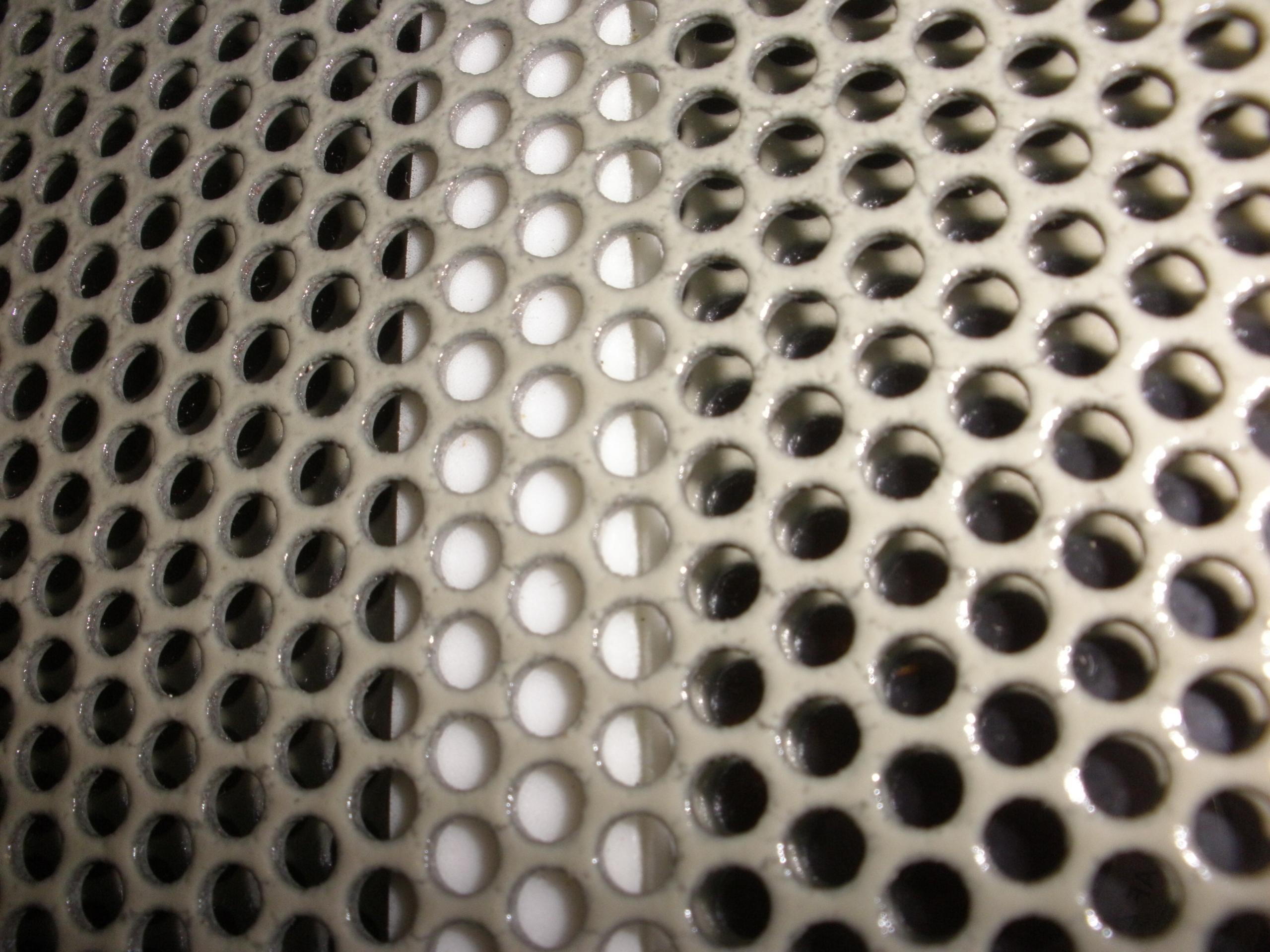

i took some pics, curious if the tape is not sticking to the stats very well, almost sound like something not compressed, running @ 500hz and above, nothing lower, you cannot hear it from a distance, but is pressant at the stat. If it is what i think, the tape not sticking to the staor well, any suggestions please, NO this is not full range yet,
>since the tape covers up the o/a , would it be wise to expoxy every six inch or so, as the stat paanel tend to bend away from each other. I have big ears and are wide open. they sound so well, perfect, you have to put your ear to it to find that sound, like the giaghpram is bouncing off the tape. here are some pics, i have my finger on the area and a larger photo.

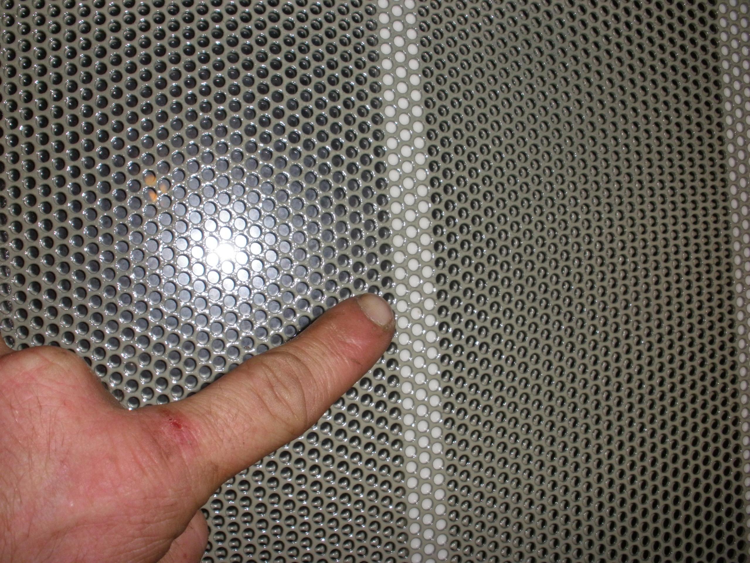

orange object?
I used my camera for the pics, noticed an orange spot , just tried with a 500 watt halogen and cannot see it, neither front or back.
if these arc, what would it look like? i hope thats not it, just a glitch.
zoom in on the pics above my finger, tell me what you think it is. I will try same area at different angle, almost looks like rust.
If anyone mind giving me a PM on email, I can send a high res pic. I will continue to look, maybe lighting here, please let me know your thoughts.
I feel like an idiot, that is from the wall of my home, the diagphram is transparent, blonde moment, please dont give me a hard time on this, rather have it deleted, but make fun if you want.

i took some pics, curious if the tape is not sticking to the stats very well.... i have my finger on the area and a larger photo.
It seems to me that if the tape were to let go, it would most likely remain stuck to the diaphragm and let go from the stator because the stator surface is 50% holes so has less surface area for the tape to grab onto.
Also, I think you would see a separation between the tape and stator or diaphragm if the tape had let go.
At the place you are pointing to in the photo, the tape looks to be in full contact with the stator. Have a close look along the tape support strips on both sides of the stator-- can you seeing any separations anywhere?
Also, try gently pressing the panels together along the tape line-- can you see or feel any gaps closing anywhere?
If you find no problems with the tape joints (and I don't think you will) then any buzzing you hear must be caused by something else. Are you hearing any buzzing that could be in the 60hz range?
i have a 500watt hallogen light, i will inspect them, to honest, i have been playing at full range, at very , very low volume, just lound eough to hear at 15' away, only voals and piano, like "Chopin" my wife like "Jewel". while playing, i cut all the lights off and inspected the panels to check for arching, nothing present, it will take some time to inspest tape front and back.

You can't hurt the panel playing music full range but you could saturate the trannys playing full range if you play it loud enough nd that would probably sound crappy-- would probably fry a cheap/low powered amp too.
Try turning everything off (music and amp off) except leave the bias power supply to the diaphragms powered up and see if you still hear any buzzing.
Thats the first thing i did. no buzzing, i did notice the tape, on 1/2 of the stator all the way down, from tpo to bottom.the other side has about 1-16" over hang, exposed, let me try a a pic.
you know the sound of tape coming off a surface? thats the best analogy, only present at the panel.

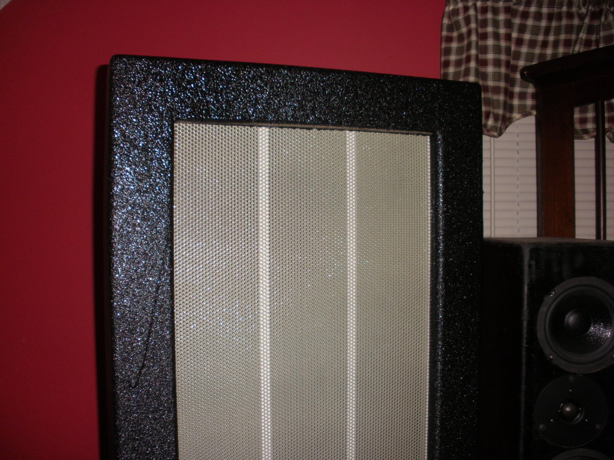

stat pics, with tape about 1/16 off, from alighnmment.
>no buzzing with no music
>>nothing period
>this is the best pic
> I will hang them up untill next weekend, in other words, not play them at all.
> use proper equipment setup, as i was supposed to do.
>they sound so good, so it is hard not to play, bummer.
>and why is there a Santa Clause pic on my right?

zoom in
try the zoom in function on the lower left of the pic.
> the tape is coming away from the stat, not the diagphram.
> can i use some kind of injection adheisive, such as epoxy? just in three holes at the most?
> they sound awesome, its a minor thing i noticed, they are new and i would imagine that the tape will conform to the stats and stick over time. the material to coat them was very shiny, and the size from left to right, i think the next ones will have a little more tape to hold them together.
>all ** aside, these are the best sounding, over engineered, and no corner cut set up i have ever heard.
>Ger, dont think i will use the q tip, just zoom in on the pic, like i said, not a big deal, just something to consider next time on a wide panel. Or suggestions on differnt tape as the stats are not powder coated. So many variables.

Mavric,
I can see from the photo that the tape lines on the front and back stators don’t exactly line up but I can’t say that I see a gap there. If there is a gap, you should feel it close and bottom out if you press the panels together along the tape line. Even if there is section where the tape let go from the stator, I would expect low output (but not buzzing) from that area. Did you try pressing the panels together along the tape line to verify if there is a gap there?
