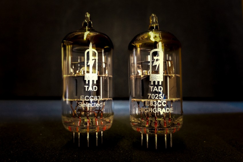

Asking how long a set of valves will last is the same as asking “How long does a set of car tyres last?”Behind the speakers, all dusty and cobwebbed, were two McIntosh tube amplifiers. Everything still worked fine. I got the impression that the amps had been there for quite a few years ..... perhaps since the original installation.
Answer:
- The rate at which tyres wear out depends on the way you drive and how often you drive.
- The rate at which valves wear out is determined by how hard (loud) they have been played and how many hours they have been on.
The valve amp I am currently using in my 'man shed' was purchased new by me in 1969 and is still operating effectively with its original set of Mullard and Brimar valves.Why aren't there tube amps on the market that last 10 to 20 years between re-tubing?
However, the amp has not been in continuous use for all of those 51 years, nor has it been continuously played at high volumes.
Guitar amps are a particularly harsh physical and electrical environment for valves, but this excellent article from Hughes & Kettner give a much rosier picture for the life-span of power valves that I did: When could, would and should you replace tubes? - Hughes & Kettner BLOG
The article suggests a life of 10,000 hours is not an unrealistic prospect and this represents a useful playing for fun and gigging life of around 33 years!
Military spec valves can last 100,000 hours i.e. 10 times longer than their civilian equivalents. The military equivalent of the ECC83 is the E83CC.
