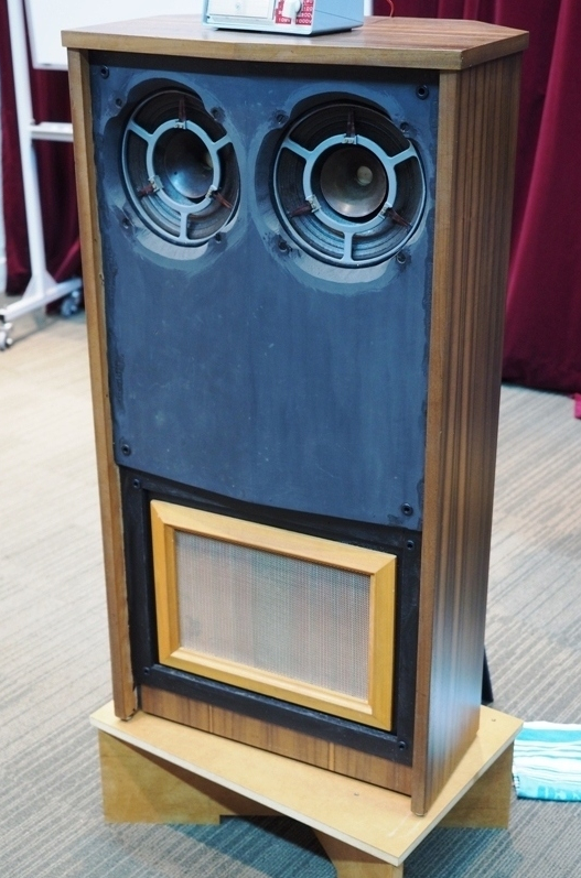

It could be an enclosure containing a Goodmans ARU (Acoustic Resistance Unit).Auxiliary Bass Radiator.
These were often situated on the rear of the enclosure, but would not flap around at resonance!
Are those drivers a Ted Jordan design? He used rear spiderless designs in his later EJ Jordan speakers. I have had several (I painted part of his house one year!) and the bass has been exceptional for drivers of that size.

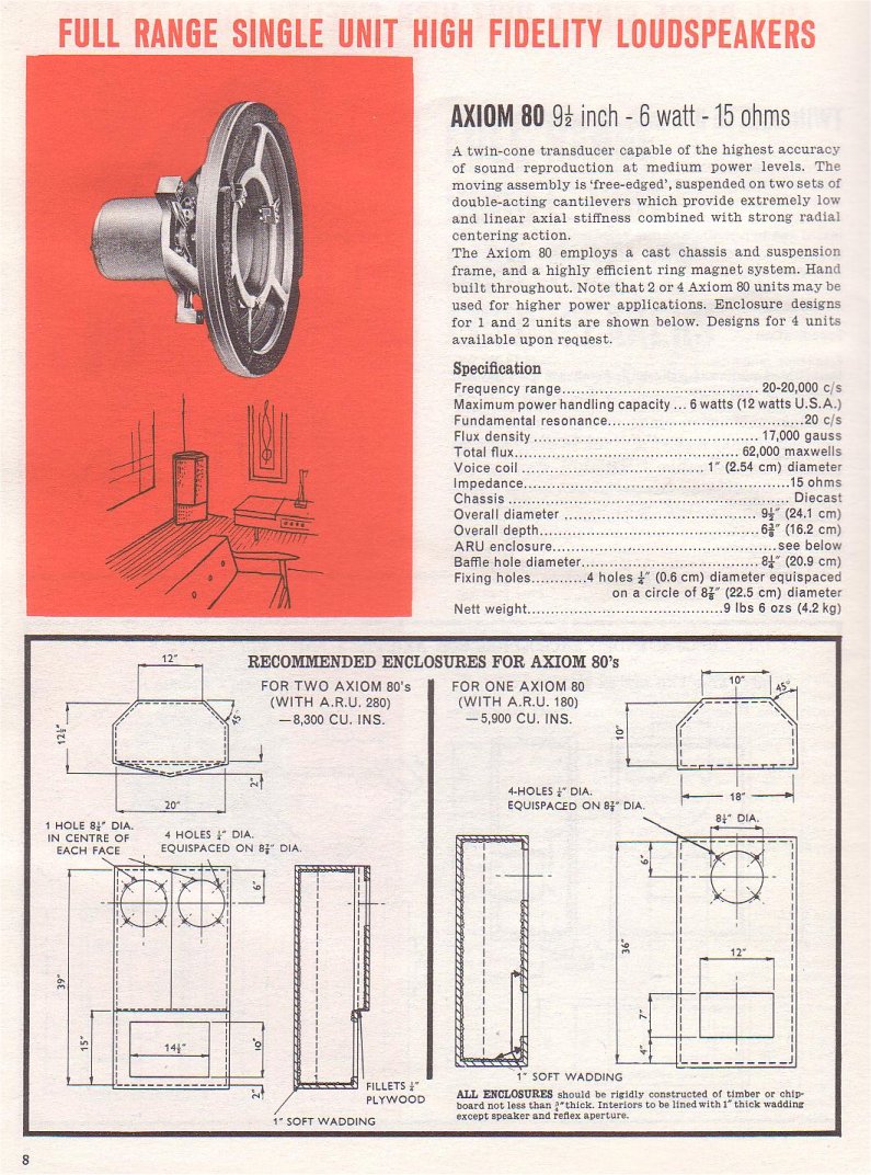

The Goodmans 1963-64 catalogue is an interesting read! Goodmans speaker catalogue, 1963-1964
