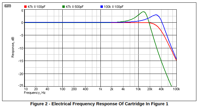

The MM cartridge is essentially a simple resistor, inductor, capacitor (RLC) filter which has a resonant frequency.
As the value of inductance increases, the resonant frequency falls, which would account for why the M55E has less pronounced higher octaves.
With a higher inductance, the electrical resonance will occur at a lower frequency and the response will fall off sharply above that frequency.

It's tonally down to the interaction between cartridge inductance,usually 500mH, cable and preamp input capacitance (100-400pF) and the resistive preamp load which is usually 47k.
https://sound-au.com/articles/cartridge-loading.html
My experience is the lower the capacitance, the better it sounds. This, I think, is because the electrical resonance affects the mechanical properties of the stylus in the groove at the very highest frequencies.
A sort of mistracking.
If you add a couple of 1k metal oxide resistors in the cartridge headshell on the hot output's solder tags the sound is transformed much smoother, at the loss of a bit of HF and additional noise.
