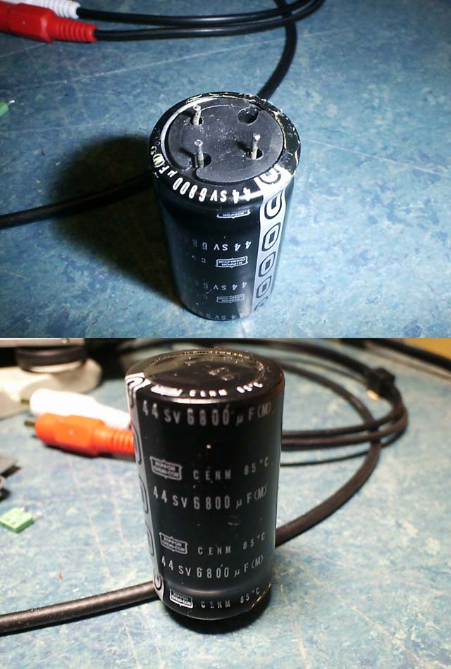

I've juste got two caps out of an older amp, and they to have 3 pins! It seems that ground is common, and it charges on both the other pins, but there isn't really a way of checking that it charges correctly, is there??
Isn't marked in any special way, just says 44V 6800 microF
/Chris
Alright Taz! Where are the pictures of the Zen V4 on your website? Just to add to this thread I have found some 3 pin "computer grade" caps. The third pin is definately just for mechanical integrity. It should have no electrical connection. If it were a two section cap it would be MUCH larger.
