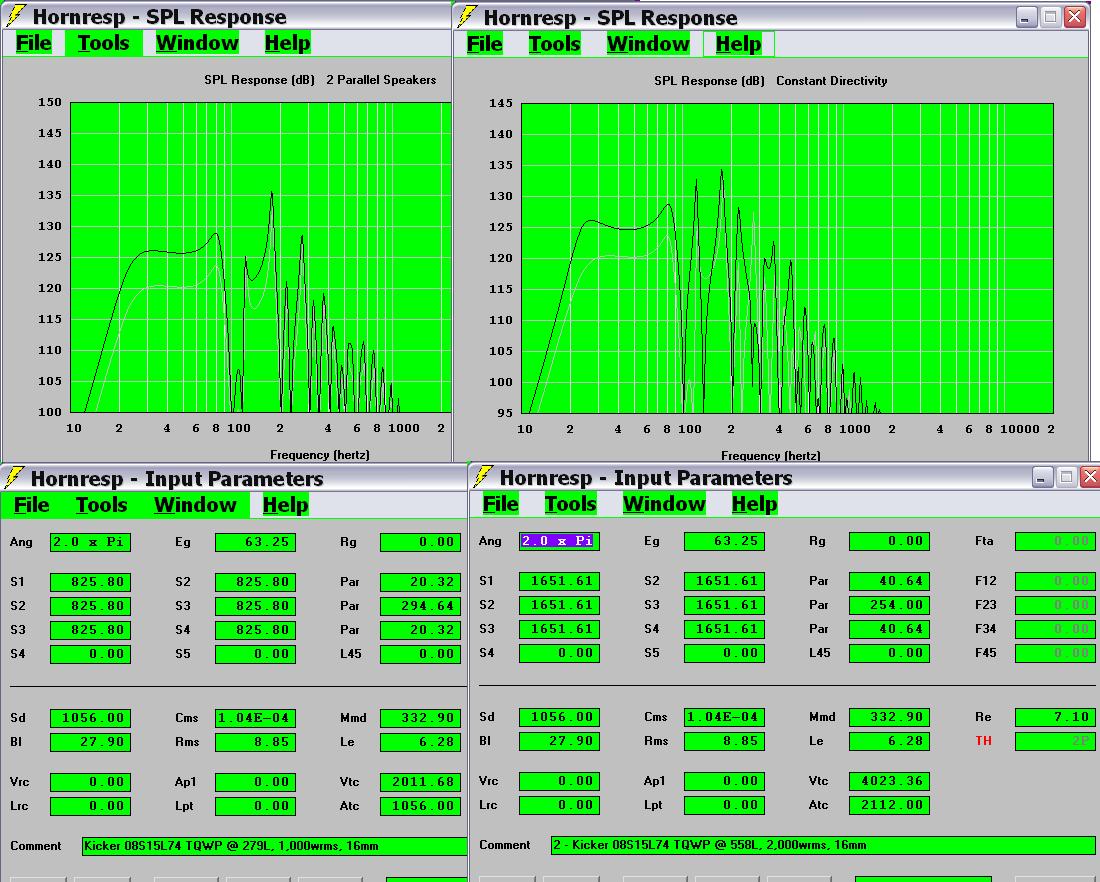

I still got +6db at 20hz and +3db around 175-178hz. You also have to adjust L12, L23, & L34 to get the same length horn.

Hi just a guy,
Yes you are right, I was mistaken the volume differences. But that still doesn't change anything.
In my opinion it doesn't change anything, there still isn't anything wrong with Hornresp. Somehow I think when you say "it doesn't change anything" you think there is something wrong with Hornresp. Still. I'm not sure if it's Hornresp or mutual coupling that you don't understand at this point. But I also don't think you are willing to change your mind about anything. So I don't think anything I have to say is going to do any good.

Hi Bp1Fanatic,
Thanks for your input. Besides the input differences (which causes the difference between your responses) you have clearly a point.
There is now a +6dB difference (see picture below). It now shows a +6dB gain because there is no longer a drop of the roll-off in frequency, meaning, no 'trade' in frequency extension at cost of efficiency. I am not sure but I suppose that is the result of chamber that functions like a transformer between driver and pipe. Probably David can explain better why there is no longer a drop of the roll-off in frequency.

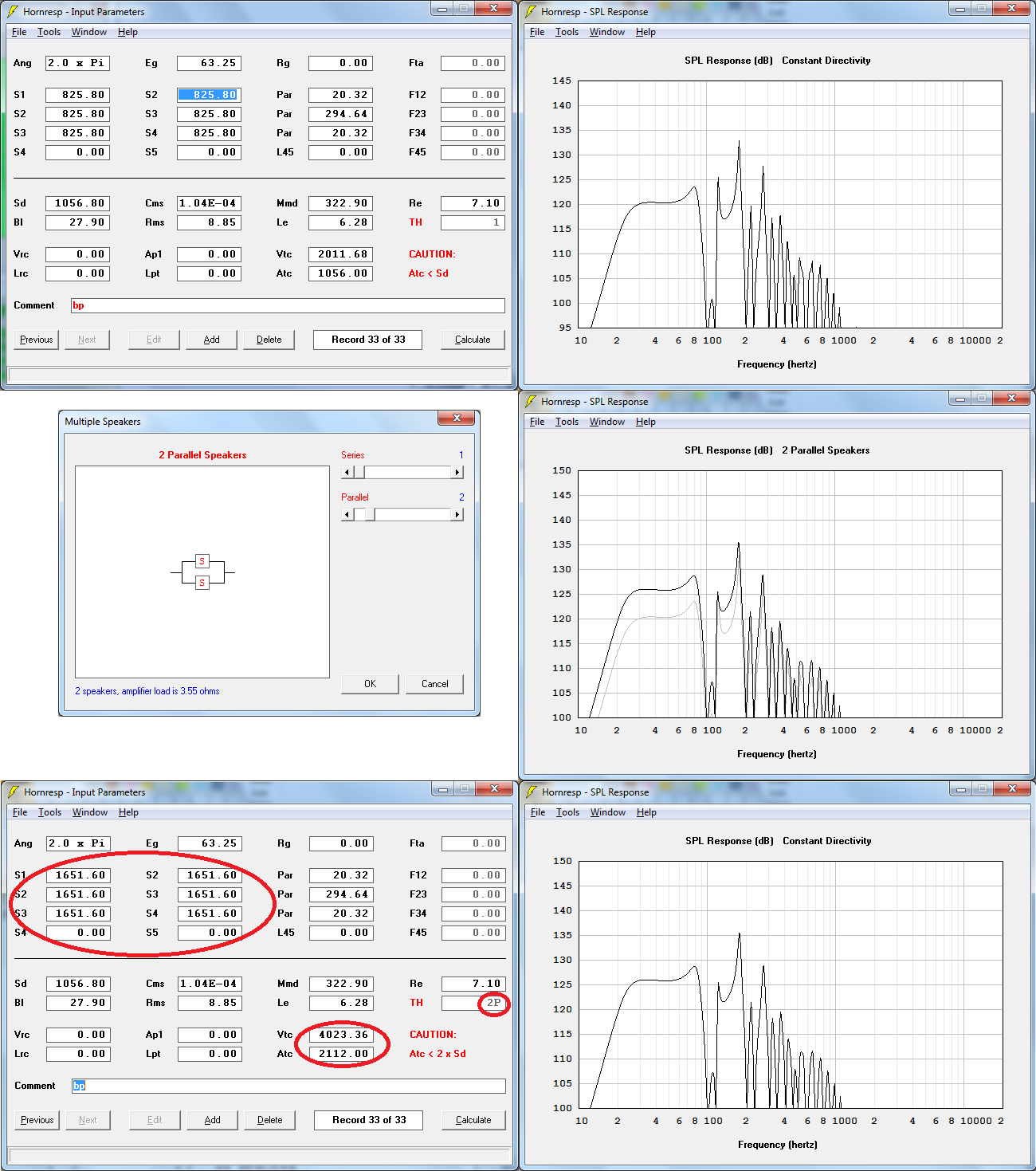

I'm going to try this one more time with pictures and then I'm done with this nonsense.
The first two pics (the two in the top row) show Hornresp inputs for a single tapped horn and the power response prediction for those inputs.
The first pic in the second row shows how to use the multiple speakers feature. The second pic in the second row shows the multiple speakers feature sim (bold line) vs the single cab as shown directly above (grey line). Clearly there's 6 db difference between the two on the low end. The response curve shape between the dark line and the grey line is slightly different, because that's what happens when you double the mouth size. If you don't understand why the response curve shape changes when the mouth size changes you don't understand how horns work.
The first pic in the third row shows how to input the changes to double up the cabs without using the multiple speakers feature. Everything with a red circle around it is doubled, everything that is not circled in red is left alone. The second pic in the third row shows the response that this generates. The second pic also shows a comparison between this response and the multiple speakers feature directly above. You can't see the grey line because they overlay perfectly.
So to recap (since I'm not going to explain this again) the multiple speakers feature produces EXACTLY the same result as the regular mode.
Both of these methods for specifying multiple speakers (multiple speakers feature vs multiplying the drivers, chambers and segment csa's) produce 6 db more than a single cab at low frequencies, and less as frequency rises.
There is nothing wrong with Hornresp if you use it properly.

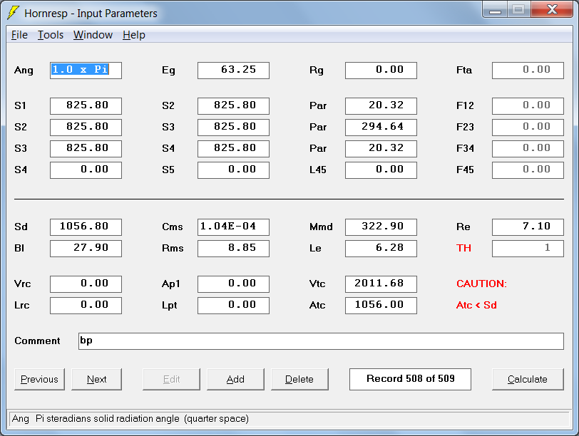

I still don't know exactly what you were simulating but to cut to the chase I did my own version of your simulation. I assumed your first input screen (the bottom left input screen) was the single cab being simulated. Based on that:
The first pic in the top row is the inputs for a single cab. (Same as your inputs.) The second pic in the top row is the power response of the single cab.
The first pic in the second row shows I used the multiple speakers tool to generate the second pic in the second row; the spl response for two cabs. This second pic also shows a comparison to a single cab - this grey line is the same response as the second pic in the top row.
The first pic in the third row shows the correct way to simulate two cabs without using the multiple speakers tool. The input boxes circled in red are all doubled, all the others are left alone. There is no other correct way to do this. The second pic in this row shows the response that these inputs generate. Also shown is a comparison to the double cab sim done with the multiple speakers tool. You can't see the grey line because the results overlay perfectly.
