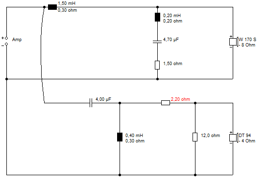

thanks Steve, I'm going with the last schematic you drew and the values you selected. Let me check out what's available over here and if there is a question, I'll get back to you tonight. Thanks for the effort and time. I am getting the hurry-up and get this off the living room floor and put it together look for W/A..... In looking at the woofer the 3.3 resister stays correct?, and how much can I vary the microfarads in the tweeter if the stores don't have the exact value? Steve I am reading something I am not sure of so I'll ask a nubbie question. I have a 1.5mh 20 AGW P core inductor, but what is the .30 ohm reading? thanks again...
Honestly, Danny, the component values aren't all that critical. Get within 10% on capacitance and you are doing alright, even 30% on coil resistance. 😀
I do notice that Dissi has disrupted the thread and then run away giggling like most of the others, so perhaps we should discount his feeble "contribution". 🙄
But for all that, I do now slightly favour my own below circuit as being better and more adaptable with resistance adjustments, even if the impedance slightly sucks. 🙂

You lose the 12 ohm resistor next. After that you increase the bafflestep coil to 2.2mH which lowers the midrange another 2dB.
Losing the 2.2 ohm series resistor on the tweeter takes the HF impedance too low, IMO, so not an option.
After that, well, it's time to try a more efficient tweeter...😡

Your tweeter is about 3 dB louder than the woofer. If you are willing to accept an impedance of 4 ohm in the upper frequency range, there shouldn't be a need to buy a more efficient tweeter. The major problem of your driver combination is the crossover frequency. The tweeter doesn't allow to go lower than 3 kHz, and the woofer is difficult to handle above 2 kHz. Both drivers require a notch filter, no way to succeed with a simple crossover.

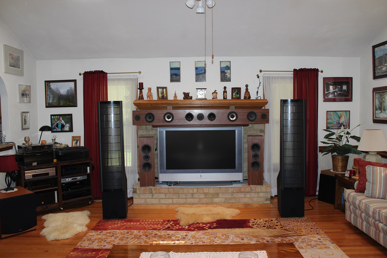

finished speker
thanks to all that helped from all sites; here is the finished speaker which will replace the mantel and will be the center channel for one of my main systems, and also the system for my computer aided by an integrated amp with equalizer. I won't go into all the individual speakers as most of us recognize them or can read the posts in this thread. The crossover turned out to be a combination of many of the examples used from this site and others, and the vent also adjusted on the back. The Paradigm and JBL subs were not pictured and neither were the Martin Logan Ascents as I did not build them (bummer, having trouble with image)

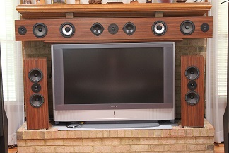

ABOVE: the two l/r vertical speakers used Vifa tweeters and Aura 6" woofers to be used with my t.v. The horizontal 9 unit speaker is my center channel with a 2way l/r computer system built with Focal woofer and Vifa tweeter; the center channel uses a HiVi tweeter with Peerless mid (M&K) and Madisound woofers. The mantel above the center speaker will be removed and this 7" long, 100lb speaker replacing it. The old Sony will go into one of the bedrooms and a 65" plasma (Pan or Sam or Sony 4K) will be placed on top; while a new fireplace goes underneath.... like a mans castle should be ! thanks everyone...all the best to you and yours

Flippin' eck! Your wife must be a treasure to put up with that lot! 😀
I guess the Focal/XT19's are left and right ends on the mantlepiece speaker thingie....😕
Love the split 3-way beach picture up top, BTW. Thought I'd invented that...:snoopy:
