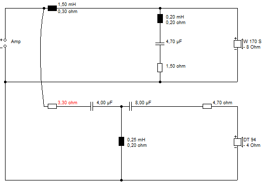

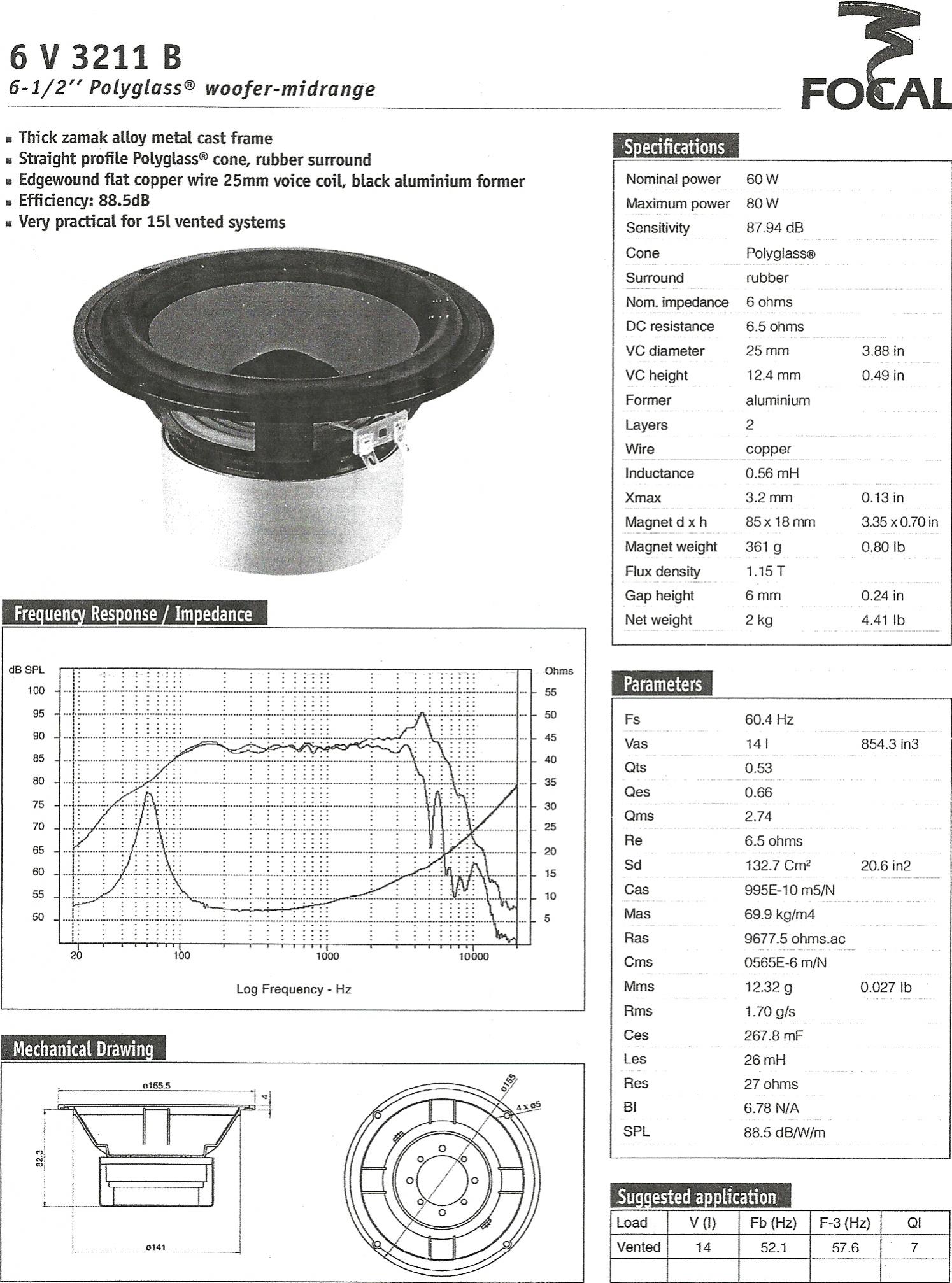

Ah, NOW we're cooking with gas, Danny! 😀
That's your typical 6" driver with a peak around 4.5 to 5kHz! We can do this. It's a bit like the Reed cone SEAS ER18RNX.
Simple bafflestep and a notch in Dynaudio style. I've pretty much nicked Troels' XT25 circuit:
Peerless HDS PPB 830860
That 3.3R input resistor is your tweeter level adjust, and it can be anything you like and impedance stays good. I'd start with closed box and fit a reflex tube later if you want. But it all works rather well. I have, of course, made some allowance for the flattish FR and lower efficiency of the XT19 in the Boxsim modelling. It has to be third order tweeter because of the non-ferrofluid nature of the XT19.
It's a 3kHz crossover and coil resistance is not critical, but you'd use aircoil on the tweeter and notch for sure. Ferrite core or good aircore on bafflestep. 250V polypropylene caps and 5-10W wirewound resistors.

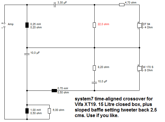

Let's talk sloped baffles and time alignment. Here's what it looks like:
And below a suitable crossover I hope. Based on some guesswork born of experience, but should be sweet. Frankly, I'm a bit like Beethoven, I just need to read the score to hear the whole thing in my head. You can't teach that in school. 😎

Guess i wasent all that far off the green after all then, the above mentioned XPL200A`s sports stepped baffles, placing the tweets and mids about 1" behind the low mid and the woofer. 😉

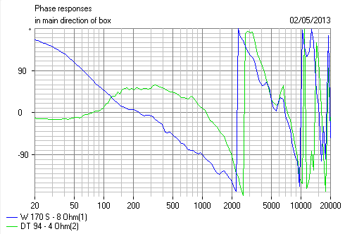

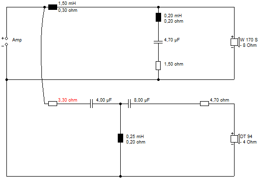

Here's the modelling that lead to the flat baffle crossover, Danny. Pretty typical 3rd order tweeter phase, it always goes a bit wrong below 2kHz, just how it works. I'm expecting the Vifa XT19 to be a lot quieter at the top than the mylar DT94 so it should all work.
Nice impedance IMO, about the best I've got with 3rd order. These 3 ohm DC Vifa tweeters always need 3.3 or 4.7R series resistance to get well-behaved.

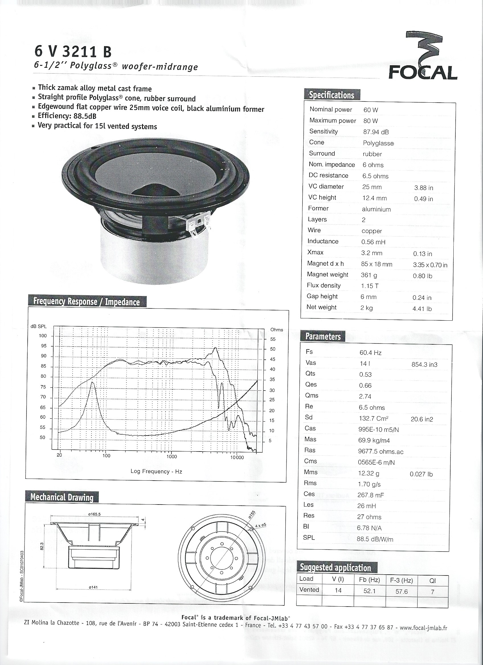

Unfortunately the appropriate resistor to match the tweeter level with the Focal woofer is only 2 ohm or less.
