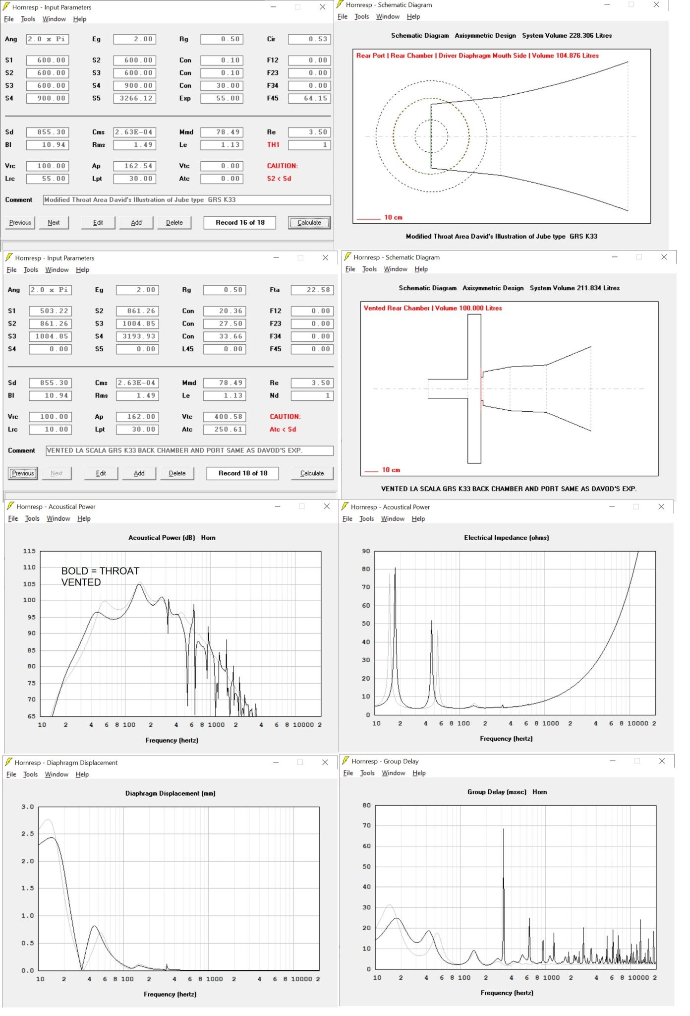

FWIW - Here's a comparison of a vented La Scala vs David McBean's throat vented La Scala.
I set La Scala's back chamber, port area and port length the same as what's in David's model.
One could probably figit with LS's tuning to make it overlay the other case.
No cigar for either. Throat venting could have an aesthetic advantage.

I have not done any simulations for the Jubilee cabinet, and do not have the TS parameters for the Klipsch 12".hey Art - what do you get for the 2-12 Jubilee hornresp input? - wonder ~T-S for the 12? - I'd like to see the sim.
The rear chamber volume and port length/area determine Fb (box tuning).oh another question - If I took TB46's "Karlflex" which should tune ~41Hz and gave it a less kongested aprerture, do you think it might then tune 45-48?
Changing the aperture should not change Fb.
The Karlson front chamber/aperture adds some air mass to the driver, making it's opening larger as you depict should reduce it's air mass loading, raising the driver's virtual Fs from the more "kongested" aperture.
The standard Karlson progressively narrowing vertical slot increases diffraction (and resonances), widening dispersion.
