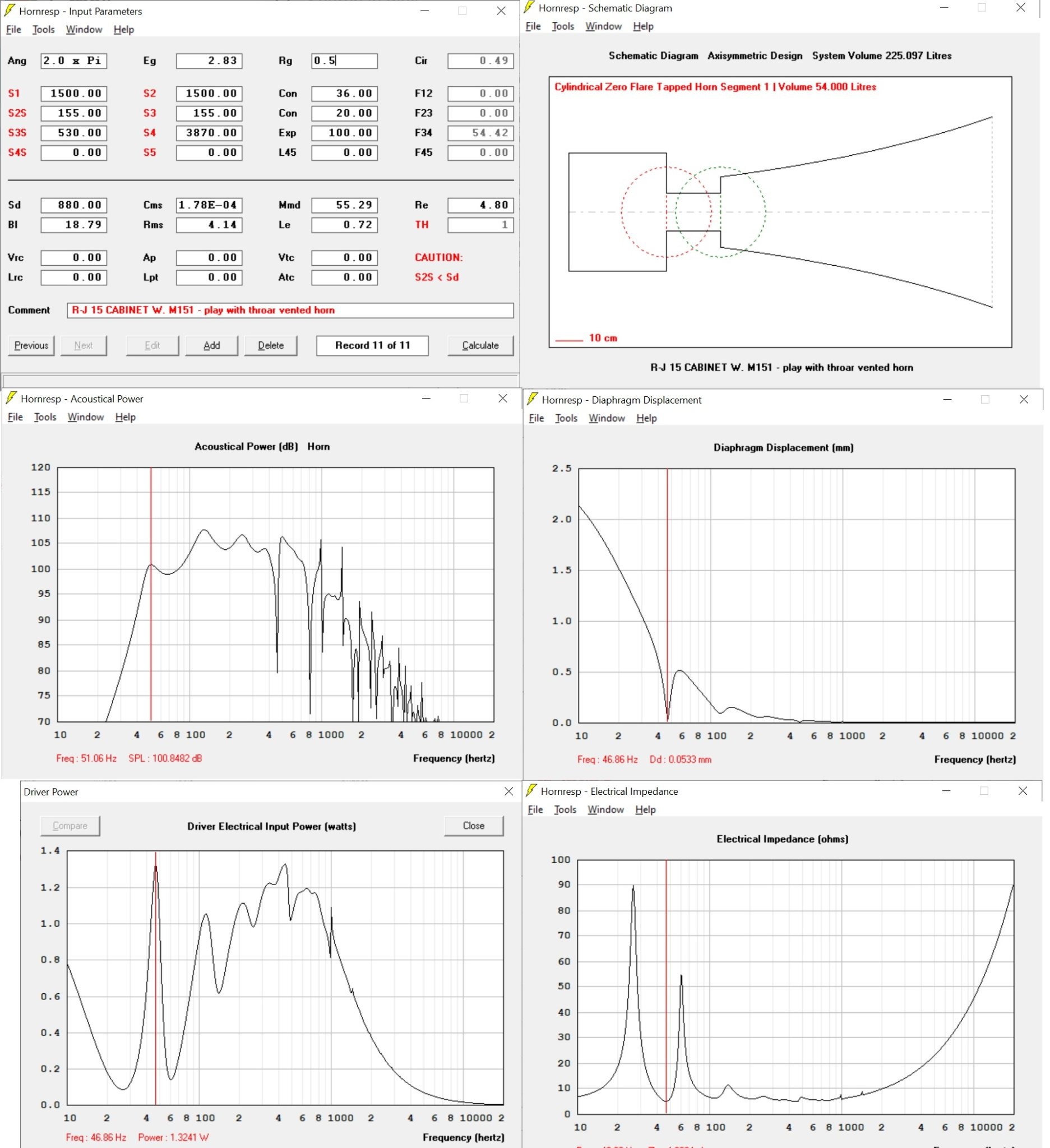

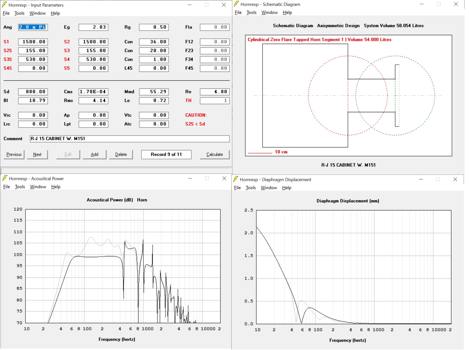

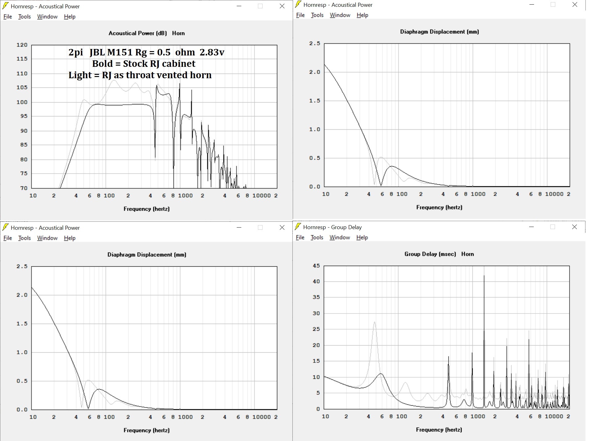

I have a question = does the following model using an "R-J" show one way (perhaps very limited) of modeling a throat vented horn? Does it look legit?

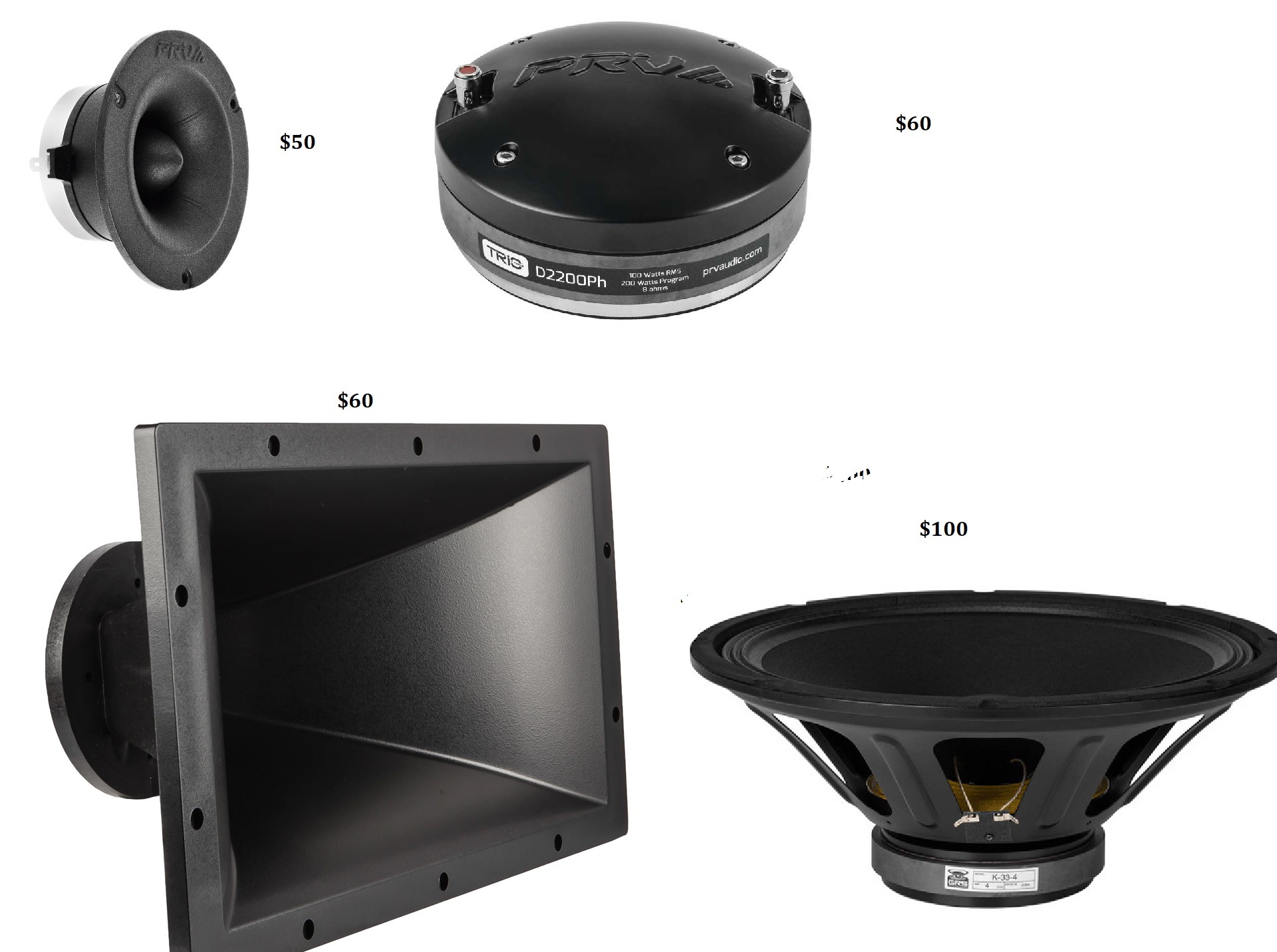

Someone good with hornresp and a table saw should be able to make either a throat ported or external to world ported horn with PRV's rectangular horn and $60 driver plus their $50 round tweeter for less than 1K a pair and get some decent sound down to 30Hz - maybe 20 if they think about it before making a plan.

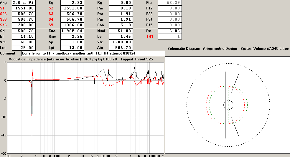

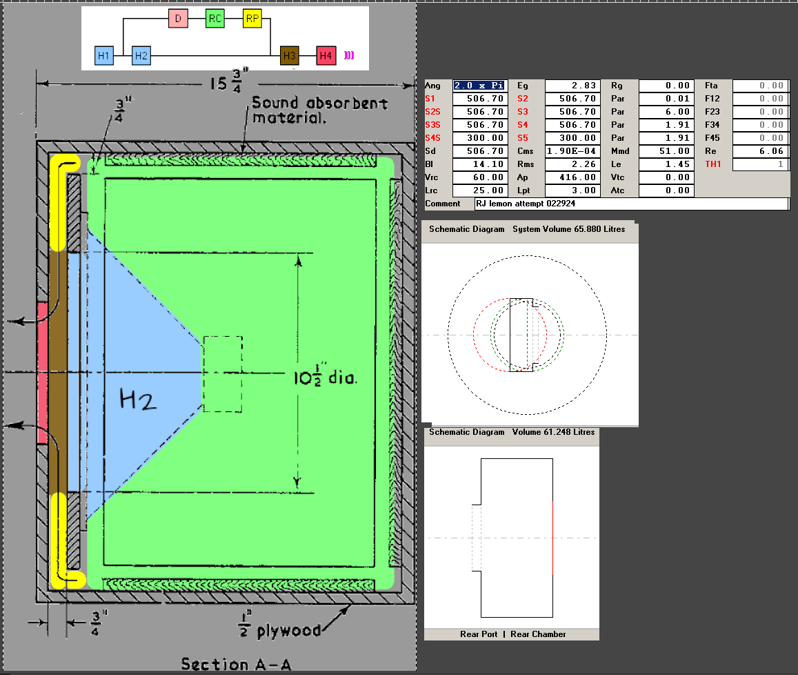

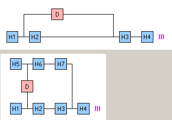

OK, perhaps this is more intelligible (first try at lemon). H1 gets thrown away (in Jube or here), but, unlike the Jube with big throat St > Sd, the TH1 runs out of sections before you can tack-on a horn. If the actual throat chamber disappears, then it can be like David's Jube model and the TH1 works as long as we throw away at least H1, and maybe H1 & H2. I think 🙂

OK then your method wins -- mine is ghastly but it's also untethered to actual lemon geometry (swagged '55 BBC report dims--lots of RJ geometries over the years). Could (should?) arguably use the TC fields in HR model, too, then H2 becomes just the little 1.91 long stepped piece in front of the cone region. Maybe (?) captures another resonance...too late for that kind of thinking, here.

mine might win for making R-J vented box speakers - but can it work for throat vented horn? there's a leftover section which can be used - - but....
I do think the DIY-er with understanding and perhaps $1000 to spend on a pair of horns coud come up with something pleasing and at least competitive with some Klipsch products. IF thre's an inexpesnsive and quite EQ solution. (Abrowser parametric EQ extension could work for Youtube)

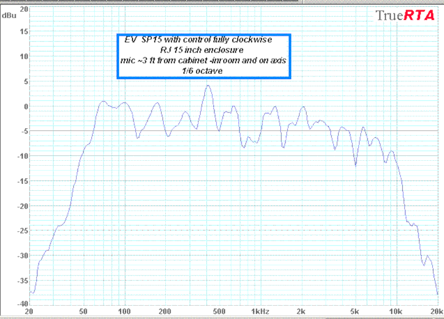

My hunch is that expectations are spoiled by what an SP15 did out of the RJ. I think it's the same old problem of a midhorn and 15 needing to meet where both aren't horrible (if present at all). IMO, this is where Wayne has it figured-out--use an economical coner down to a shallow 2-300-ish and let a short-path bass bin (pointed backwards into a corner, loc within 1/4WL & also shallow on top) and the coner midhorn muck-up each other in the modal stuff. Roy solves it with kilobuck horn and kilobuck driver plus electronics--so there goes cheap 🙂 I think if a throat-ported stubby ducted thing makes any sense, it needs to not play high...and might as well be closer to the stubby-ducted EV corner stuff after PWK's permission disappeared (Pat700/800, Geo400, etc). If the bin can stay small, then the extra damping (load) of the RJ-type stuff might make sense. If you look at those BBC tests of the RJ's, they're worse the K's--they get the "W" plus two deep notches. I think they're only usable below the "W". Your SP15 curve is infinitely better. Look--I love phenolic mids as much as anybody, but it's a bugger getting 200 or 300 outta anything economically accessible these years (formerly "racetrack horns")--and it's not a very nice 300 (and you need more than one). OTOH, you're rolling so I say keep going--a man must obey the muse 🙂 Dig-up those BBC RJ reports if you don't already have them and take a look or PM me and I can send them.
maybe Wayne / "Pi" had a pretty good compromise overall - at least not terribly difficult to build. A peav ey FH1 sitting on a 2 cubic foot ported bass is a way to have a hybrid horn - it pretty smooth and woul d meet the cheap PRV driver/18x10 horn well enough.

FWIW I think the extended RJ model might be good enough to make some rough estimates - I'll compare it to a parallel vented case with same driver, tuning and vent area..

Agreed that it's usable and again good work. And the way you're working, nothing but rear-chamber content needs to turn any corners, so you could try to play high enough to meet the phenolic midhorn--AND stay economical. I can't guess where the slot starts lowpassing from the inertance.
If I keep playing with my other approach, the port has to be very restrictive (too-much IMO) to get everything to behave and stick a little snorkel on there for better coupling. Might as well just overdamp a little reflex box with a tiny vent and save a few resonances, etc. I'll keep poking at it as thoughts and time allow, hopefully you can do the same.

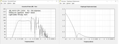

I had the slot set around the size of a 12" speaker's cone area - can be set up - down

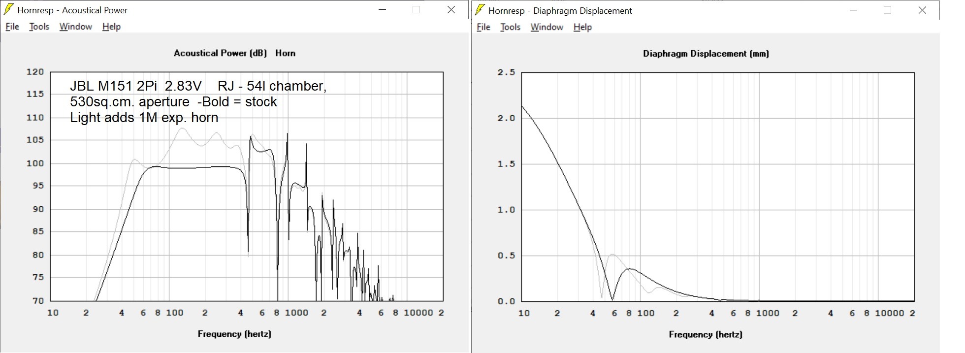

Here's the effect of a pretty large horn stuck in front of a ~stock RJ
It appears to mass load the port and shove tuning lower - but excursion seem to be up
around 60Hz. - The horn does kick in above 100Hz.
