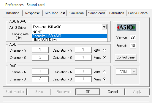

I will download the file on another PC which only has standard Win anti virus software. I have used ARTA software but I like that Diana can show the phase between fundamental and distortions signal. Something they discuss a lot in the Pass Lab forum 🙂
Once you have your ASIO set, you can pick any soundcard you have.
